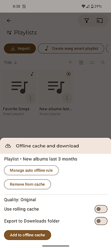

Well yes, I probably mis-read a lot of comments, and when I was searching for solutions I imagine mostly comments with my same frustrations showed up :frowning:

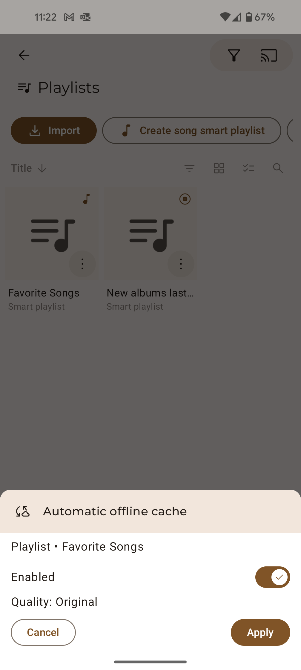

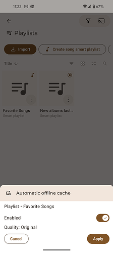

I have read the cache document you linked several times, but my confusion comes from all the different cache names: Are not all the caches “Offline cache”? (Except Playback cache, which should really be called playback buffer to prevent confusion.) So, in the hamburger menu from a playlist when you choose “Configure auto offline cache”:
and check Enabled, you don’t know if the songs are going to Rolling cache or Permanent cache.
In my example here Favorite Songs playlist appears to be automatic caching to rolling cache. And Settings document does not say that you can’t auto cache to rolling.
I’m trying not to use permanent cache, as there is no size limit. To me that is a worse scenario and cause problems with other apps on phone, wereas running out of Rolling cache is only an issue limited to Symfonium.
I can accept why a person would want a permanent cache, but really there needs to be a size limit setting. This same situation:
will happen if your phone runs out of storage :frowning:

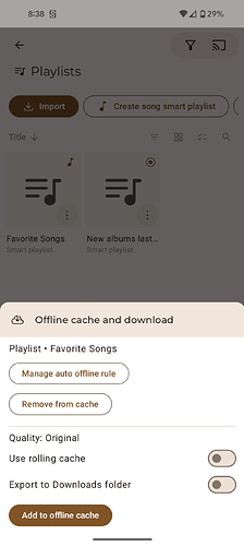

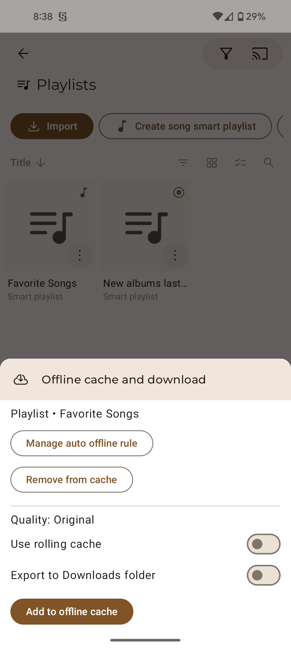

I guess, my remaining question is why the Favorite Songs playlist went into Rolling cache? I do have Settings>Offline, Cache and Download>Media>Automatic offline caching of favorites Disabled.

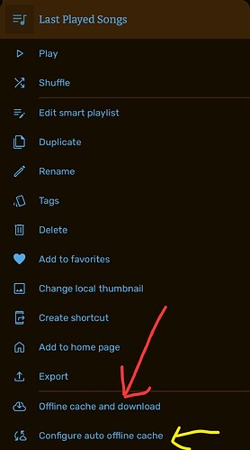

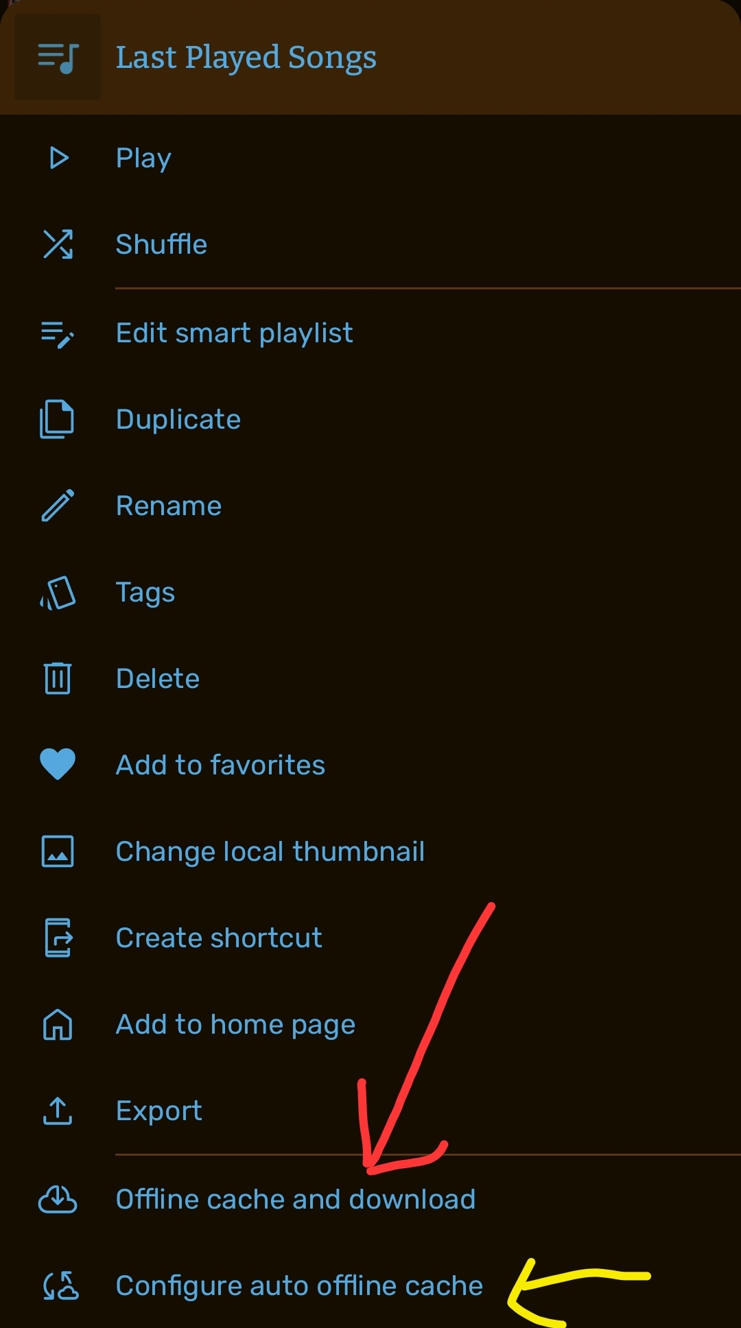

Depends on where you enabled the caching:
If you had enabled automated caching (yellow arrow), then it would have been in the permanent cache. But you probably used offline cache and download (red arrow), and enabled rolling cache there. Which means the current state of the playlist is cached, but once something is dynamically added to the list, it will not be cached.

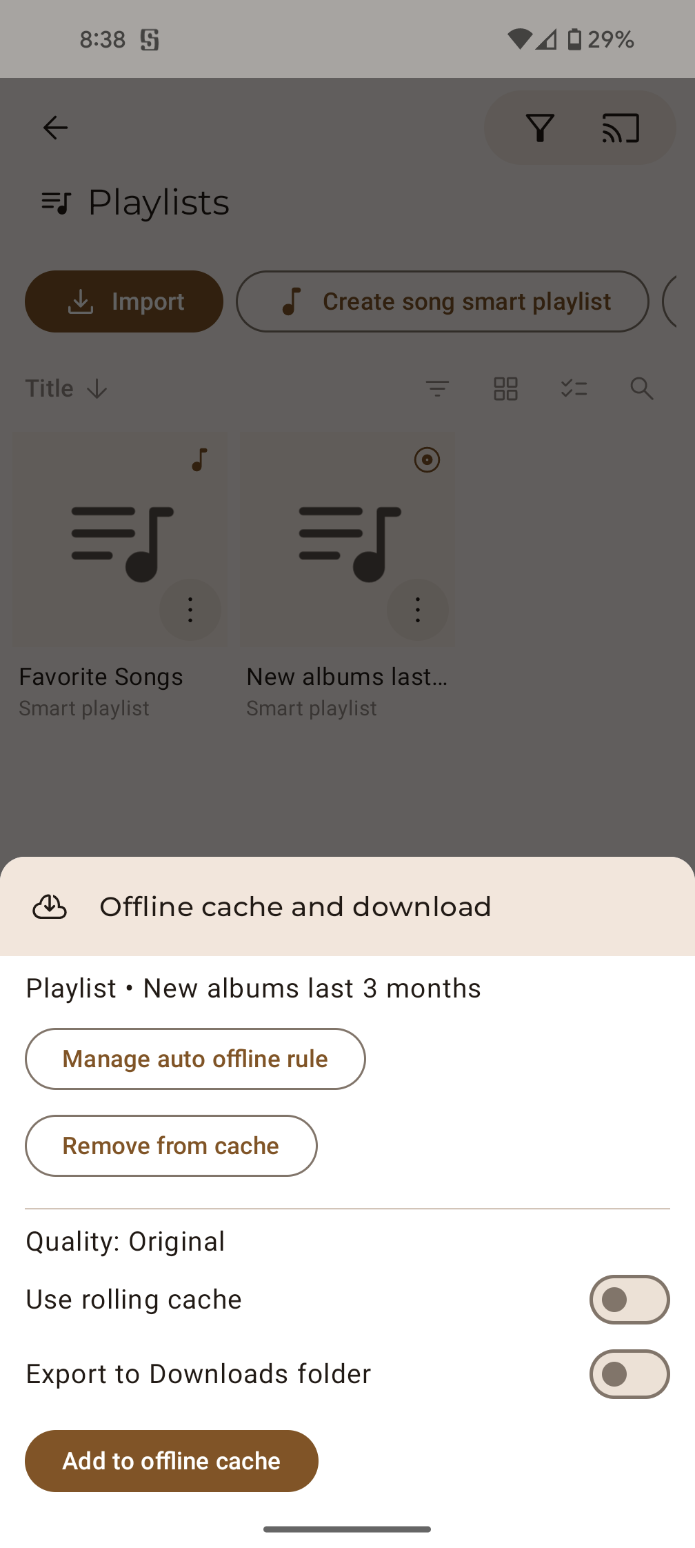

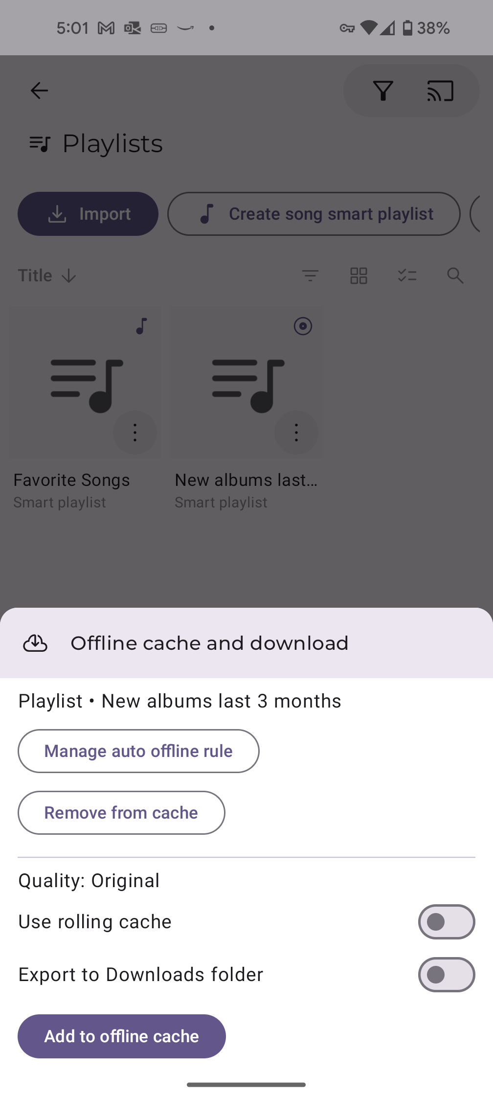

I used offline cache and download (red arrow) on both and toggled “use rolling cache”. Interestingly both revert to toggled off when I go back in to view settings
As I said, that option is for caching in that moment only. Don’t understand the “Use rolling cache” switch as a permanent decision. There could as well be two buttons: “Store in permanent cache” and “Store in rolling cache”. And when you hit either of those buttons, whatever is in the playlist in that moment gets cached.
When you return next time and the playlist contents has changed, you can decide again where you want to cache it. (If you chose “permanent” before, those files will still be in the cache, and only files that are new in the playlist will be additionally cached.)
What you need to use for your new new albums caching is the auto offline cache behind the yellow arrow. Before that, tweak your playlist like Roukanken suggested.
Well, it really Should be button to click for rolling cache. Having a sliding toggle makes it look like a setting that is supposed to be maintained.

I really do get it, that’s why I said it should be a button you click for a 1-time action, not a sliding toggle that looks like it should hold.
Since there’s possibly 4 settings and any combination of them that would mean 16 buttons
Not sure where you see 4 settings, my screen only show 2 plus the clickable buttons for Manage auto offline rule, Remove from cache, and Add to offline cache. I assume that last one sends to permanent cache.

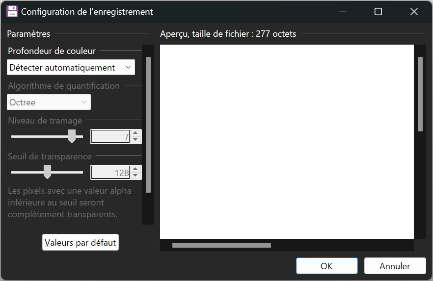

Paint.net save screen, you configure and press OK button…
Except my screen doesn’t have any “do it” or Ok or Apply button
Well in another it would be save or export in the save or export page.
Here you are in the offline cache page and it’s name add to offline cache.
It’s for sure a really strange choice …

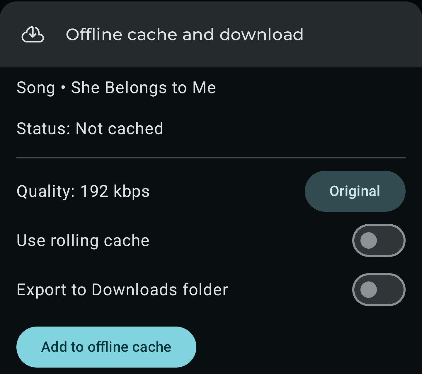

So if you want to Export to Downloads folder you have to slide the toggle then click Add to Offline cache?? What if you only want to export?
In that case the button label change, but there’s still only 1 action possible that you configure.

The simple transcoding case:
So now the actions are:
Add to permanent cache at original,
Add to permanent cache at transcoding rate,
Add to rolling cache at original,
Add to rolling cache at transcoding rate,
Export to downloads at original
Export to downloads at transcoding rate,
That’s already 6 buttons how would 6 buttons be better and easier for the user to understand?
Now imagine one more option and it’s a lot lot more buttons.
Now imagine that the quality part is not just a toggle but you can select the quality and the format.
Now imagine …
As I said there’s many settings, you configure your settings then click on the button to do the action corresponding to the settings you choose.
It works like that in every apps, the fact that in your very specific case that screen only have 3 choices does not means that there’s no other choices for other users and so consistency prime.
