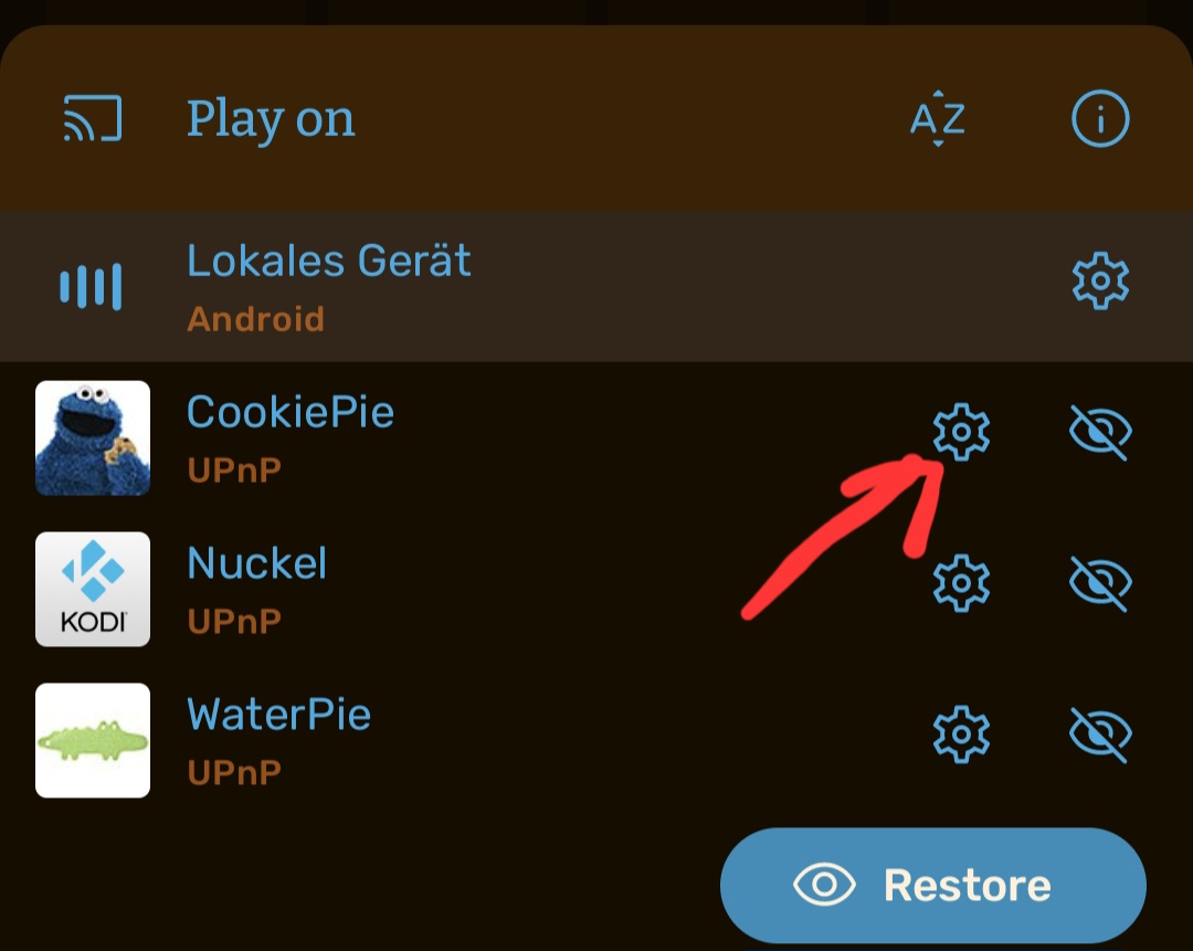

What Tolriq meant with disabling gapless playback in the renderer settings is not on upmpdcli side, but within Symfonium: click on the cast icon, then on the settings icon next to your upmpdcli renderer:

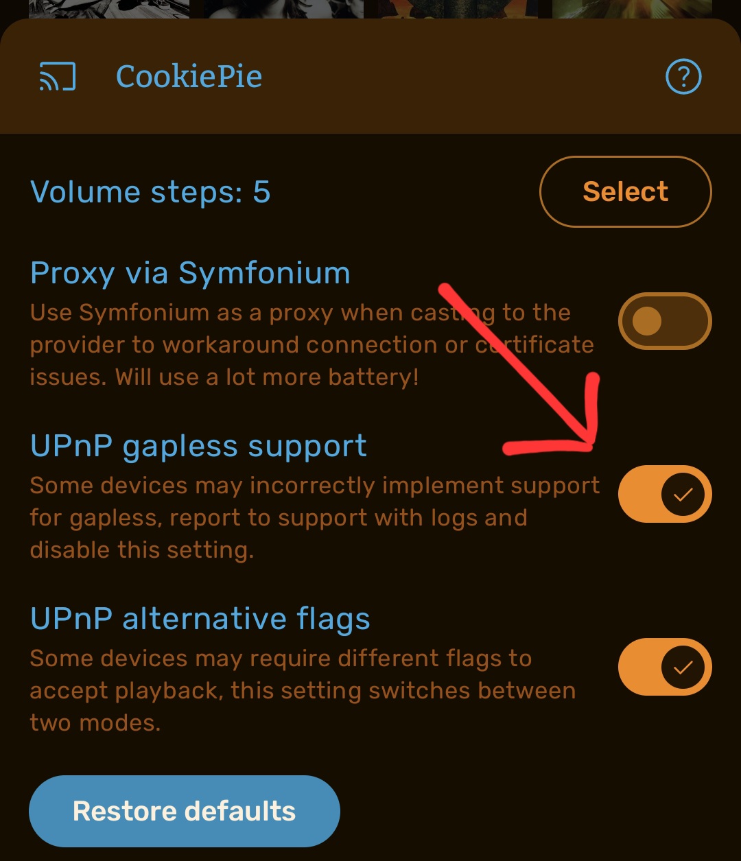

And then on the gapless setting:
Thanks @splinter !!
I remember having seeing that settings somewhere, but I was trying to disable it from the app side for more than 1h. Went to every single menu-submenu, EXCEPT there where you pointed.
And indeed, that mitigates the problem, and I can listed to the playlists normally again.
