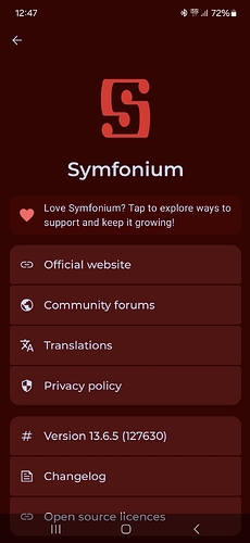

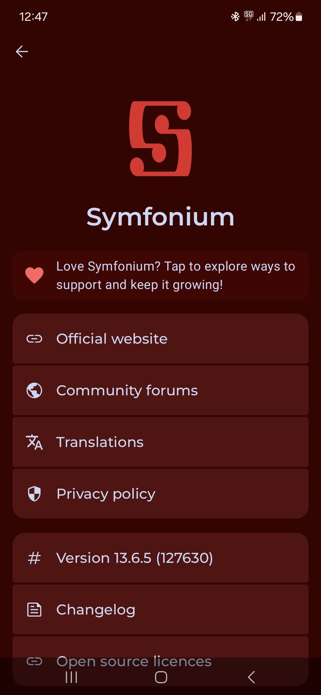

Unsynced lyrics still treated as synced in 13.6.5

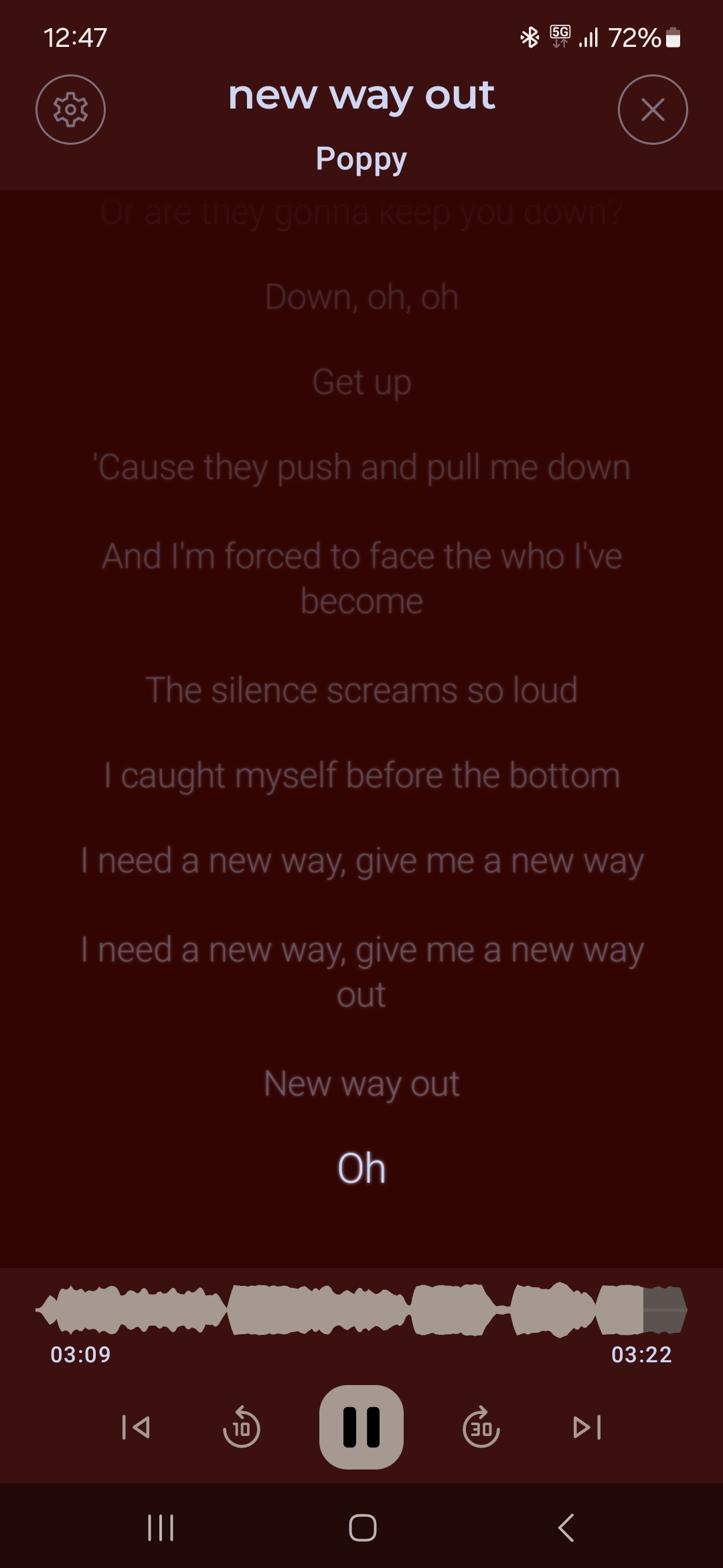

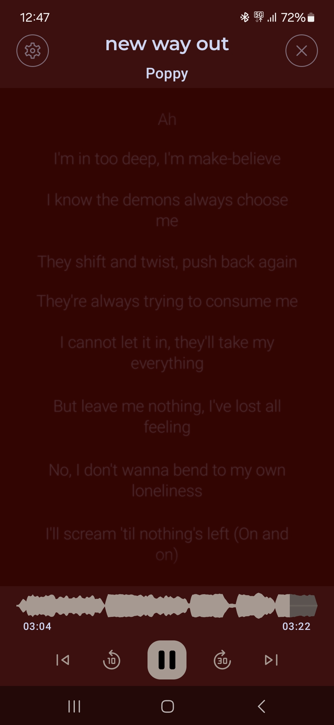

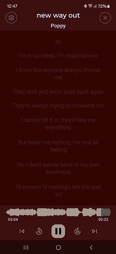

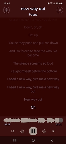

Tracks with unsynced lyrics are treated as having synced lyrics, instantly jumping to the last line and all previous lines greyed out.
The first track I played after updating to 13.6.5 displayed the unsynced lyrics properly, but all subsequent plays are affected. This is the case for new plays of the track that worked fine initially as well.

This started happening in 13.6.0a and persists in 13.6.5.

All lines have the timestamp 0:00, even though no timestamp is set in the tag.
Tapping a line jumps to 0:00, restarting the song.
  1. Play a track with UNSYNCEDLYRICS in tags.
  2. Open lyrics view.
  3. Lyrics view opens at the bottom, with the last line highlighted and all other lines greyed out.
