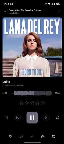

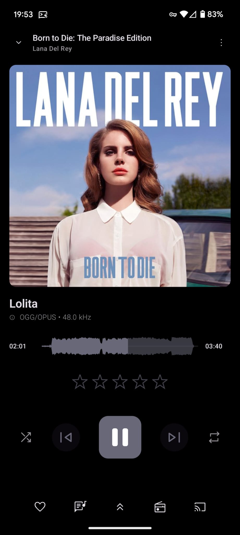

Hmm, that’s strange. I’ve generated another set of logs - “kojak2”. Not sure if that will be any different. I have a screen recording where you can see that the codec type is being displayed as OPUS (it should be FLAC), and you can see that as I try to seek, the song jumps to the beginning (also when moving to a different song, the seekbar is in the wrong position) - not sure where I can upload this so you can take a look..
In the meantime, here’s a screenshot but not sure how useful it is to you (the song is actually at the beginning; the seekbar is incorrect).
