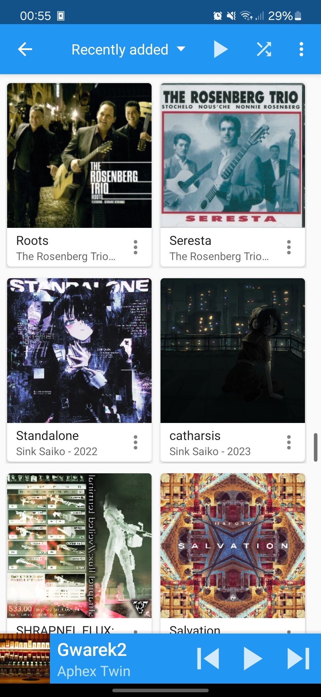

Sorting by date added does not work as I would expect it to. In the navidrome UI the “Recently Added” option sorts the albums correctly, and DSub shows it correctly too. I tried with compatibility mode, fetch more metadata and combinations but it doesn’t work.

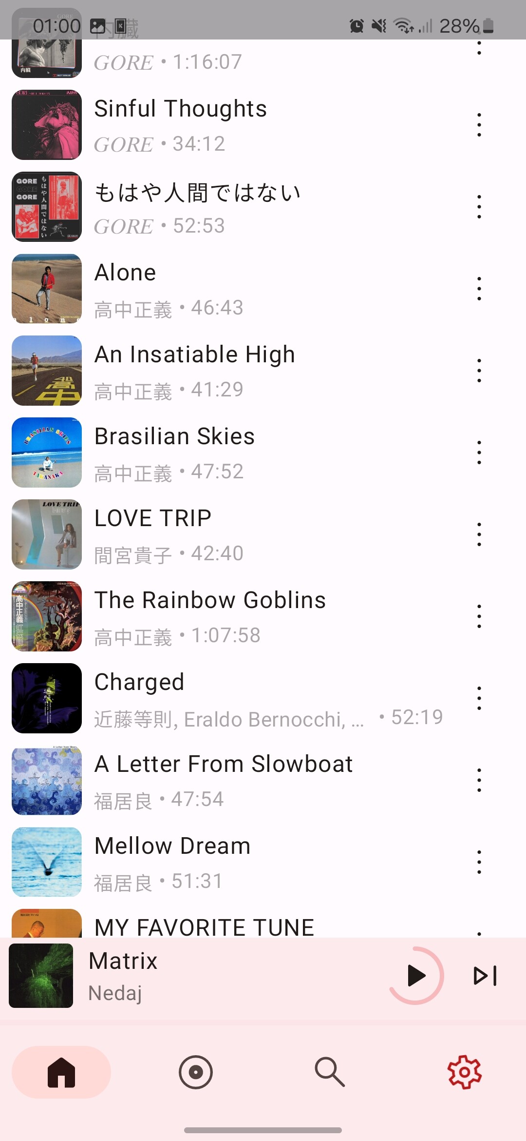

Wrong order ----------------------------- Correct Order

The left image is an album playlist sorted by “Date added”. I have synced the media provider with debug enabled an uploaded the file again with the identifier 4ntb sync. Relevant logs start from 12:00. Thanks for your time.
