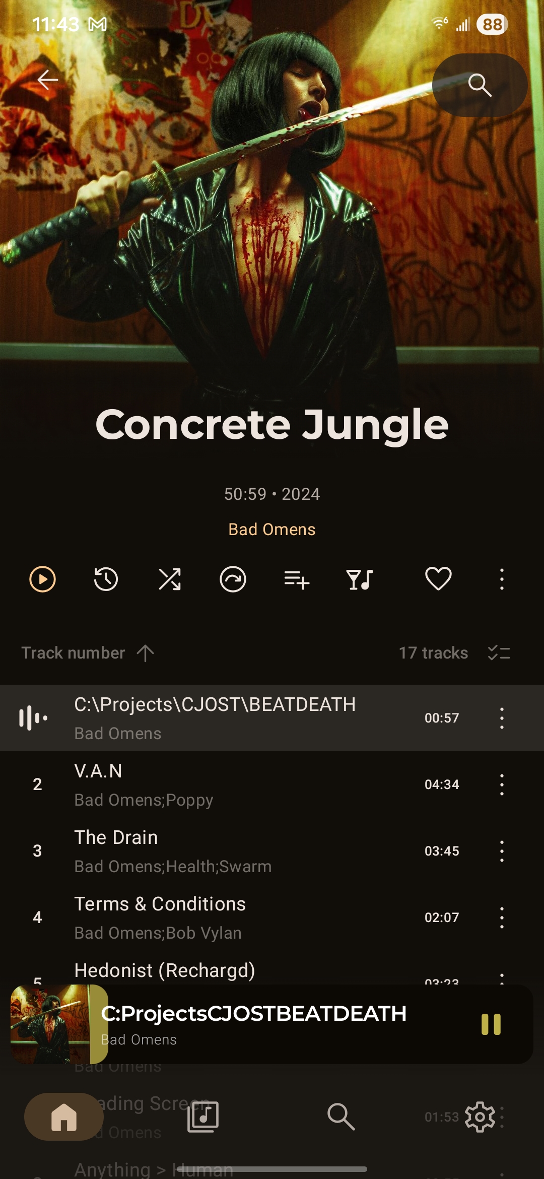

  1. Have a song named something like “C:\Projects\CJOST\BEATDEATH”

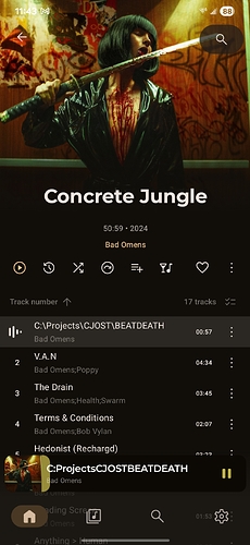

  2. Observe song title is correctly rendered in album view

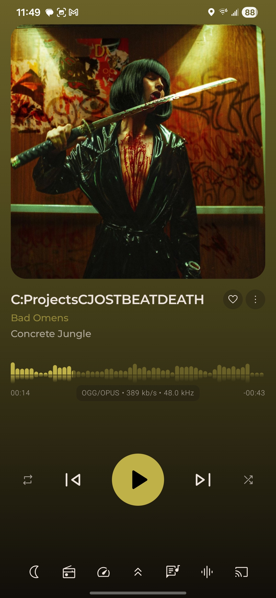

  3. Observe song title is not correctly rendered when playing

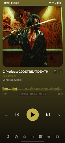

C:ProjectsCJOSTBEATDEATH is the text I see (screenshots should show this as well in case you need a visual).
Affected device is my Samsung phone, I must have plugged in the incorrect device on the report. I edited my original post.

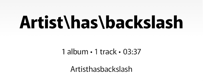

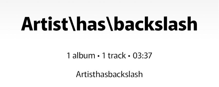

Please note that this happens not just in the NPS, but anywhere that custom strings can be used.
Here is an example of the Artist page. Raw text can be seen on the main header while the custom string below it has the slashes removed.
String used is simply %title%
