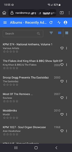

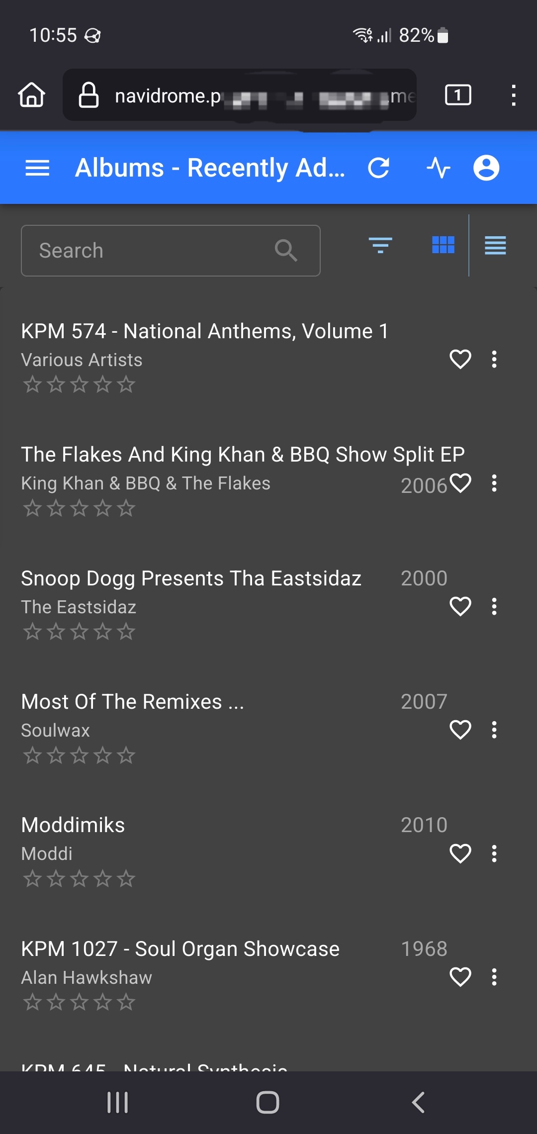

Recently Added Not Consistent with Navidrome
Recently added items (albums, artists) are correctly listed on Navidrome server (according to last modified file date I guess) but not consistent with Symfonium listing.
Symfonium listing is neither according to last modified nor created date of files. It seems completely random.

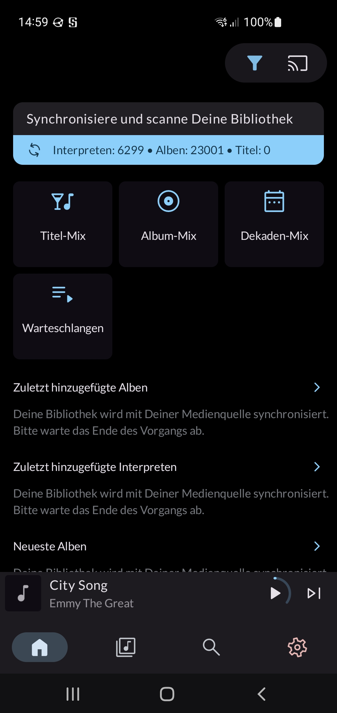

I uploaded the logs again with tag mi6logs. I removed and re-added the media source (subsonic) and it’s scanning without problems:
Progress:
Then check the result when it’s finished and report back.

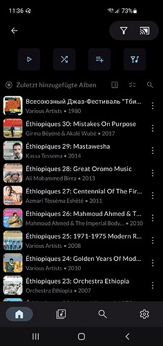

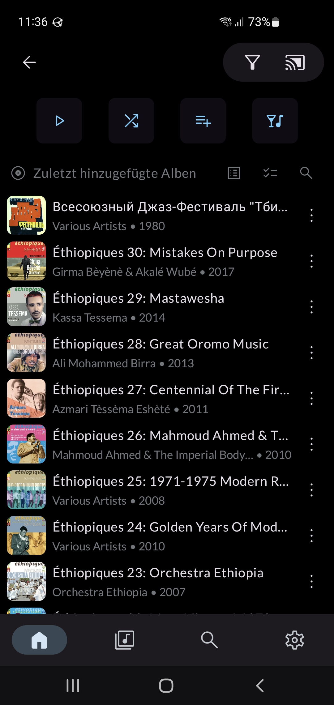

Synced 100%, recently added data still inconsistent.

Could it be that Symfonium doesn’t use recently added data from the media source (e.g. Navidrome) but creates its own on every source update scan? This might result in inconsistent data for the initial scan, but media added later would probably be consistent…
Your server returns mostly the same date for all albums as date created, probably the date of the scan.
 "created": "2024-06-27T02:00:03.580658696Z",
