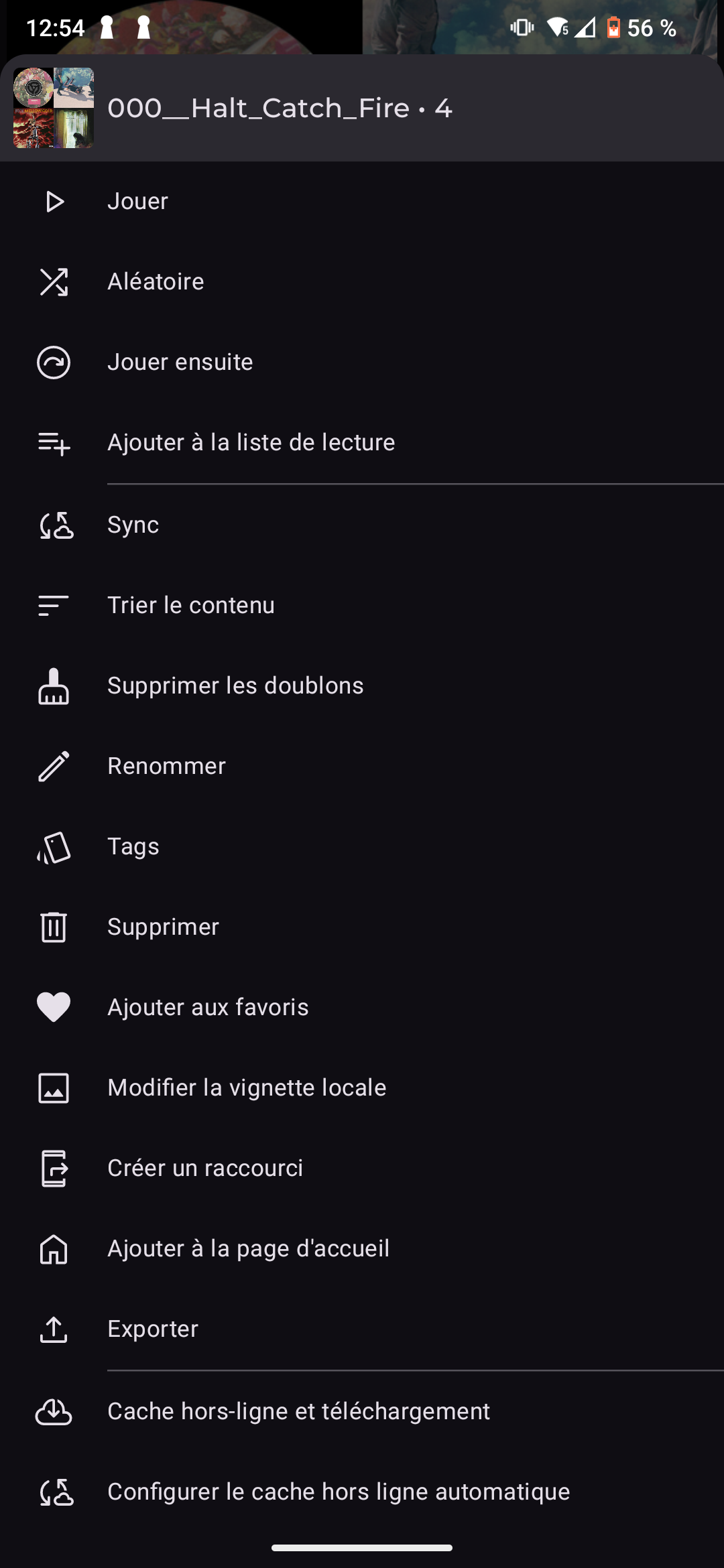

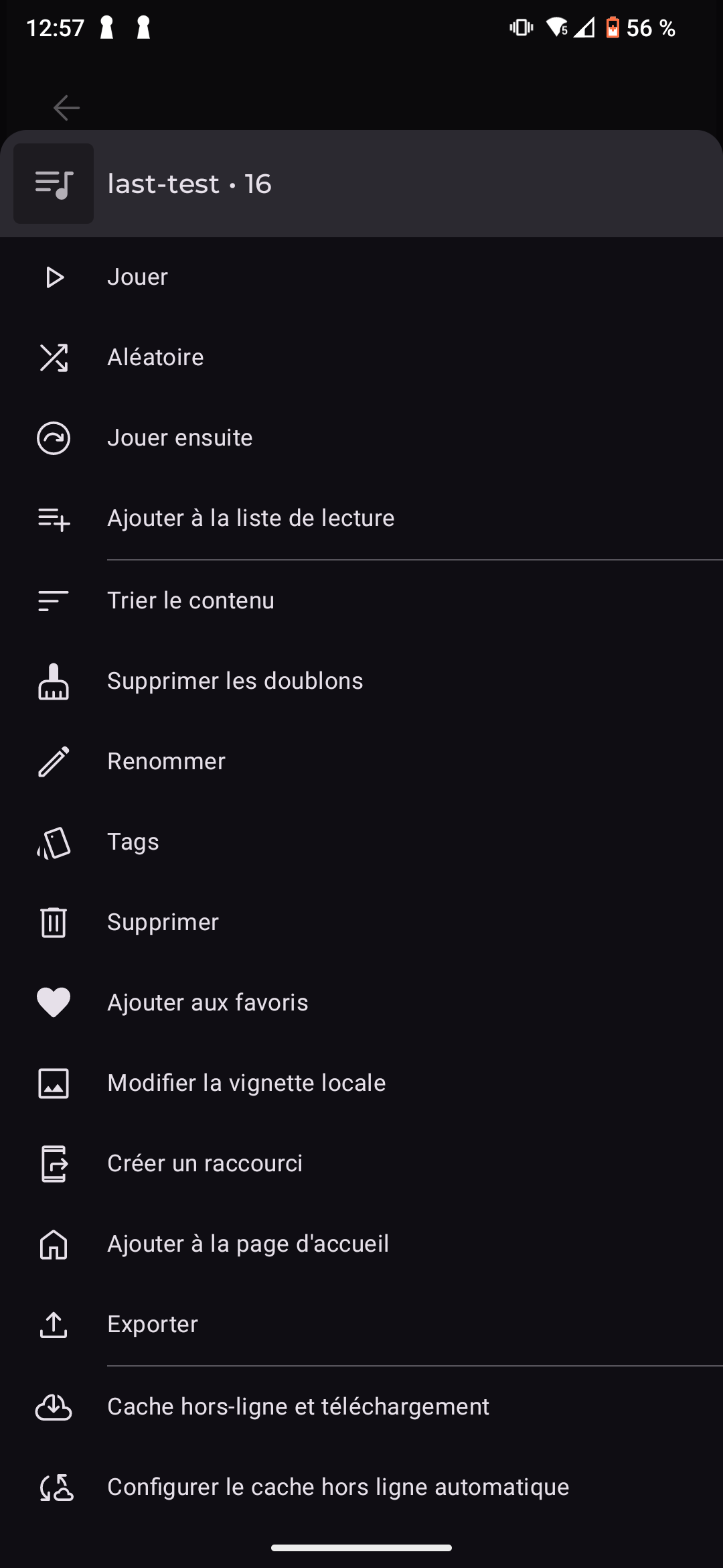

I cant sync (export to navidrome) my playlists created by Symfonium… only the ones created from Navidrome are syncable.
So I try
locked or not playlists..
I not have the sync button every time :
The seconde one created from the Navi serveur
Thanks for all
