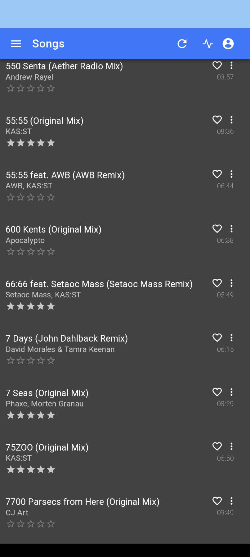

Navidrome rating data not displayed anywhere in Symfonium
Apologies if this might be a duplicate of [7.0B1] LMS track and album rating not shown in Symfonium. I’m having a similar issue, except it’s with Navidrome as my server, instead of LMS.
Even though the Navidrome server has rating data available for my tracks, I cannot see that rating data available anywhere in Symfonium’s UI.
See additional information after screenshots for more context.

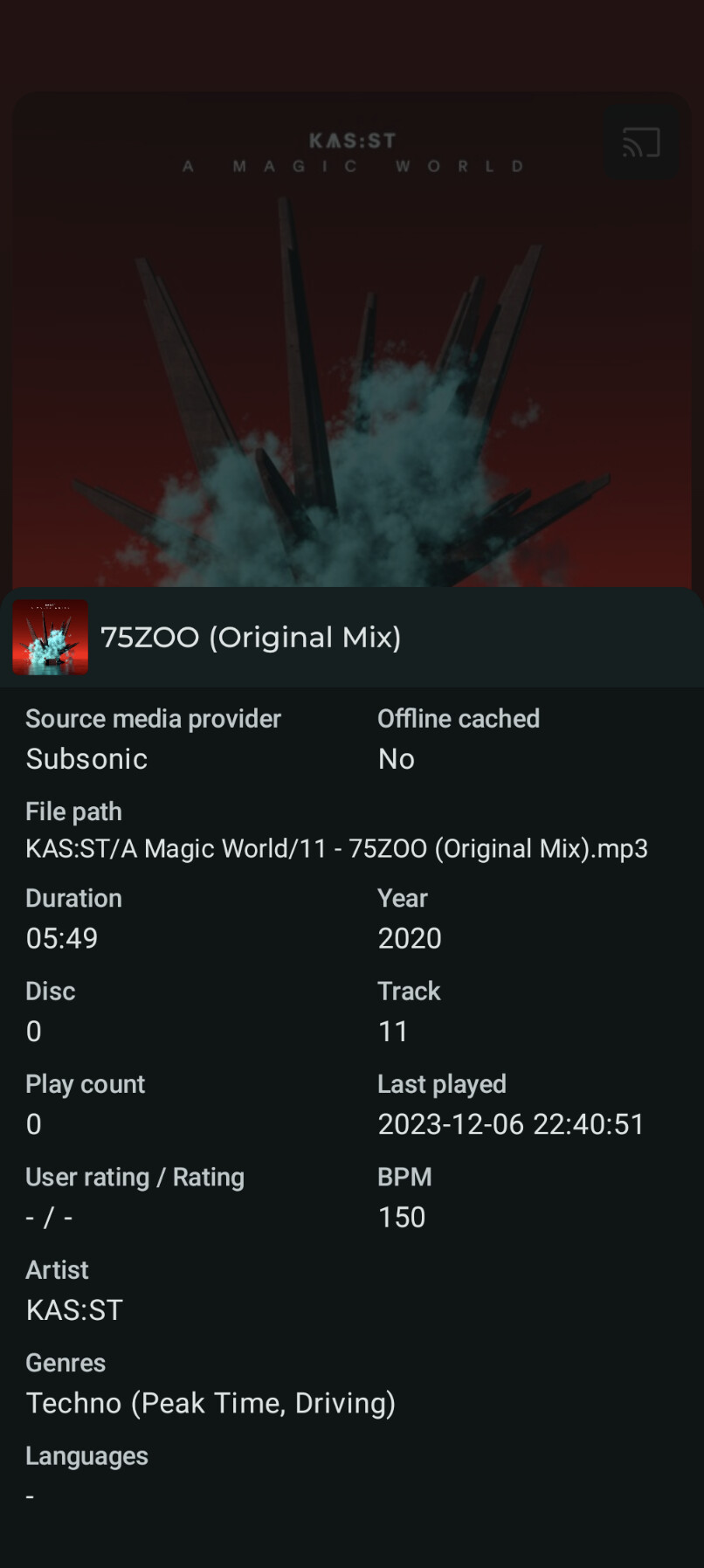

After enabling the debugging logs, I went to my “Top Rated” playlist to open & play the track titled “75ZOO (Original Mix)”.
In the logs, it looks like the track was retrieved at timestamp 2023-12-06 22:39:50.761, and interestingly the metadata shows “userRating”:5, despite that not being reflected in the UI’s track details (per screenshot).

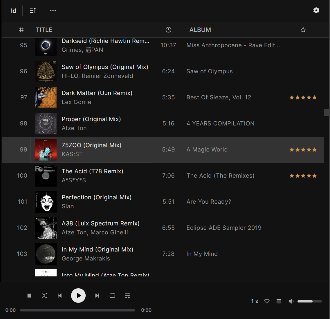

Rating data shown in Feishin:
Rating data shown in Navidrome:

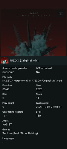

Rating data missing in Symfonium:

  • I verified that the Navidrome server successfully synced with these rating updates by seeing that the UIs for Navidrome, Sonixd, and Feishin all reflected the changes.
  • I cannot see that 5-star rating data in Symfonium (neither in “rating” or “user rating”).
