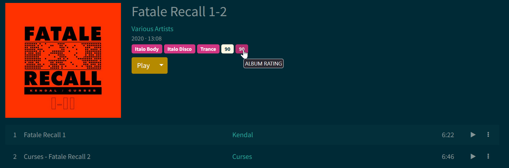

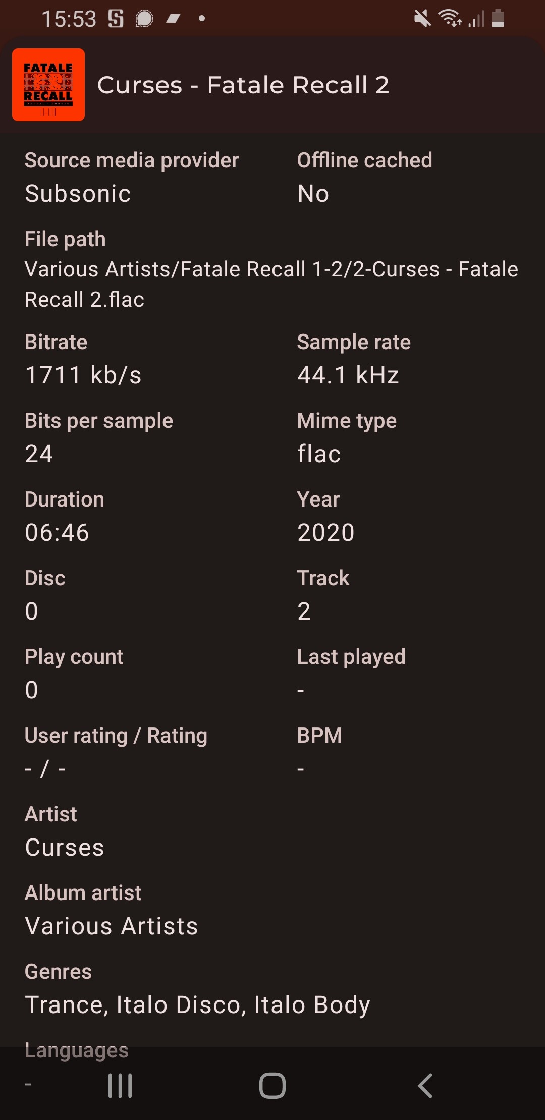

I scanned my (mostly FLAC) music library with LMS 3.45.1. LMS is configured to scan the extra tags RATING and ALBUM RATING and correctly displays them in the Web UI. However, after scanning the LMS library with Symfonium 7.0B1, I do not see the ratings in the track details.
I’ve recorded the logs as I was doing the following actions: look for the song, open the details, play the song, open the details again. I see the RATING and ALBUM RATING tags are mentioned in the logs, so at least I know LMS is sending them.

I will wait for itm’s input, thanks for pinging them. Edit: I actually remembered they mentioned ratings wouldn’t be read/written from tags, only through the subsonic API: Confusion with tags scanning configuration · Issue #353 · epoupon/lms · GitHub. So I guess this kind of functionality is not happening.

Indeed adding extra tags in LMS does only make them available in the LMS’ UI.
LMS is multi-user oriented, so the user ratings will likely be read from/written to the LMS db.
My opinion is that a good compromise to this is hinted at with the User rating / Rating field in Symfonium.
  • User rating would be the rating the user reads-writes within the Symfonium / LMS environment. It is independent of the file tags and stays within that environment.
  • Rating is taken from the file tags and is read-only.
