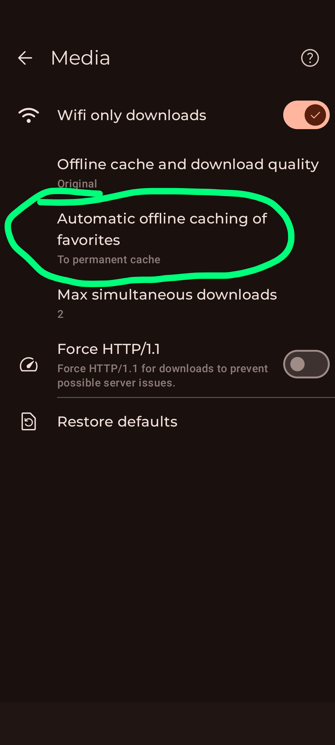

And on a different note, I’m confused with the permanent cache since you highlighted it was empty. I have the following settings to permanent cache, why aren’t my favorites showing up as occupying that permanent cache? And also, are those two settings equivalent? It always threw me off that the “same” setting was available in two different places.
In actual track lists.
Yes all from the Auto offline rules is a copy of the same settings that can be in multiple part of the app, the setting below is also a the same as the one you can find in other places.
They are in permanent cache as opposed to rolling cache, so they are not removed because no more space. But they are here from an automatic rules.
As explained anything from an automated rule will always be downloaded again if removed so it’s treated a little differently to help users avoid doing mistakes.
Meaning they are not supposed to show up in permanent cache at all if they come from an auto offline rule? Not sure I got it sorry.
That is correct. In the statistics, “permanent” means not rolling and not auto rule (beware: if you enable full auto caching in the provider settings, that counts as “permanent”, not “auto rule”).

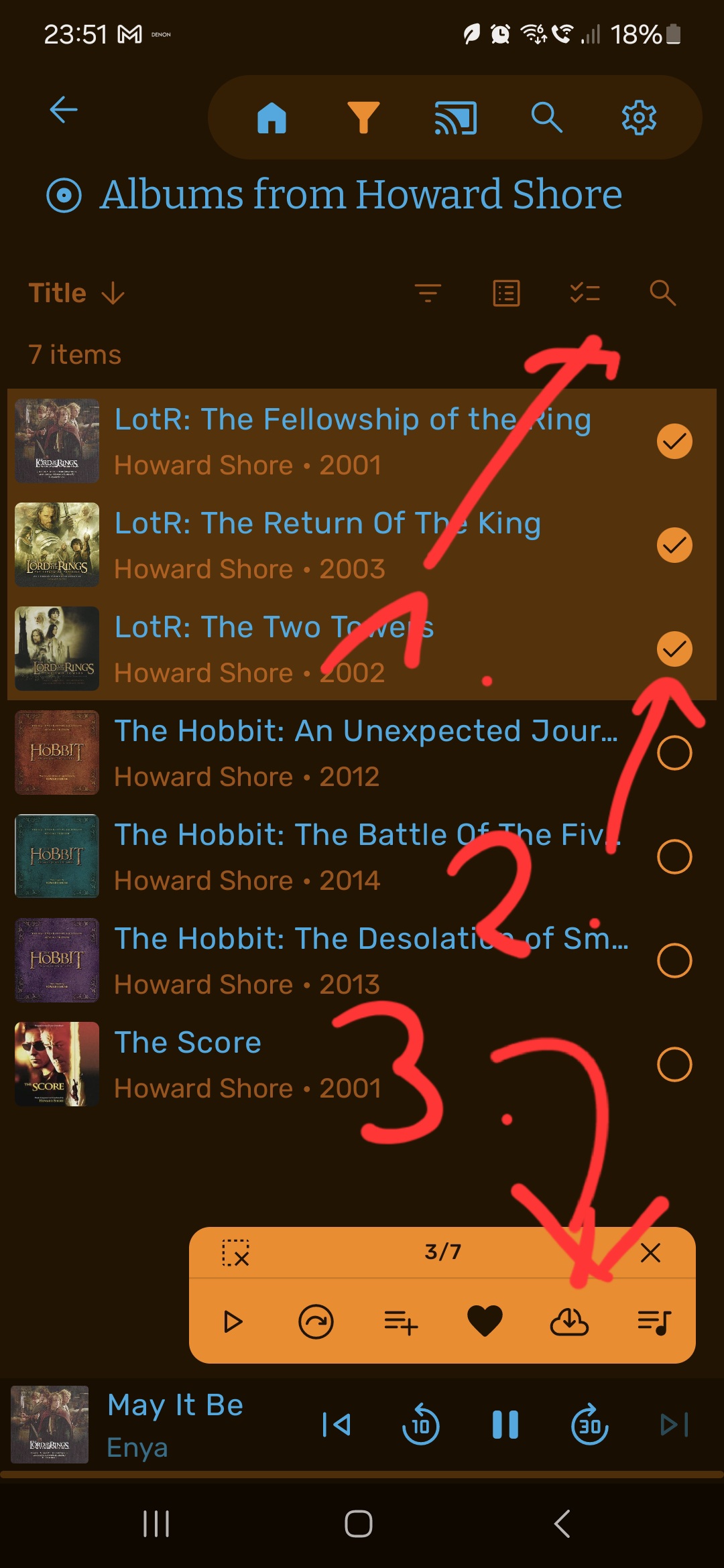

Is there a “select all”? I’m in the Tracks screen trying to select all “available offline” and I can’t see a way to select all the tracks :confused:
No, but in select mode you can long-press the first entry and then drag down, the it goes very quickly through the list.
Go to the Albums or Genres screen, the it is less elements to select :wink:
I tried doing that pressing the checkmark and wasn’t working. Did it from the title and it worked. And thanks for the tip! :smiley:
