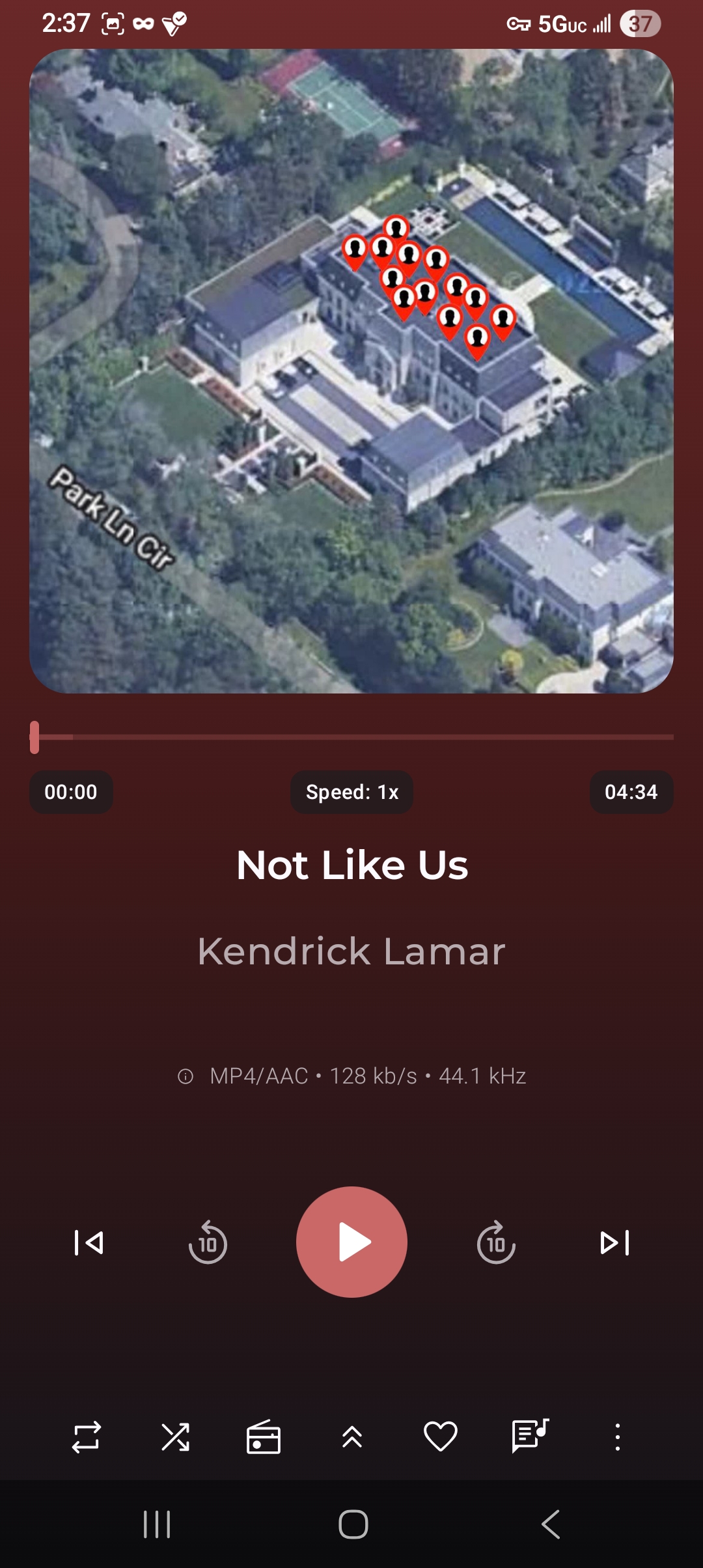

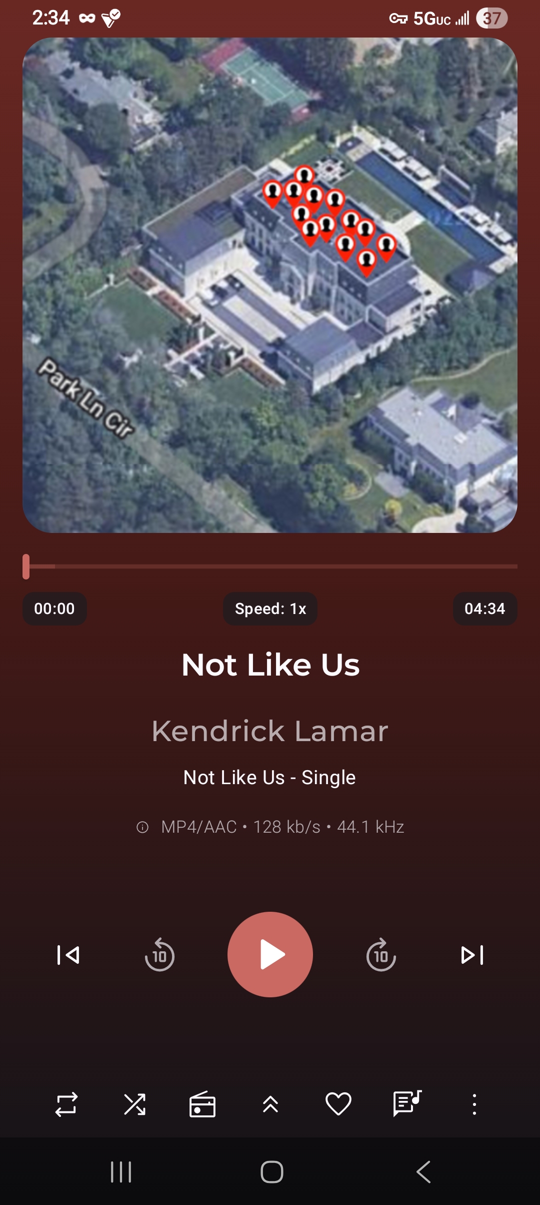

Hello! I am having a minor issue in regards to albums not displaying correctly if it is playing from a remote server (jellyfin) I found this post from 2022 that shows this as well:
Locally playing the same file works as intended, and the server is fully up to date and is fully synced. Attached are screenshots of the two files compared from 1: local and 2: jellyfin
These are the current specs of the device used:
Symphonium 13.2.0 (google play)
Android 15
Sm-A146u (Galaxy A14 5G)
Playing these files from the official jellyfin app shows album information correctly.
Android 15
