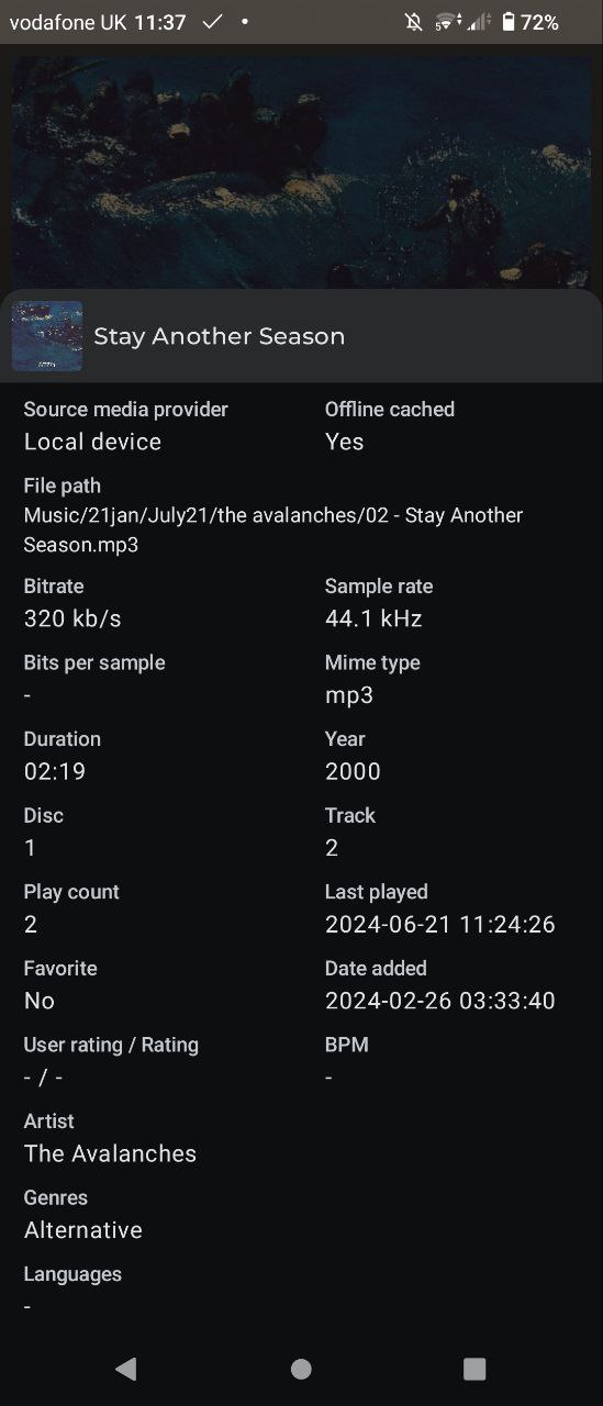

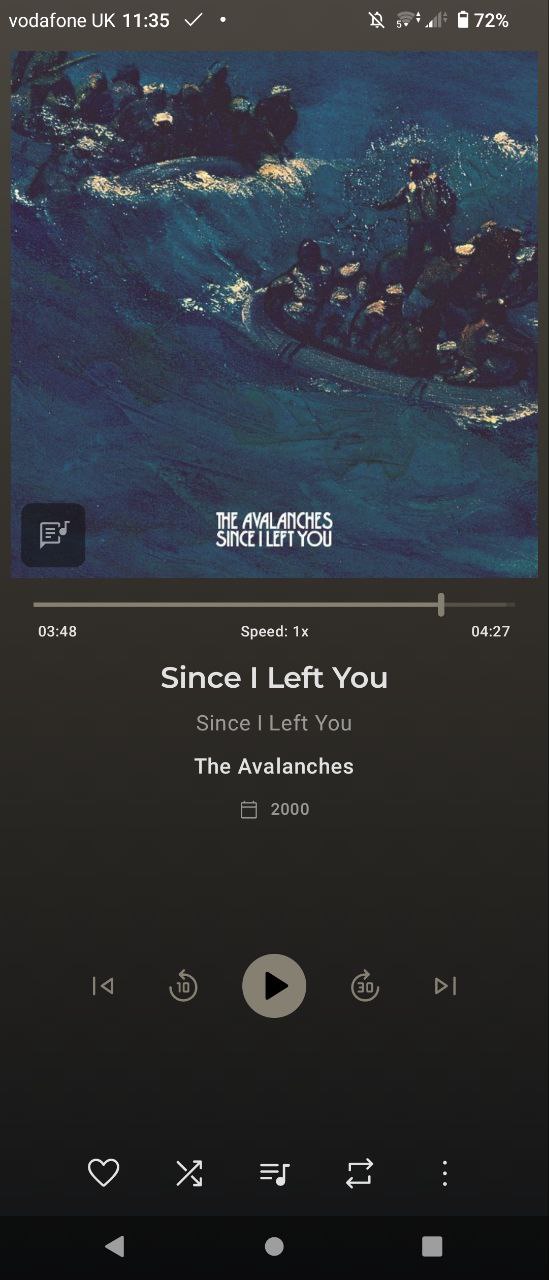

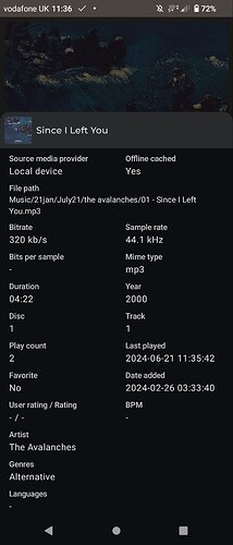

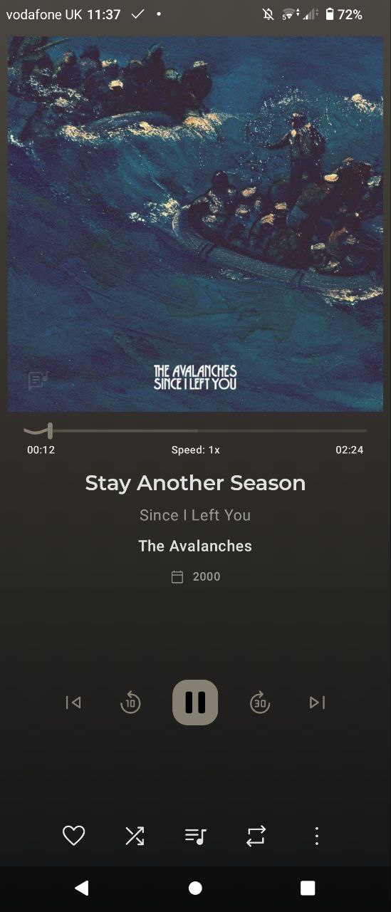

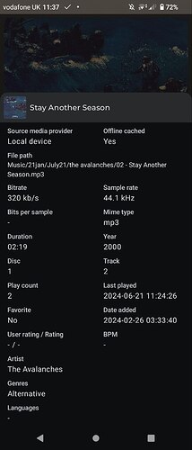

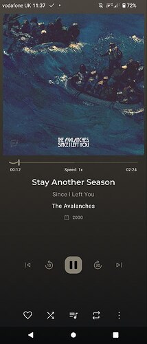

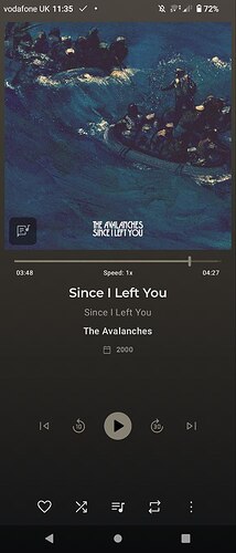

Hi, despite the track length being correctly in the list/details page, many(!) tracks are displaying the wrong length when playing. It seems to be up to 9 seconds added length from what I can tell. I noticed this when gapless wasn’t working as a result.
All tracks I’ve noticed are mp3s. I’m not sure if this was happening before. I’ve tested with both the Internal decoder toggled on and off, and I get the same results.
I will upload two files where the length is incorrect (the songs by the avalanches) and one where it works correctly (the song by the xx). The issue seems very widespread.

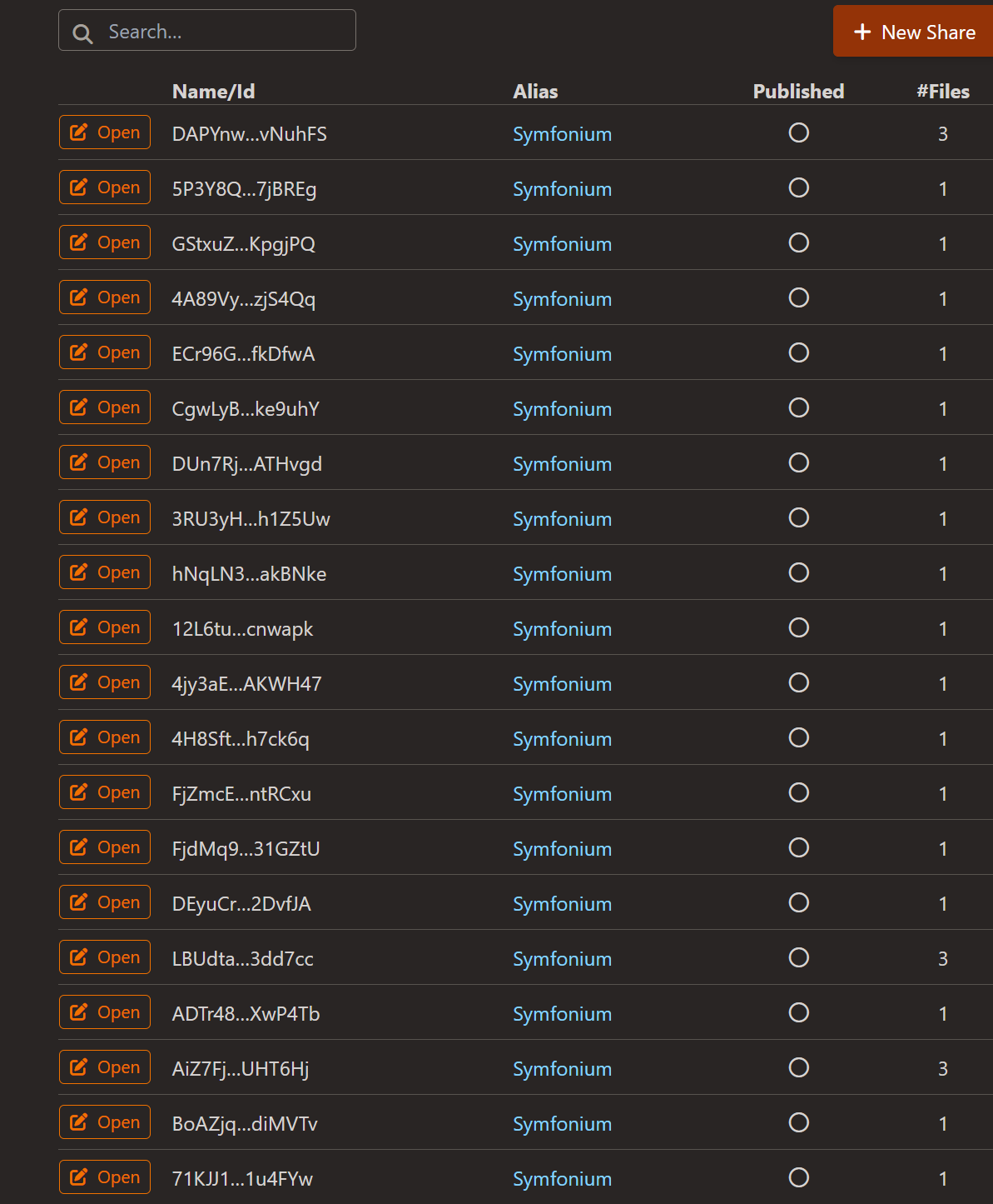

They are uploaded but not under the same description.
For the record since it happens frequently that people does not understand why I ask for a description or unique text to find the uploads:
This is what I see :slight_smile: Since I can’t click on each uploads due the number of them from random people that never contact me, I only use the search that search in the description.
So please remember the description you use and write it in the issues.
Ah I see, no worries. I will reference the description in the post from now on. I assumed it would be tied to my username but I see now it’s a seperate site!
