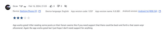

I understand. Thank you for your support.
Thanks it’s really appreciated :wink: I really wonder why I still bother …
