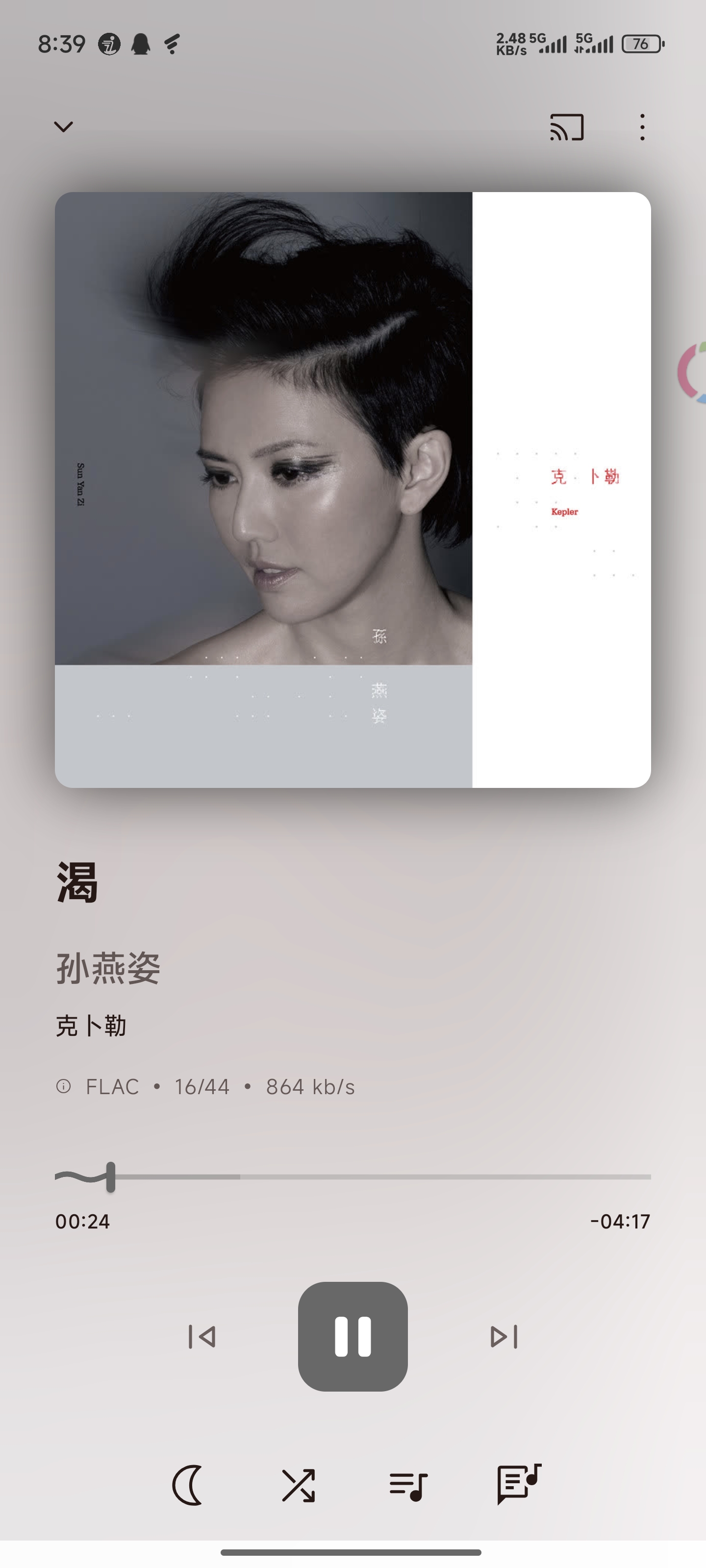

White navigation bar on light theme
I got white navigation bar when my device is under light mode(and so Symfonium under light theme).

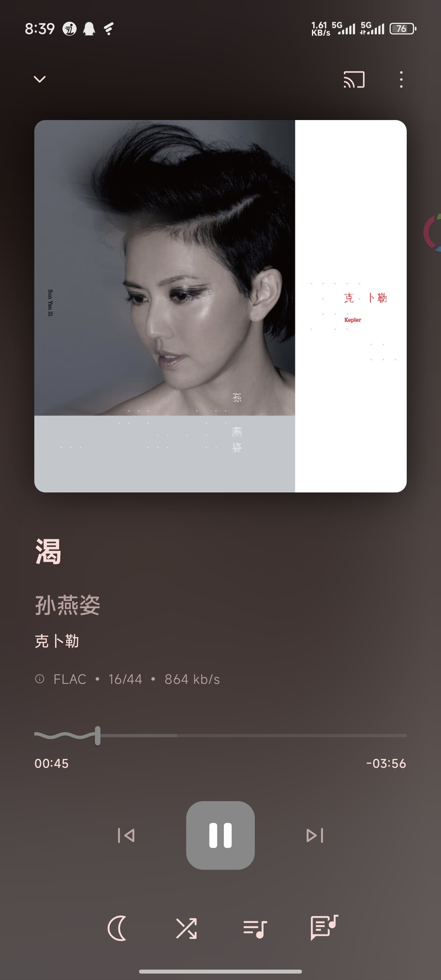

When I switch to dark mode, navigation bar back to colorful to adapt the background of Symfonium or Alarm cover.
Upload description: white navigation bar

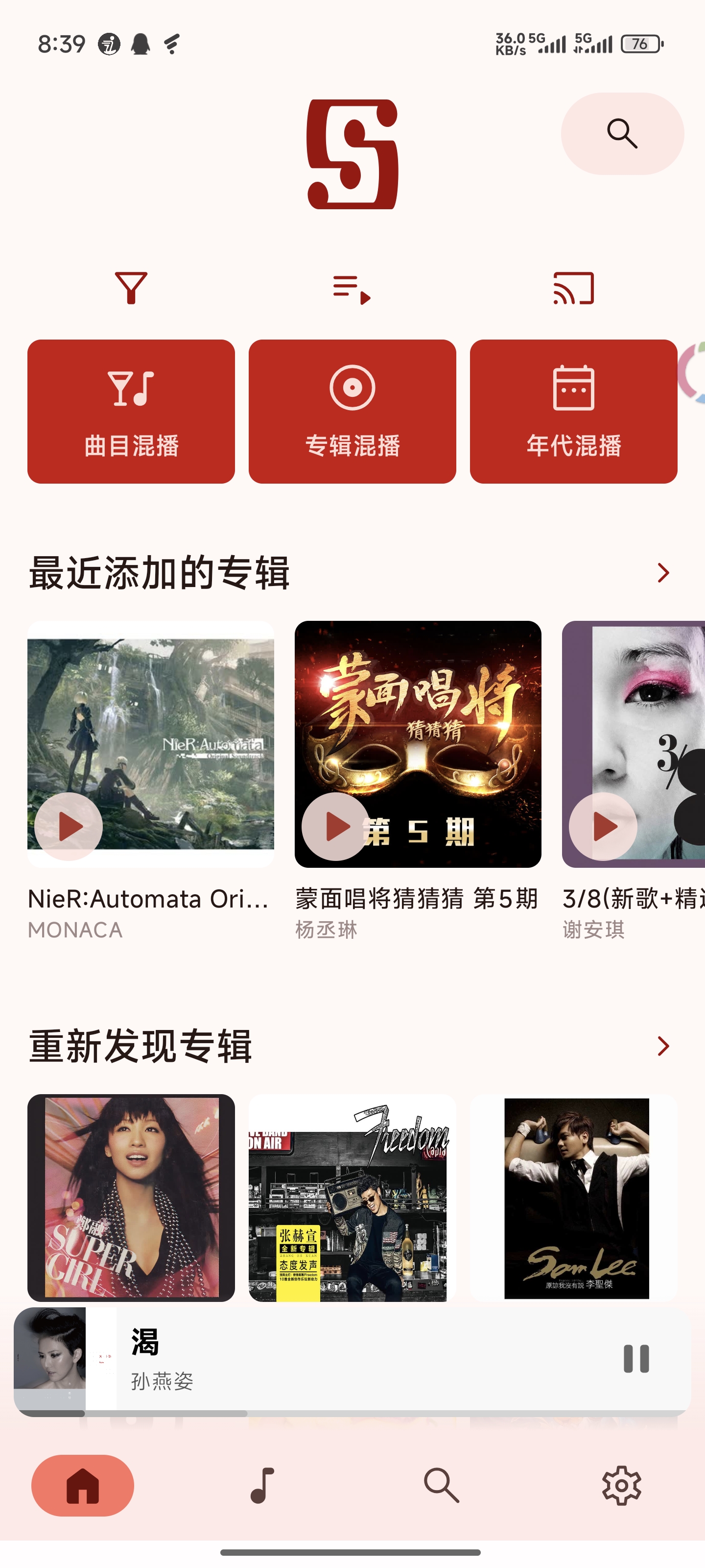

So there is the screenshot now. On Xiaomi HyperOS.
