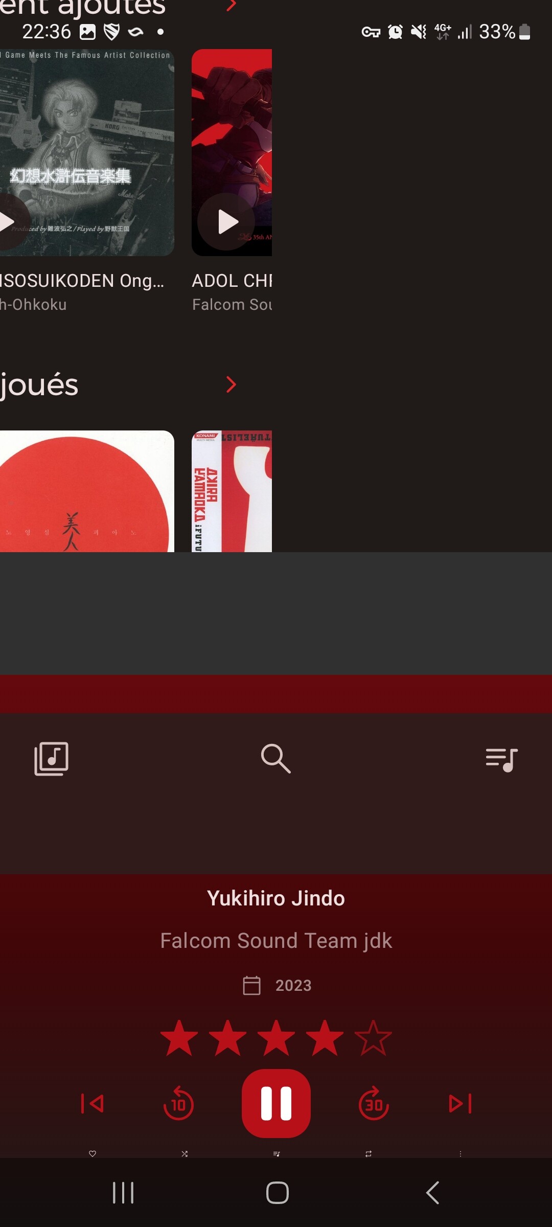

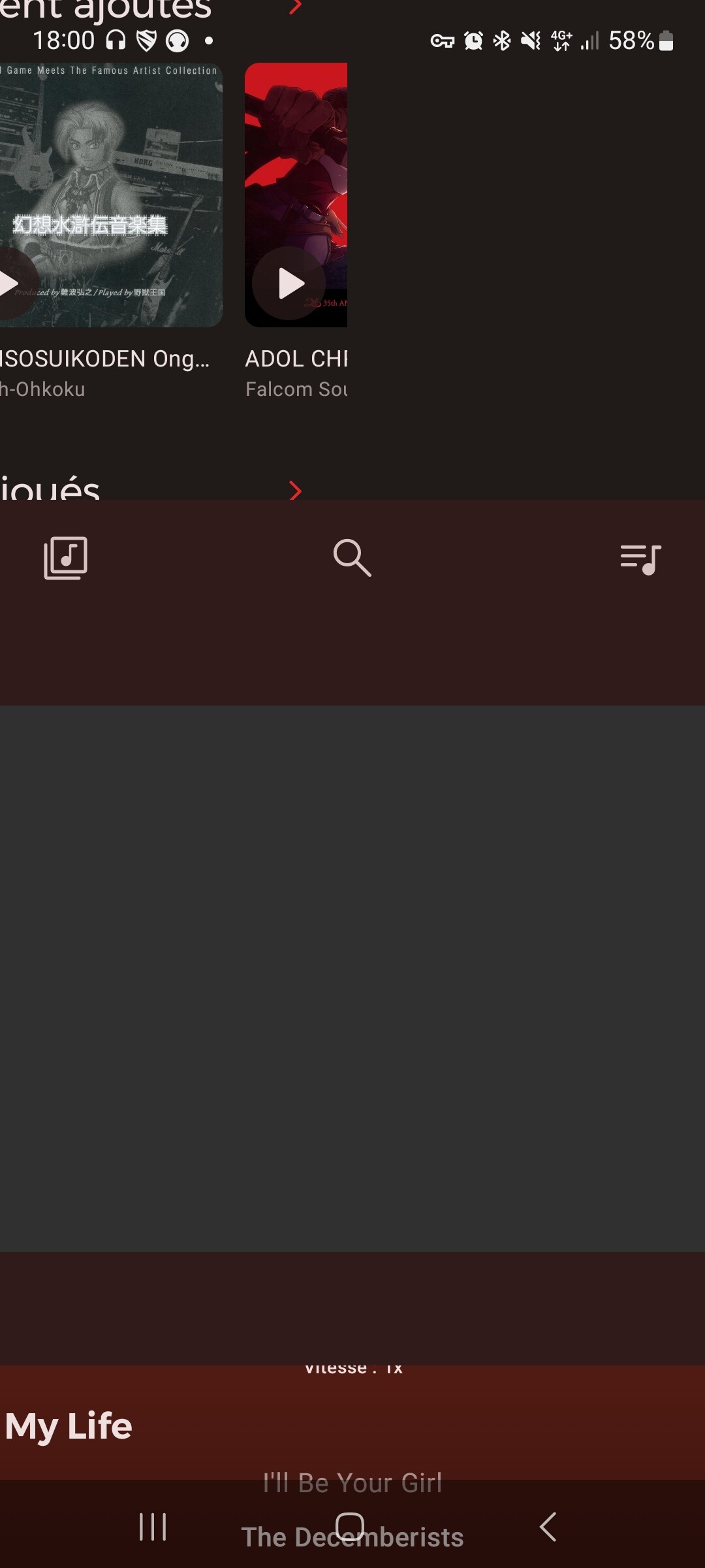

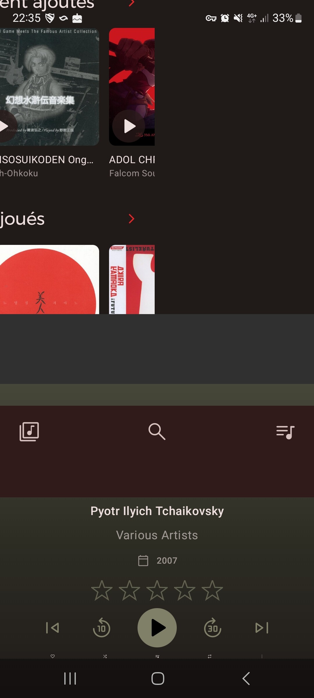

With the latest beta version, I sometimes have this weird issue, especially when I turn my screen back on (don’t know if it’s related).
To “fix it” i have to close the window app (not sure if that’s understandable, but you know, when you do like an alt+tab to see all opened apps, and you swipe one out of the screen)

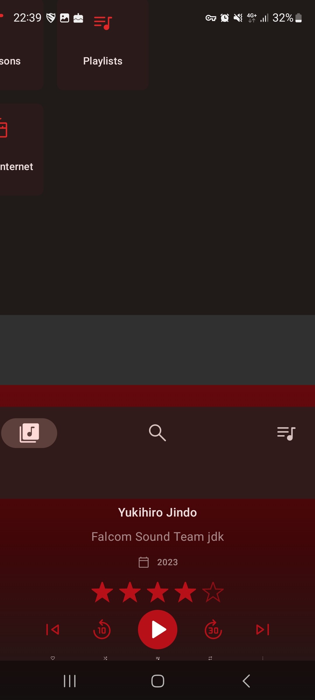

Before pressing play:
After pressing play:
Pressing Library:

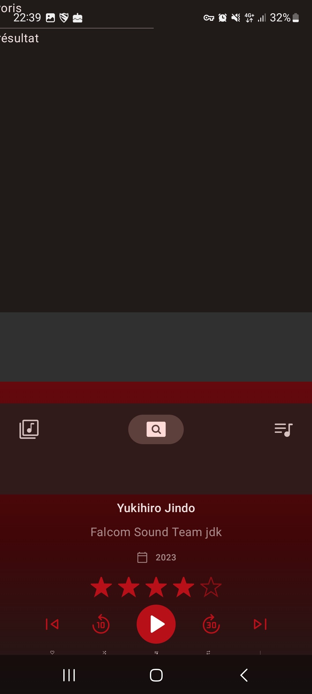

Pressing Search:

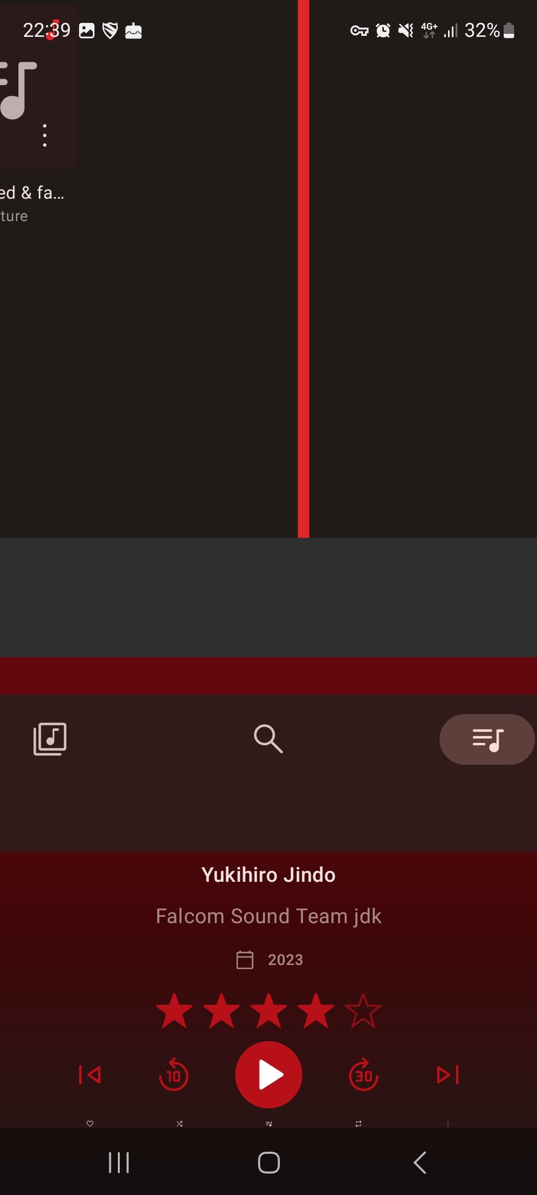

Pressing Playlists:
It’s like it renders the target component in the upper left side
