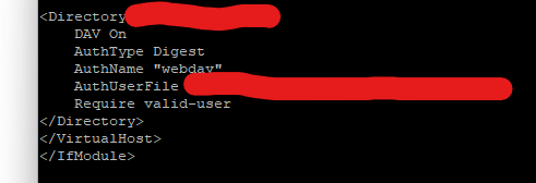

following an extract of my .conf file
No just that the server does not like the auth, as I said only your server logs will tell what it does not like.

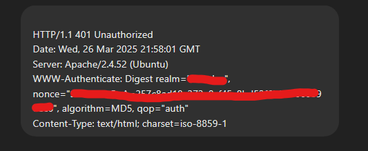

Hi, sorry for the late reply.
This is the only log i’m getting from apache2
You hide the realm it does not contains WebDAV as the authname from your config ?
Can you remove the authname config line ?
