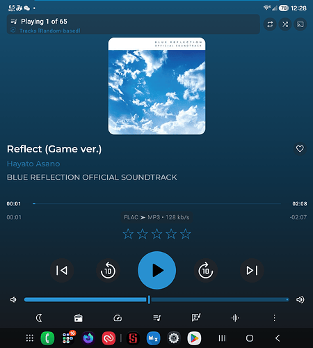

When I enable transcoding by setting a maximum bitrate, the waveform is not displayed and used for smart fade. It is used if there is no transcoding when I set the maximum bitrate to original.
Plex
  1. Go to Playback > Decoding and transcoding
  2. Set WiFi (or mobile) maximum bitrate to any value other than Original
  3. Play any song in the library
cal no waveform when transcoding in plex

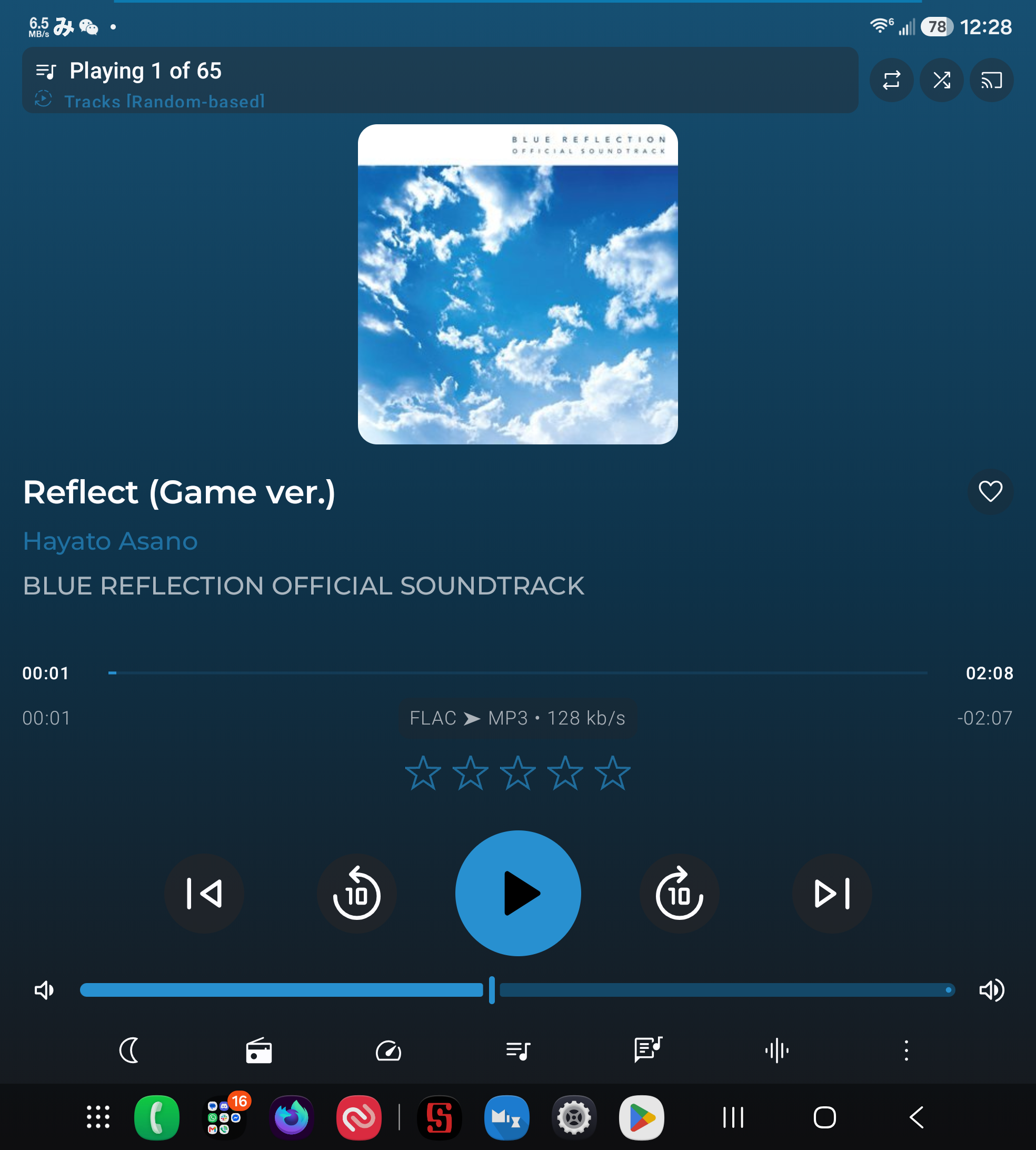

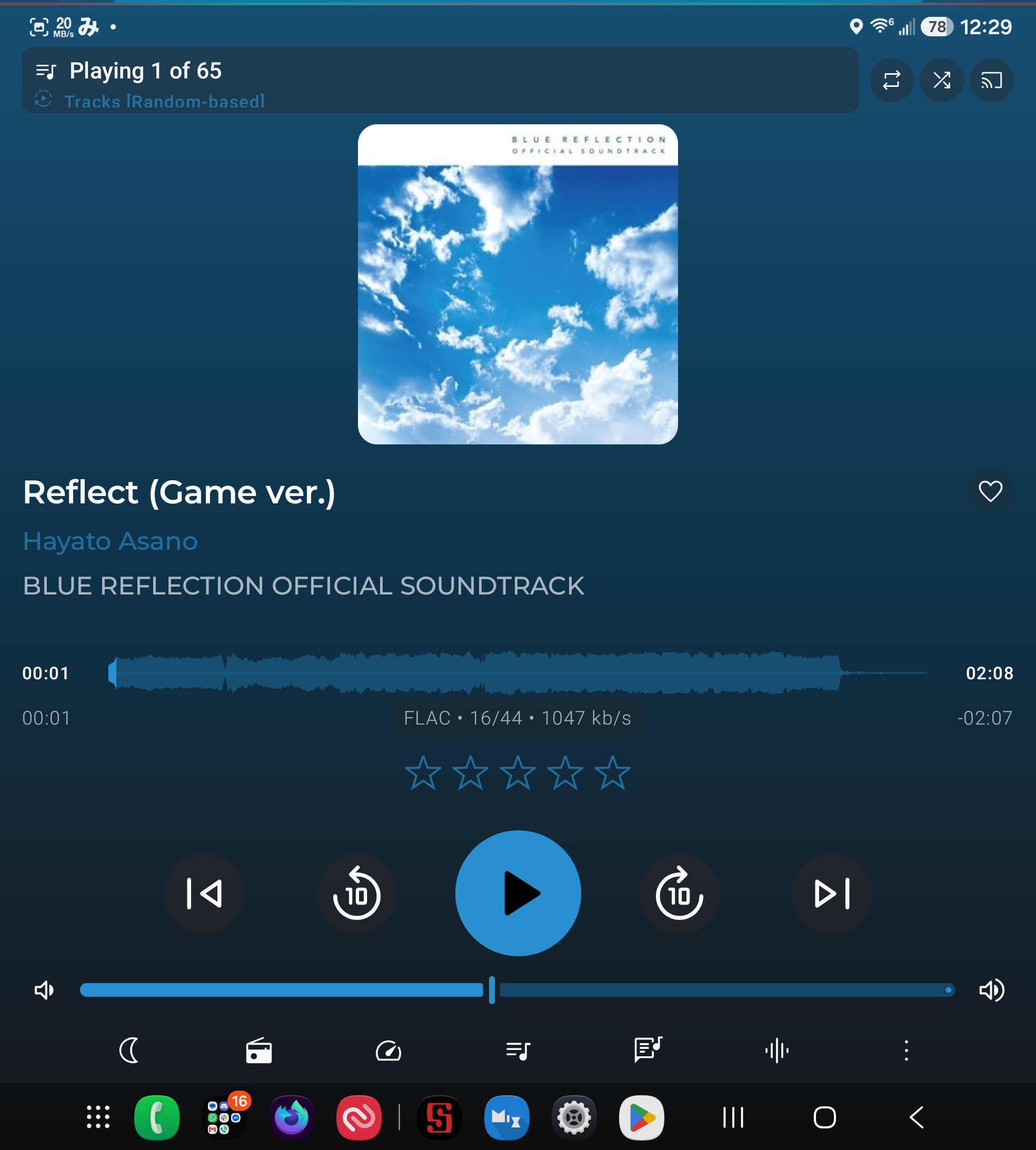

I paused at the same time for both cases with and without transcoding, and did see the waveform without transcoding. So when it’s transcoding, is there something else happening that’s not using the original waveform? Is it recalculating a new waveform based on the transcoded file?
Advanced/Database.
And in the logs for that song you started the media then paused with transcoding before they are extracted. Then you started again without transcoding and after -+2s the data was extracted and then displayed.
If you enable again transcoding for that song it will be displayed.
