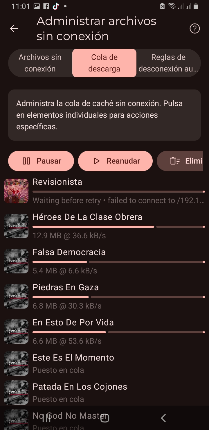

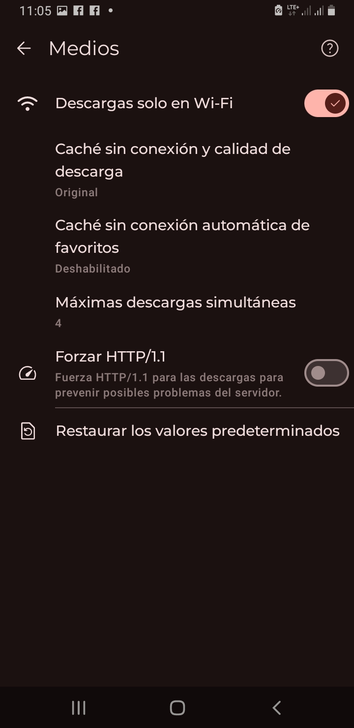

First I cant download my music fast enough, Im trying to download like 2000 songs, but is taking to much time… Two weeks with my computer turned on every day and I only complete the 50% of the download. My Internet connection is 100 mbps, so no problem in that.

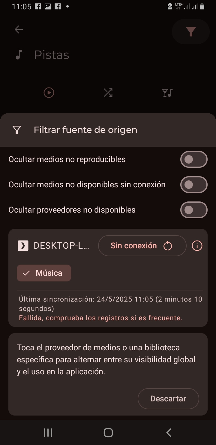

Second problem, when I want to use symfonium outside my LAN network doesn’t connect to my plex server, only work on my WiFi. But I use plexamp too and connect without problem outside my LAN network, I have the port forwarded using the default 32400.

Symfonium downloads as fast as what your server can send.

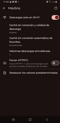

Sometimes more is less so 4 simulateous download can cause issue to the server the default is 2.
You should also check Plex settings in case there’s limits set.
For the outside of network connection you configured the server manually with the LAN ip
http://192.168.1.111:32400
Properly connect via Plex.tv or use an external ip / public dns value.

As I said don’t enable 4 simulatenous downloads it can actually slow things down …
