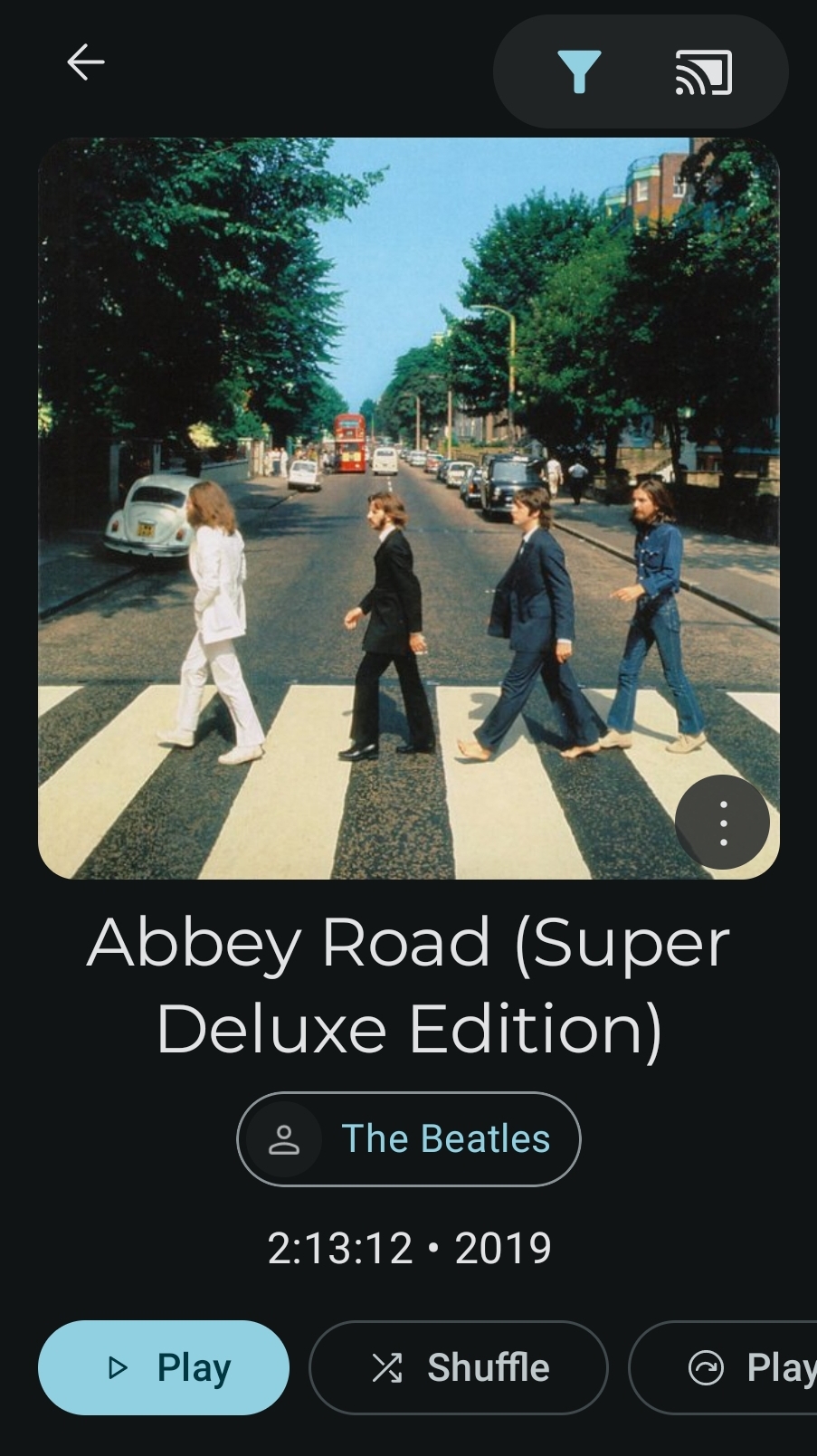

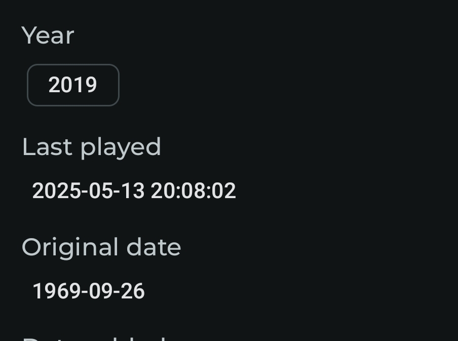

Yea I use picard for everything. They’re tagged correctly, at least as far as mbz goes.
I know we’ve talked about aritst added dates, i don’t think we have about orignal release tags, but i guess i just dont know what exactly to tell lms isn’t being ported over correctly.
As you can see here lms is providing both dates. And symfonium is displaying both dates from lms:

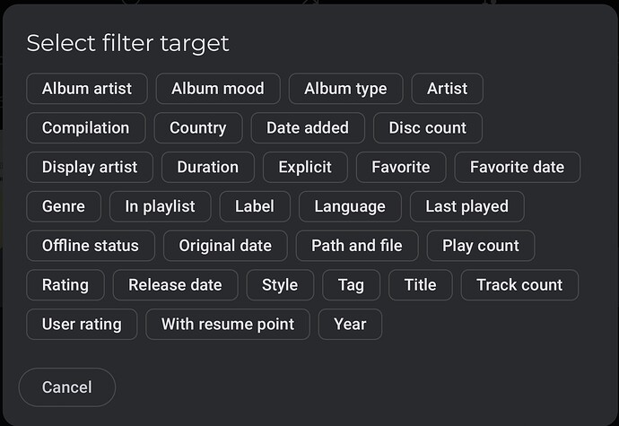

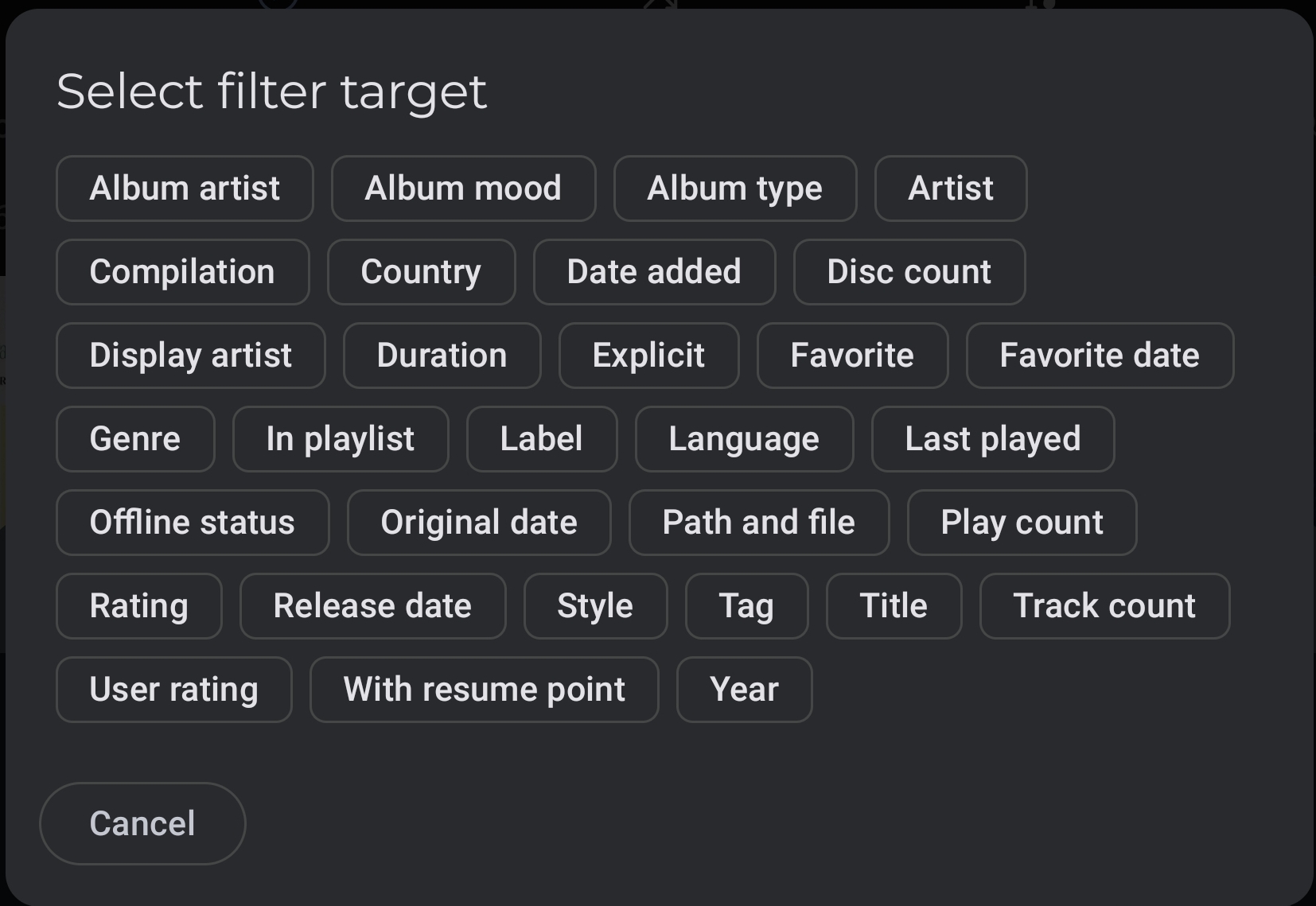

About the smart playlist of course if you use year as filter it will use the year … To use original date filter on original date.
The year field is populated using the date, not original date.
I see navidrome seems to report the year using original date, but only for albums. It uses the regular date field to populate year for tracks.

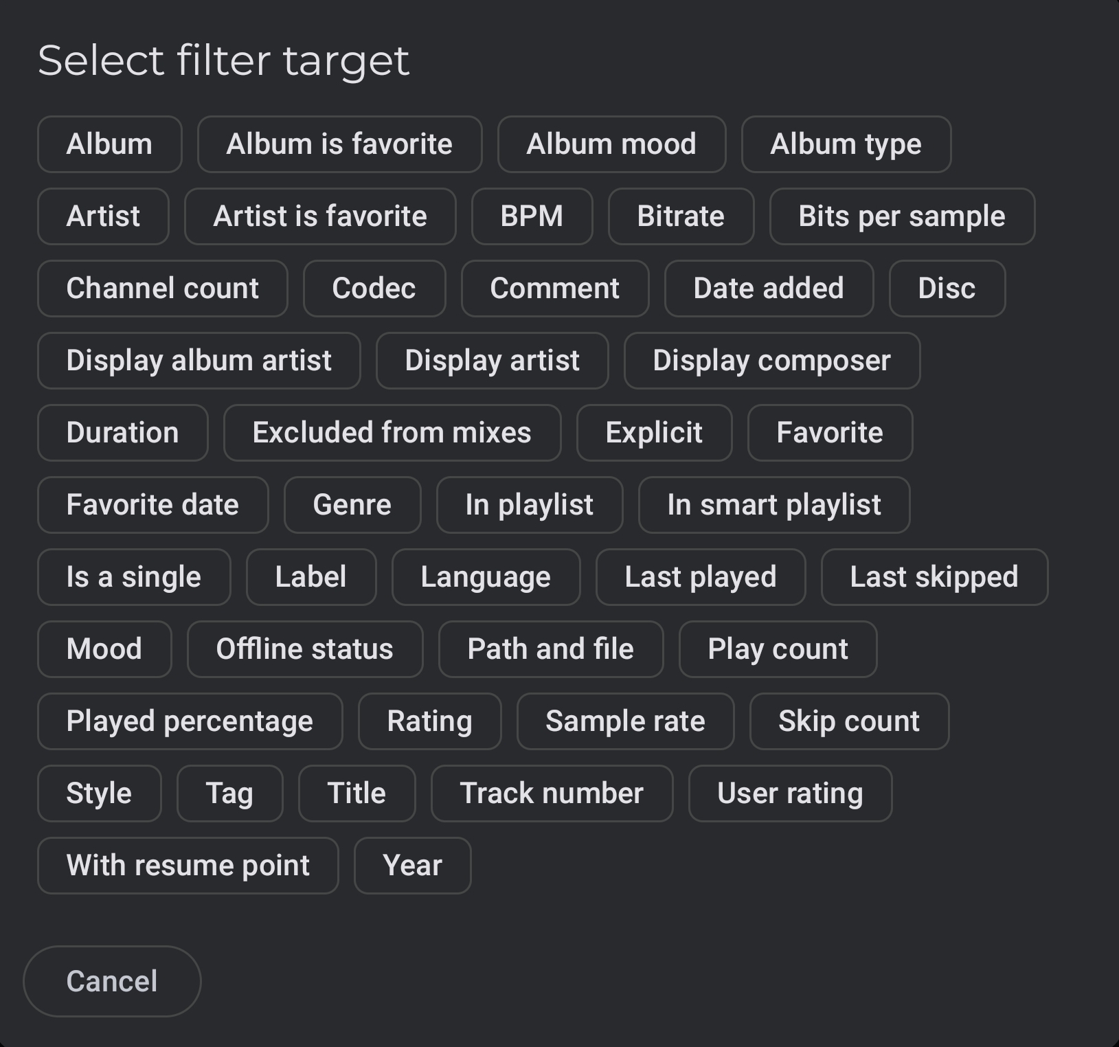

Would it not be easier for users to add original date as an option in smart playlist as well? There are so many other choices, but its missing from it currently:
