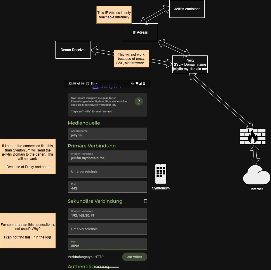

I created a Picture with my not working setup. The Problem here is that Symfonium ignores my secondary Connection completely.
I configured it like this, with primary and secondary connection. Enabled the Debug Mode and tried to play on Denon. The IP is no where visible in the logs. I will upload it again, search for the IP 192.168.30.19 you will not find it. And that is the Issue here.
But: It always tells Denon, connect to jellyfin.mydomain.me. Why does it not use the IP?

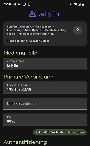

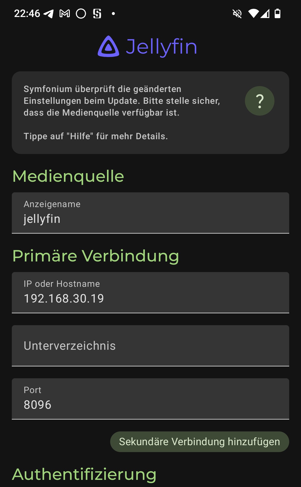

When I configure Symfonium like this, with an IP only scenario, it works seamless. No connection Issues. It simply works.
So, why can I not simply tell Symfonium to use the IP Adress for UPNP Connection? As it simply works. No troubles with Proxies, old firmwares, SSL stuff…
Can you follow my Setup and my thougts? If I was not clear, please let me know what is missing.
Just to be clear I perfectly understand how all works in your case and many others.
  1. Symfonium have no way to know your network topology and know that the Denon can talk to an ip or not.
  2. Symfonium use primary and secondary connection and switches when there’s no connection.
  3. Symfonium streams by using the active connection as it know that it works at that moment and obviously don’t keep testing both ip to optimize battery.
  4. Symfonium have the proxy option to ensure that a renderer can communicate to the server since Symfonium can.
  5. If you are connected to Wifi at work and want to cast, you can :wink:
  6. Google have decided that reading SSID requires precise location permission and that’s not a permission that suits a music application.
So again check your proxy logs to see why when coupled with Symfonium proxy there’s drops …
One easy workaround would be to use DNS views to have the DNS name not working when at home and have Symfonium forced to switch back to the other connection.
I’ll add an API command to force the switch to be used from Tasker or Automate that are the proper apps to read SSID.
