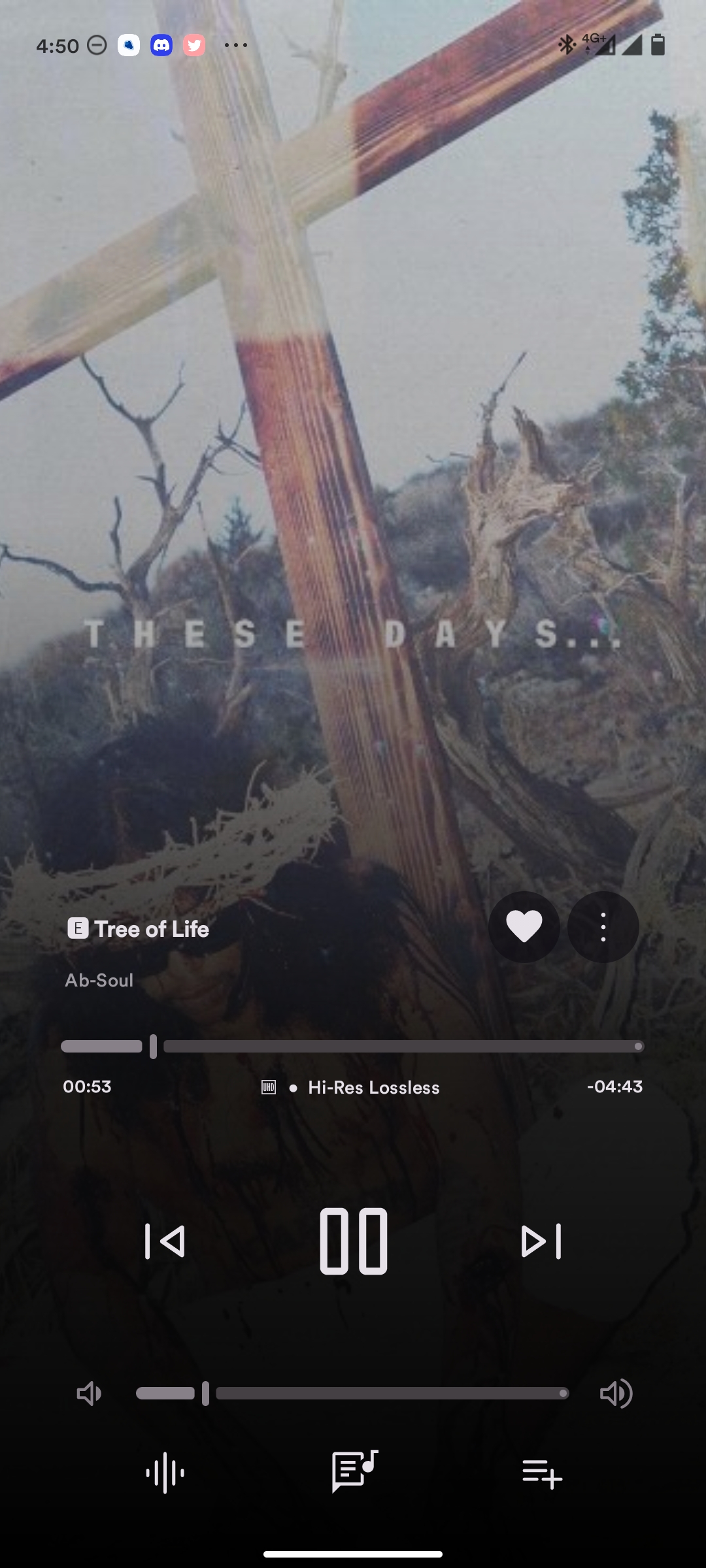

Updates to my now playing screens + new Spotify inspired screen
I’m sure you all remember me as the guy that made the streaming inspired now playing screens. Well updates to the now playing strings and the volume and progress bars have made it possible for me to fine-tune them to look more like the real counterparts. I’ve also been able to create a new Spotify inspired screen. All are below.

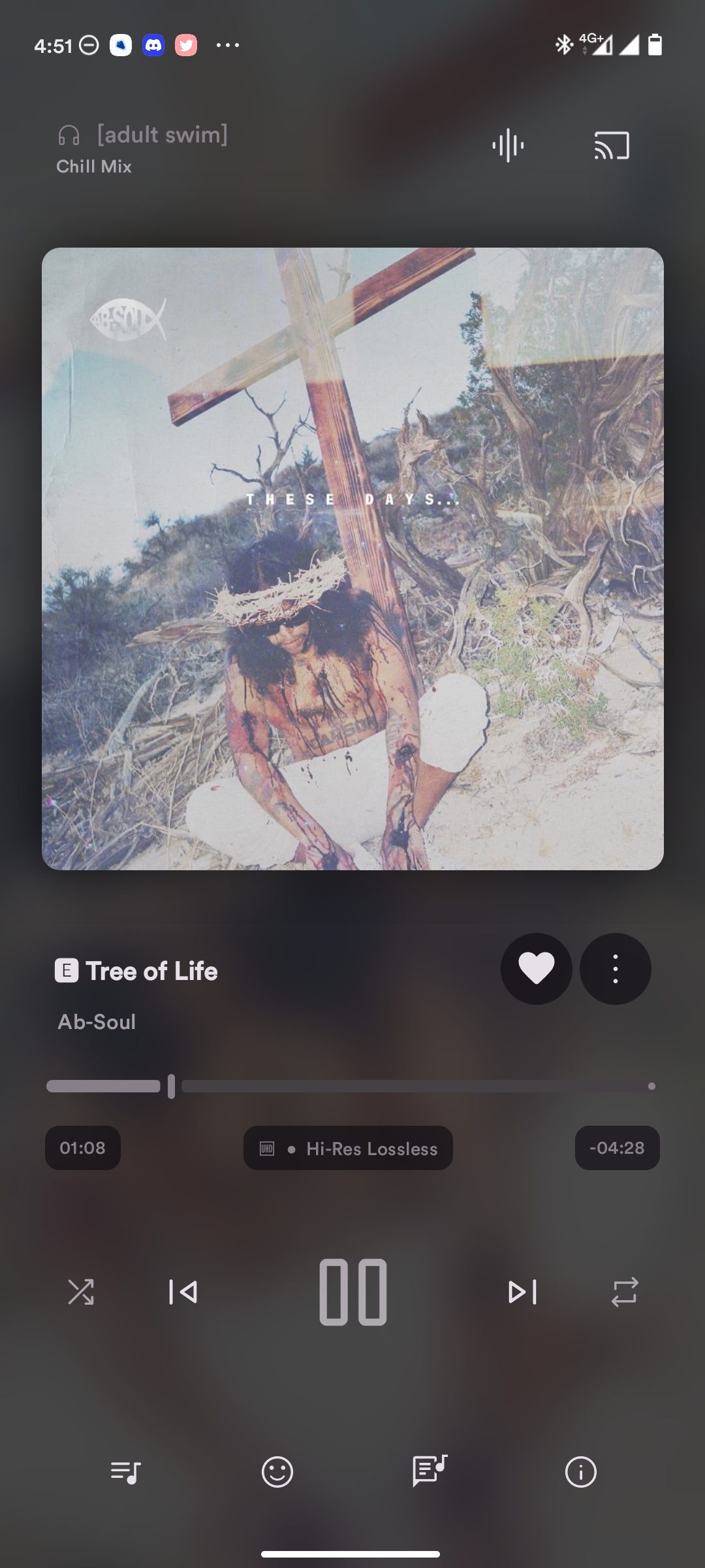

  1. Apple Music regular.
JSON:
nps-Apple Music 3 Button-20250705_044940-symfonium.json (20.9 KB)
  1. Apple Music Full Screen.
JSON:
nps-Apple Music Full Screen-20250705_045001-symfonium.json (20.9 KB)

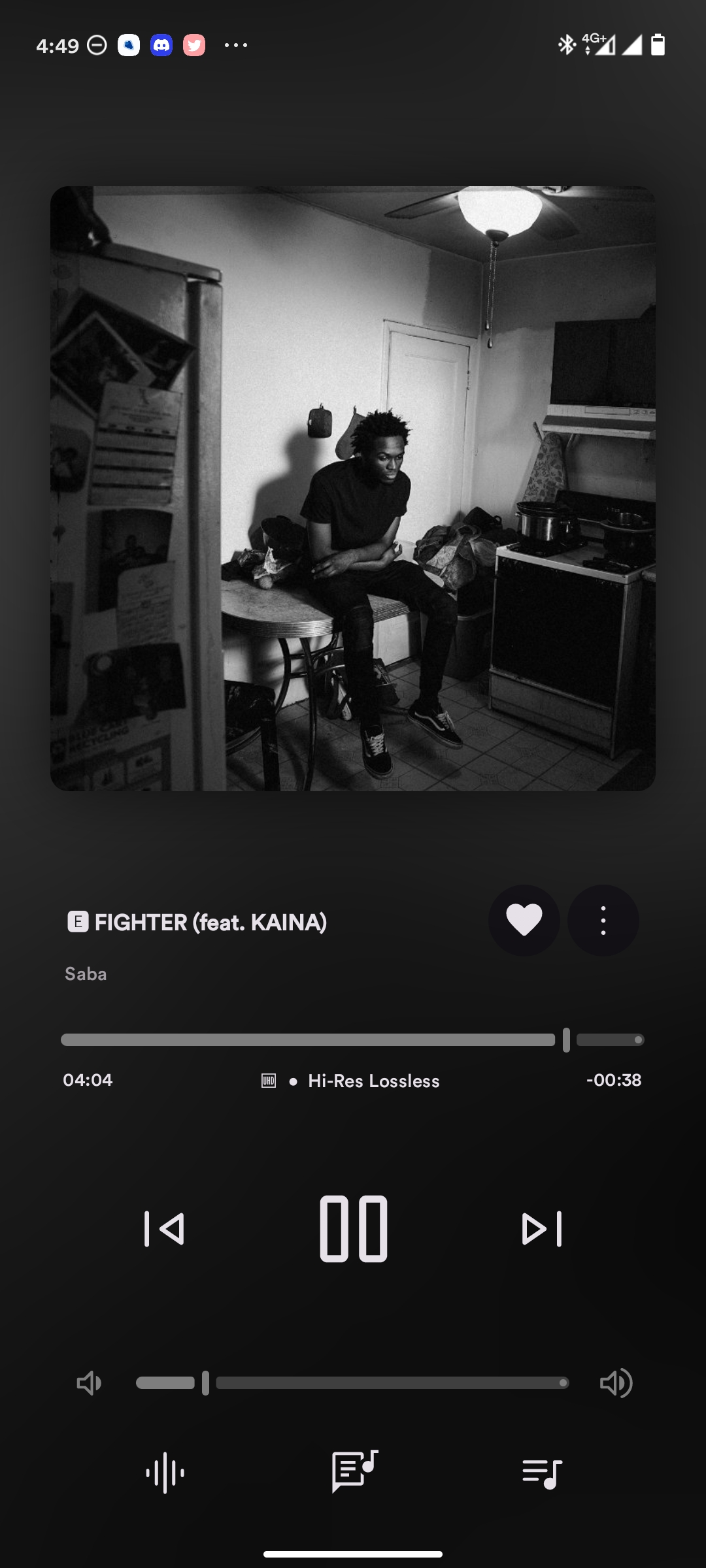

  1. Tidal.
JSON:
nps-Tidal 2.2-20250705_045014-symfonium.json (20.8 KB)

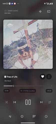

  1. Spotify.
JSON:
nps-Spotify 2.1-20250705_045024-symfonium.json (20.8 KB)
I don’t feel too good about the Spotify one to be honest, I tried and it still looks a bit off to my eye. I’ll update it as the app gets updated.

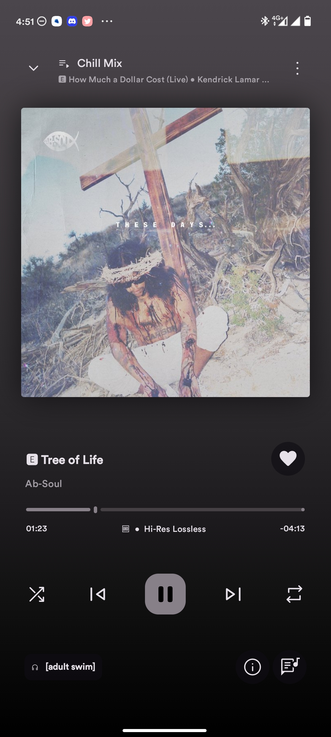

loved the work mate tbh, appreciate the efforts.
just one doubt would be, did you just add a text in mid as “Hi-Res Lossless” instead of adding the actual codec/quality of the files?
Yes cuz 95% of my music is alac or flac and I didn’t want to try implementing a string that would show that where a flac or alac track was detected as I thought it’d be too much work.
fine enough, i actually have 16bit files usually so i was trying to find the icon for “HD” instead of UHD, could you link it where you got the character from?
and one query about the explicit tag, how does the string decide it? cause all my songs show as clean even tho lyrics do have explicit content.
I actually got it from someone’s set up here, sorry
For the explicit tag, the song file itself has to be tagged as explicit

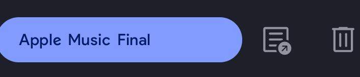

Hey … how am i supposed to export these json files?? cannot find it in the ‘Manage symfonium generated files’ …
Use the button next to the delete icon when you go to pick a style.
