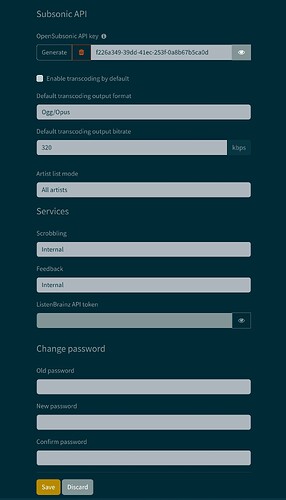

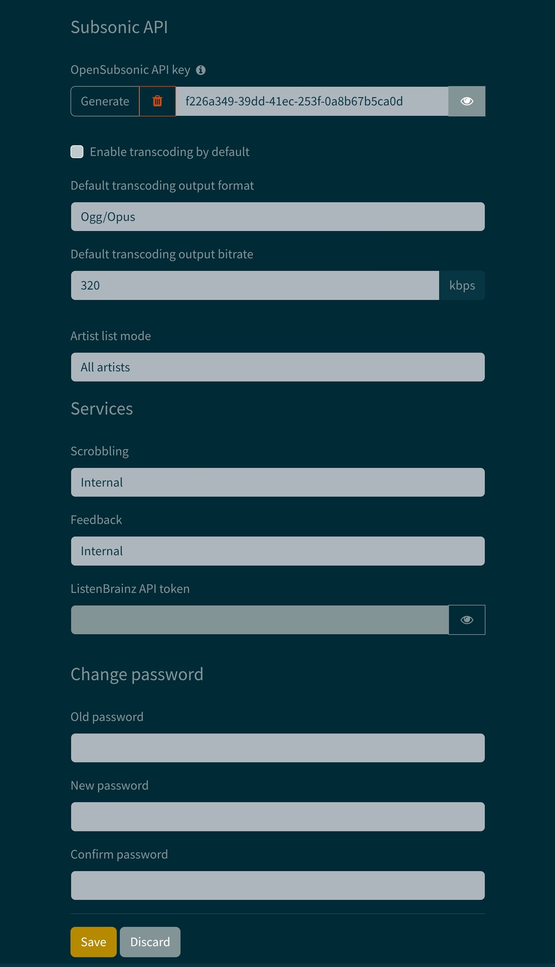

Hey, i updated my lms container today. It was my first time needing to generate the api key. I did, but when i copy it into symfonium it keeps giving me an error about being “unable to get media provider version”
Upload description: Bigmack3000
Screenshots are the matching api keys from lms to symfonium
