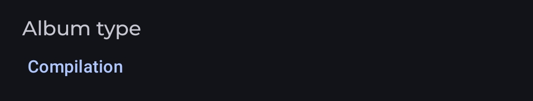

Making the album type “Album” appear in the “About” rows on the Album page
I’ve tested tags to make use of the album type info in the “About” section on the album page. As far as I found out, Symfonium uses the releasetype tag. Currently, Symfonium seems to treat the value “Album” in the releasetype tag differently from other values like “EP” or “Compilation”. The latter two are displayed in the “About” section but with the value “Album”, no info about the album type is displayed at all.
We could make explicitly clear that the currently viewed album is a “normal” album and also directly go to all “normal” albums via the hyperlink.
