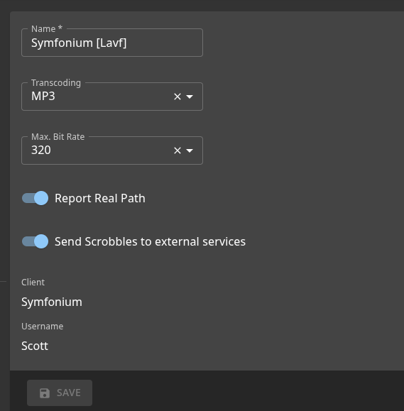

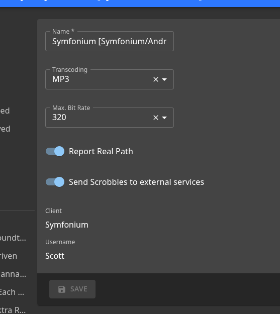

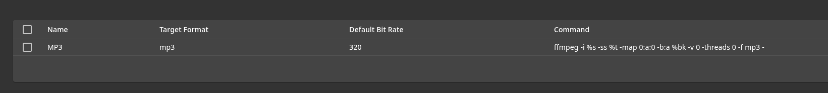

Configure transcode on Navidrome eg:
ffmpeg -i %s -ss %t -map 0:a:0 -b:a %bk -v 0 -threads 0 -f mp3 -
Apply the transcode to symfonium player(s) in the “players” menu.

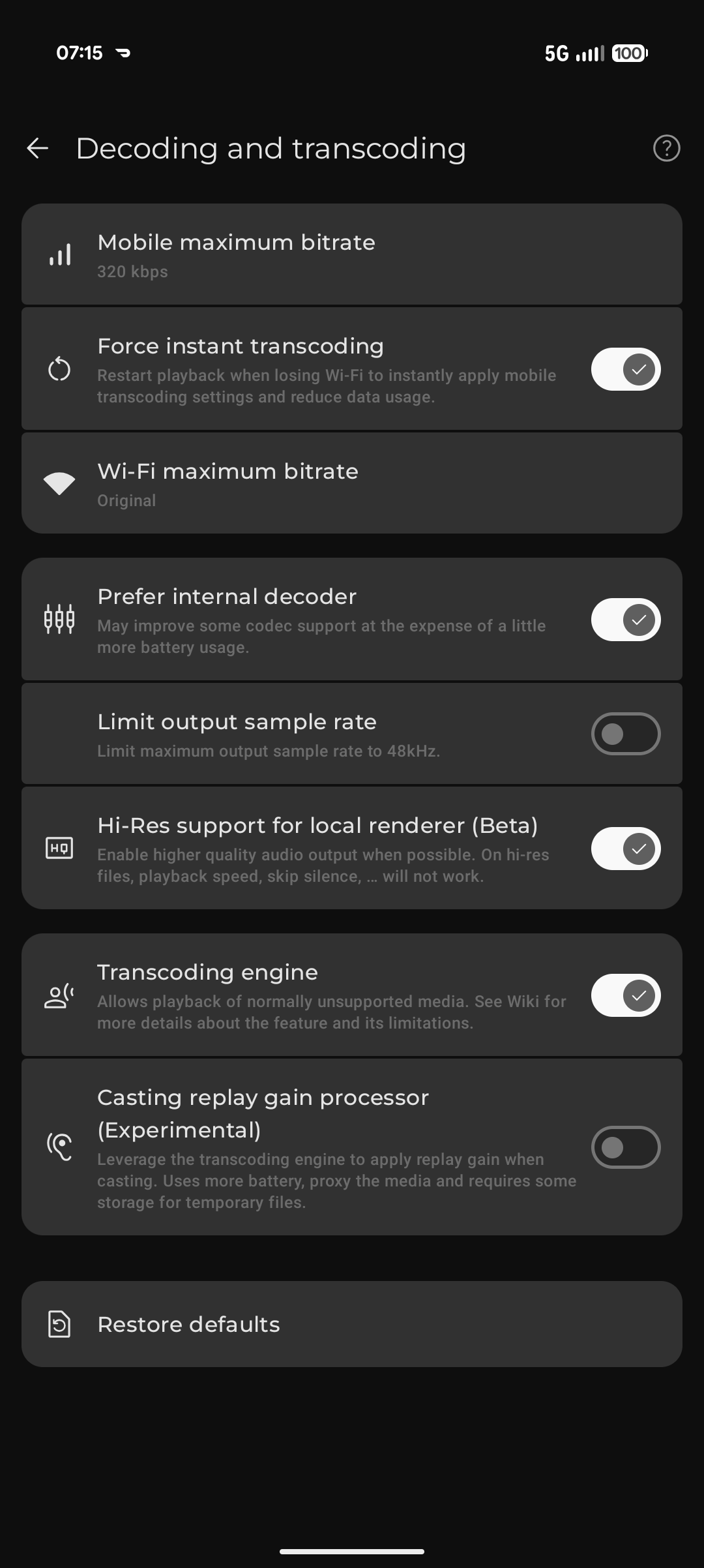

Show your settings

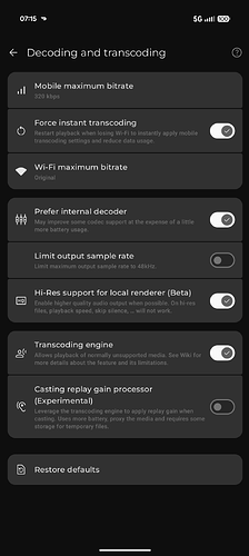

My decoding and transcoding settings. Are there any other settings I should show you?

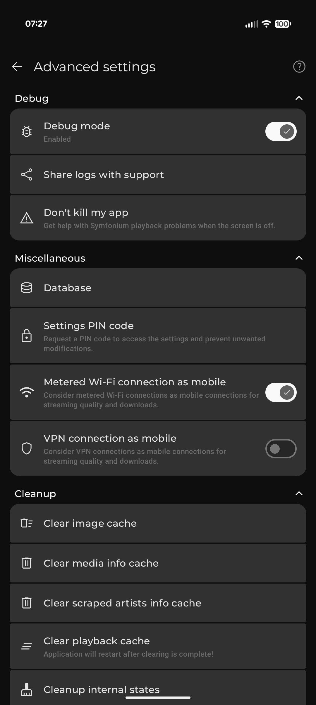

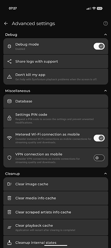

In advanced settings the metered wifi as mobile and the when you are sure there’s nothing forced on server side provide logs.
Nothing forced from the server anymore. I set that option under advanced and uploaded another log collection with my username as the description.

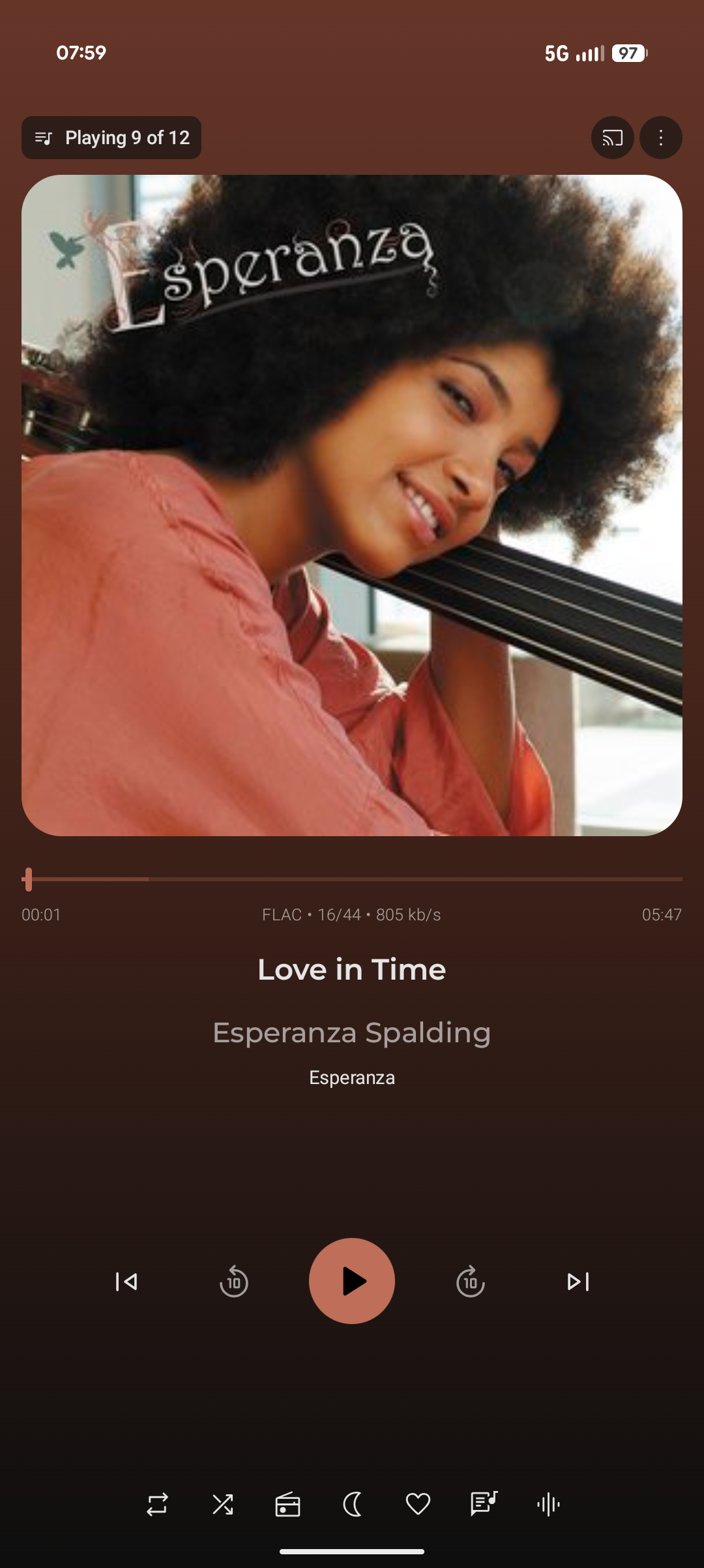

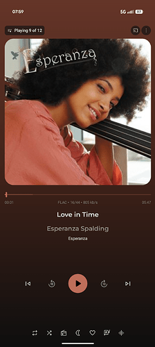

I cleared the media info cache and playback cache and played another song on cell data, and it tells me it’s getting FLAC. My server logs also say it’s streaming the raw file, but that may have been a red herring this whole time if I shouldn’t be worried about server side transcoding.

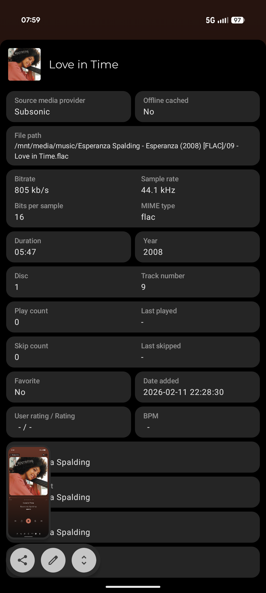

It’s the media info on the playback screen that’s throwing me off in addition to the Navidrome server logs.
time="2026-02-18T07:59:11-05:00" level=info msg="Streaming file" artist="Esperanza Spalding" bitRate=0 cached=false format=raw originalBitRate=804 originalFormat=flac requestId=navidrome/2W6IlnebxM-012207 title="Love in Time" transcoding=false user=Scott
If you do 3 dots and details then yes it will check the data of the actual file not what is currently playing and there will be a line in the server side about it.
The now playing should not according to logs.
