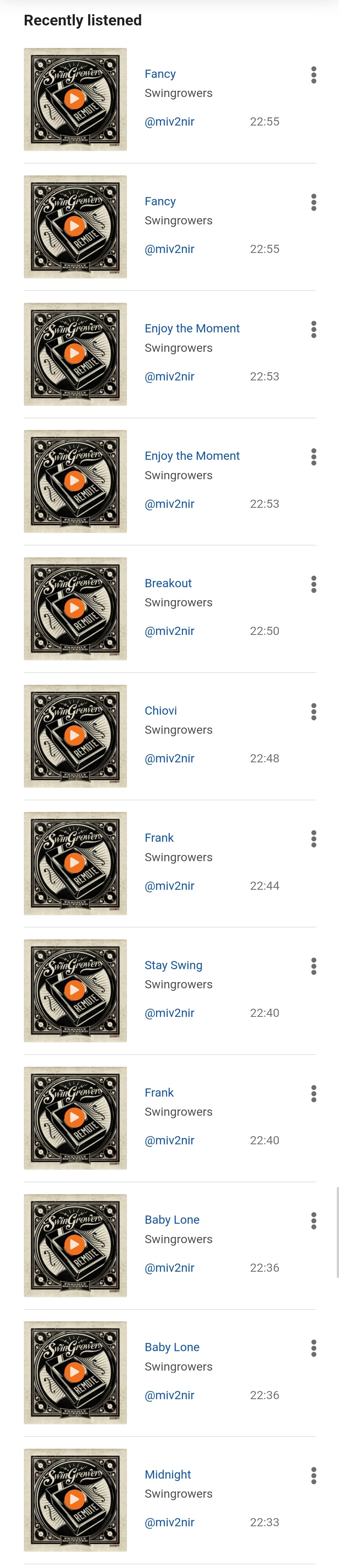

Whenever listening to an album or playlist it seems like sometimes it just logs one track listen as two now.
debug-20231109_225650.zip (346,8 КБ)
Every distinct track on this list I actually listened to once, not twice.
This issue seems different enough compared to the last one I opened, so here goes.
Also this seems to be happening more when I skip forward after listening to 50% of the track so it still logs the listen.

Seems you have set the value to set played at 50%.
So you mean you reach 50% then press skip forward before the end and it triggers the 2 count ?

Yep, precisely that!

Ok so yes there’s a small possible race due to the low 0.5 value you use. And since the new beta have a better handling of multiple playcount report this triggers.
Will be fixed in next release.
