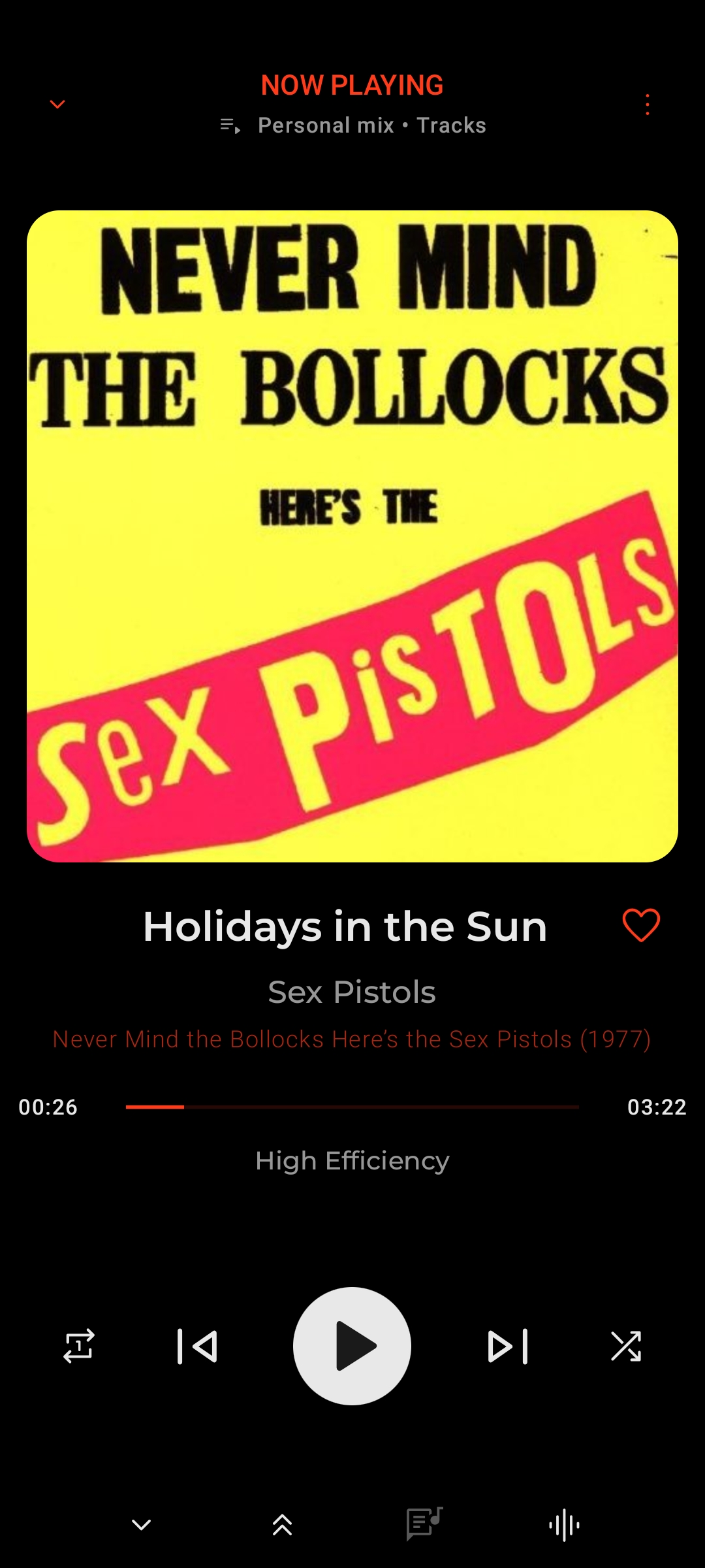

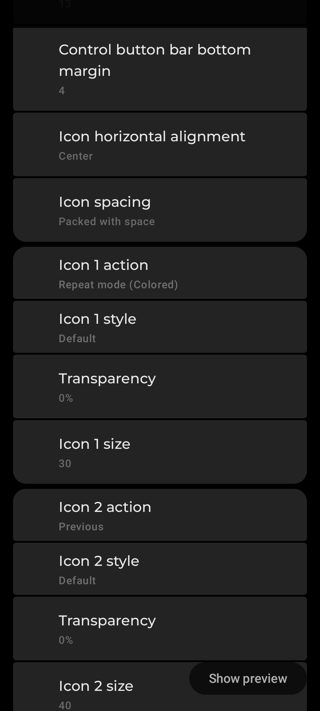

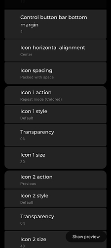

Although the shuffle and repeat buttons are set to “colored” and “default,” they both remain white at all times, making it impossible to tell when shuffle or repeat all is enabled.
- Set Icon 1 Action to to repeat mode (colored) and Icon 1 Style to default
- See in player how the colors don’t change
I’m using a theme adaption from N-thing player

This should be an issue with the theme’s chosen colors, not with the app itself.

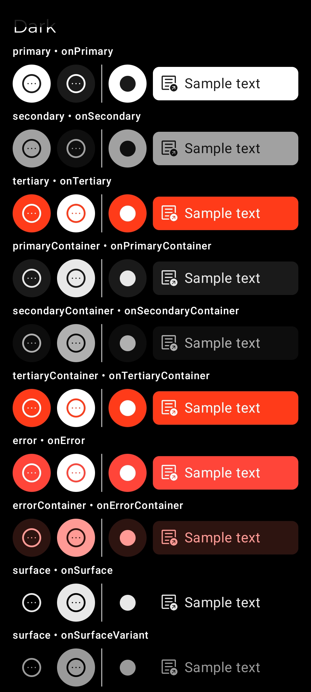

The “colored” style buttons change to the Primary color when toggled. Judging from the white Play button, I assume the Primary color is white… Meaning the “colored” buttons change from white to white. Which is why there is no visual change.
To fix this, you can do any of the following:
- change the Primary color for your theme
- enable “Adaptive primary color” in NPS settings
- change the style to “Theme tertiary container” (and set your theme’s Tertiary color to something other than white). This color will be used when the mode is disabled and Primary color (white) will be used when enabled
- use the regular, non-colored version of the Repeat/Shuffle buttons.
Note: the color used when the mode is disabled is the “on Surface” color for your theme. You could change this as well but that slot affects the text color for the majority of the theme, so it’s probably best to do one of the other options above.
