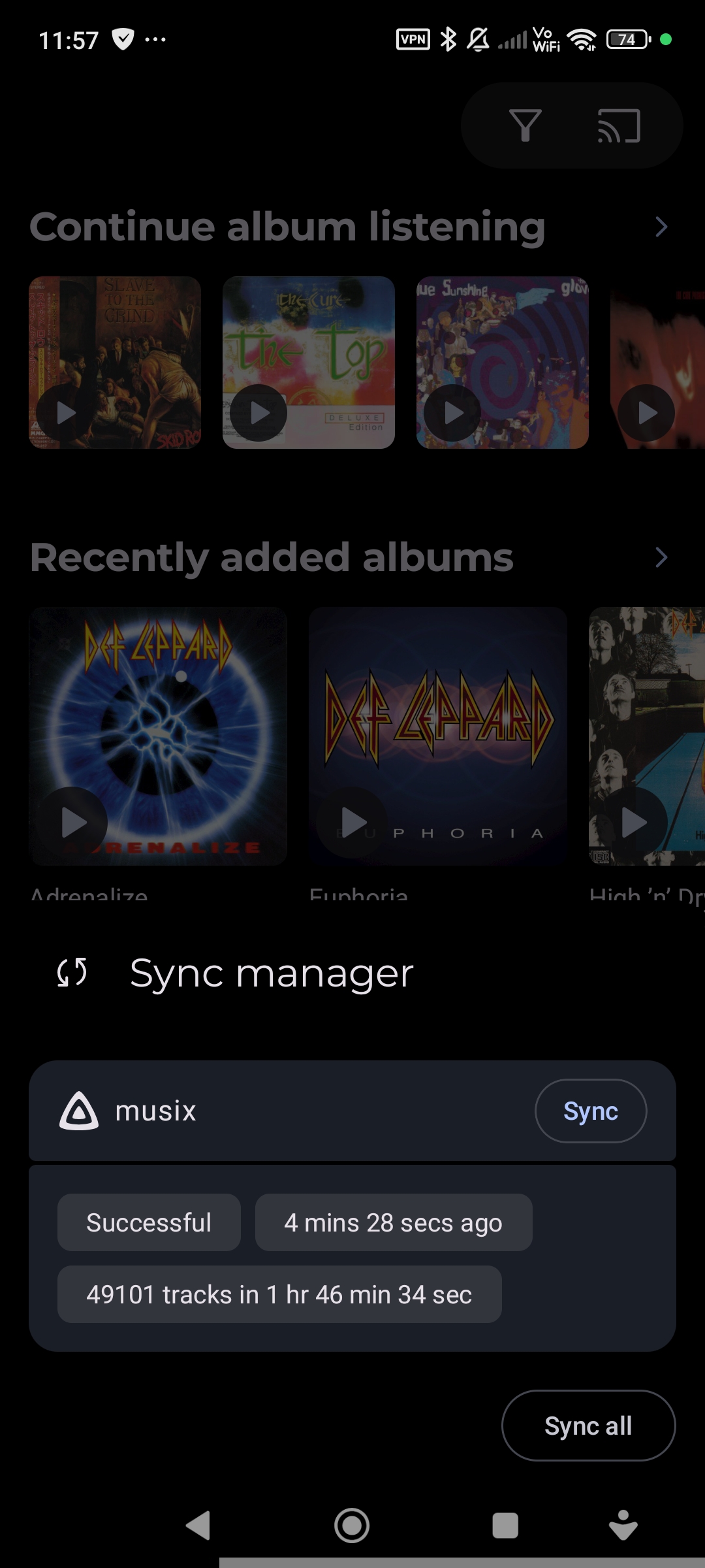

Edit: the sync finished after 1h 46min
Upload description: davdenic davdenic2 davdenic3
sync manaeger says:
Artists: 3302, Albums: 3077, Tracks: 14066 (and counting since it’s syncing right now, if I rember well the last time was around 40k tracks.

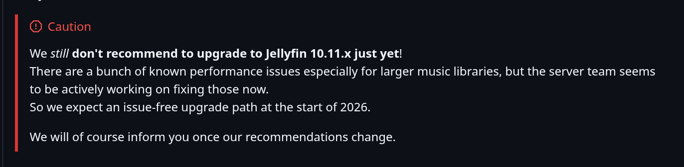

BTW about downgrading in the Jellyfin documentation I read this: Jellyfin does not have a downgrade mechanism. This is very important to understand; once your Jellyfin instance has been started with a new version, any pending migrations are immediately applied, and your Jellyfin data will no longer work with the old version.
