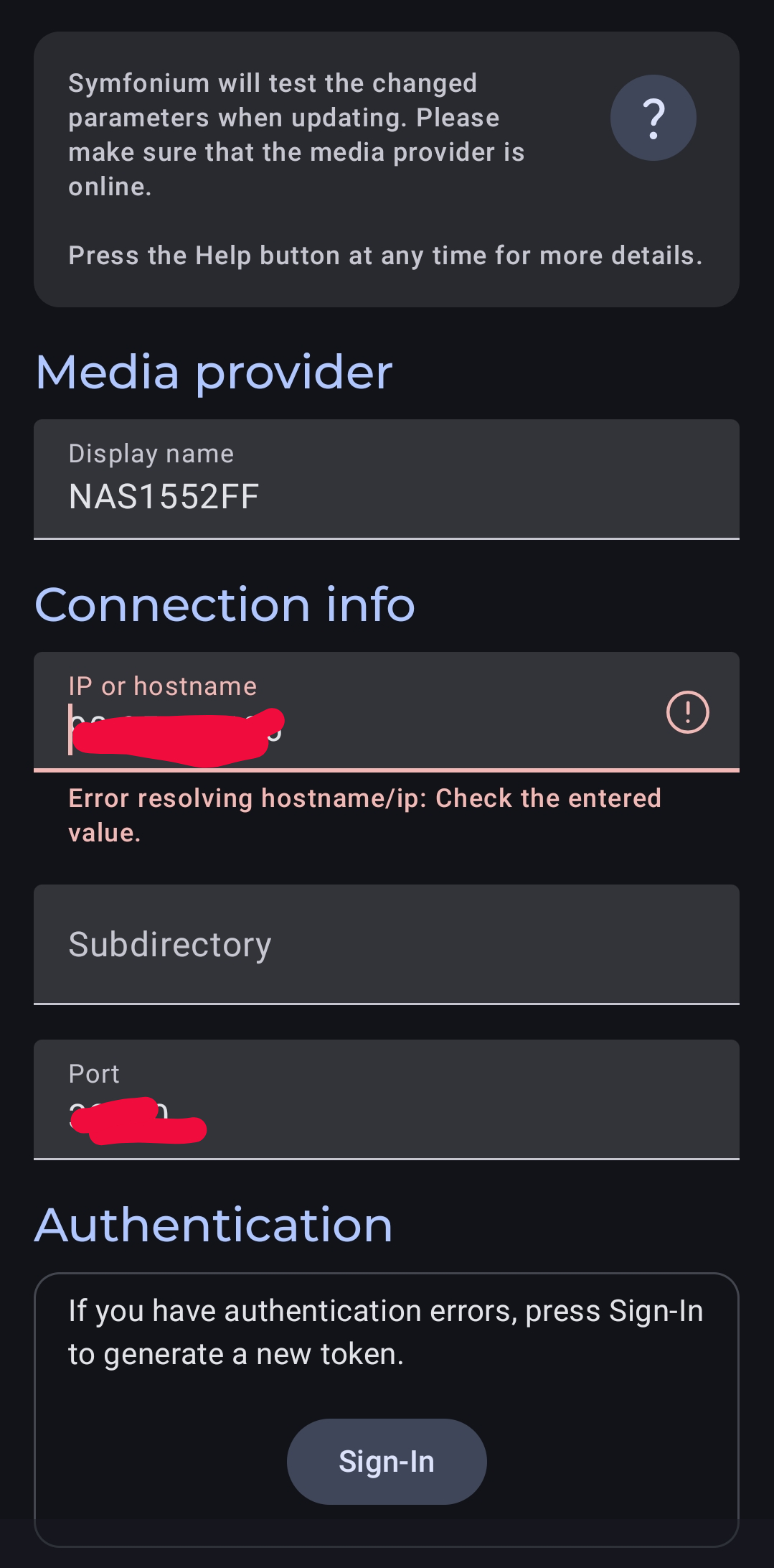

I use my public IP address and it has always worked until recently. Now it has stopped working whenever I am connected to data/LTE.
It still works on my local WiFi.
It sees the NAS as offline, even though it’s online.

Sadly, it does not work. I tried using directly the IP. It only works with the local IP inside the local network. If I go outside the network and try the external IP, it does not work. I checked the port and it is forwarded correctly.
Then it’s actually probably not :wink: Reboot the router ? Open the port and ip from chrome and see what happens ?

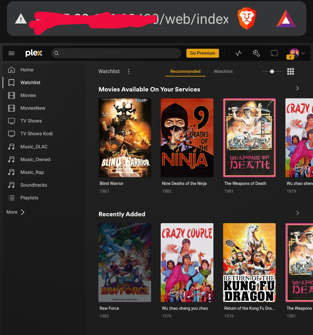

Opened the port and IP from Brave from my phone.
It works. So it’s symfonium-related.

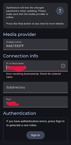

Tried adding it as a separate provider. Log labeled indru-2.
Still failed.
For your manual attempt
2026-06-16 20:23:10.759 Error PlexTvUtils Error during request: 401 / {"error":"Invalid email, username, password or verification code."}
For the Plex.tv :
2026-06-16 20:23:39.249 Error PlexLogger Error (0/0): Unable to resolve host "90-95-xxx-xxx.158a5db6d96d427cccc.plex.direct": No address associated with hostname
If you can’t get your dns to resolve the plex.direct ips there’s not much I can do. Check your dns servers and configuration.
