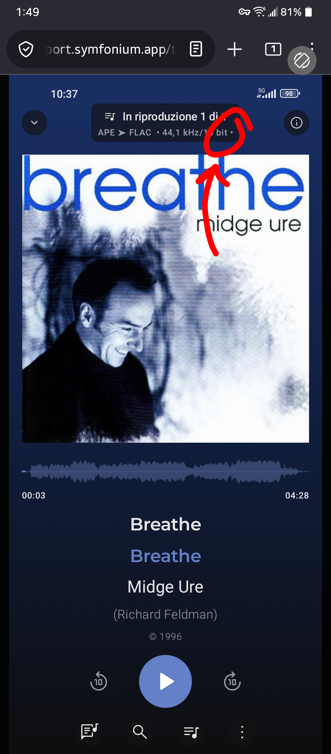

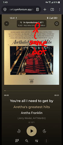

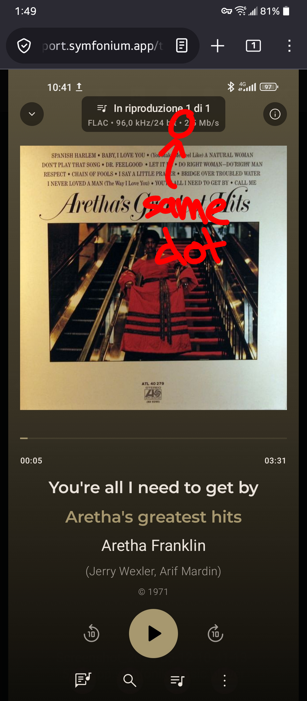

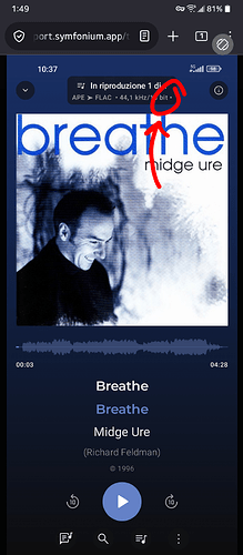

Taken from your own pics, see this dot at the end?
It’s the same as this one.
The info is there, it just doesn’t fit.

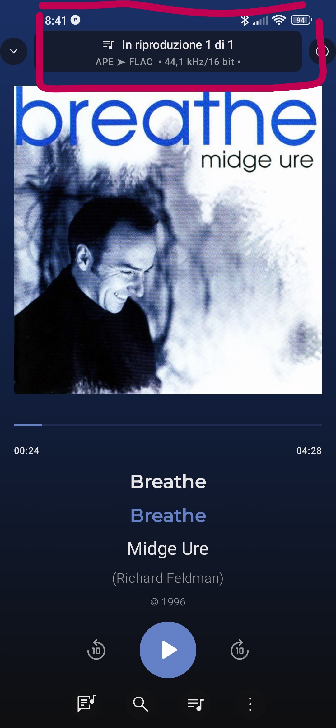

I tried to do all you said: I reduced the horizontal margin till 0, I tried to fullfill the top bar e set to marquee the text ellipsis, but I still get the following:
Maybe since for the other lossless file that they are not flac or wav it visualizes APE → FLAC or WavPack → FLAC it has not enough space?
Why not just write APE or WavPack for these audio formats?
It definitely looks like there should be enough room now. I guess you found an actual bug! Congrats :laughing:
