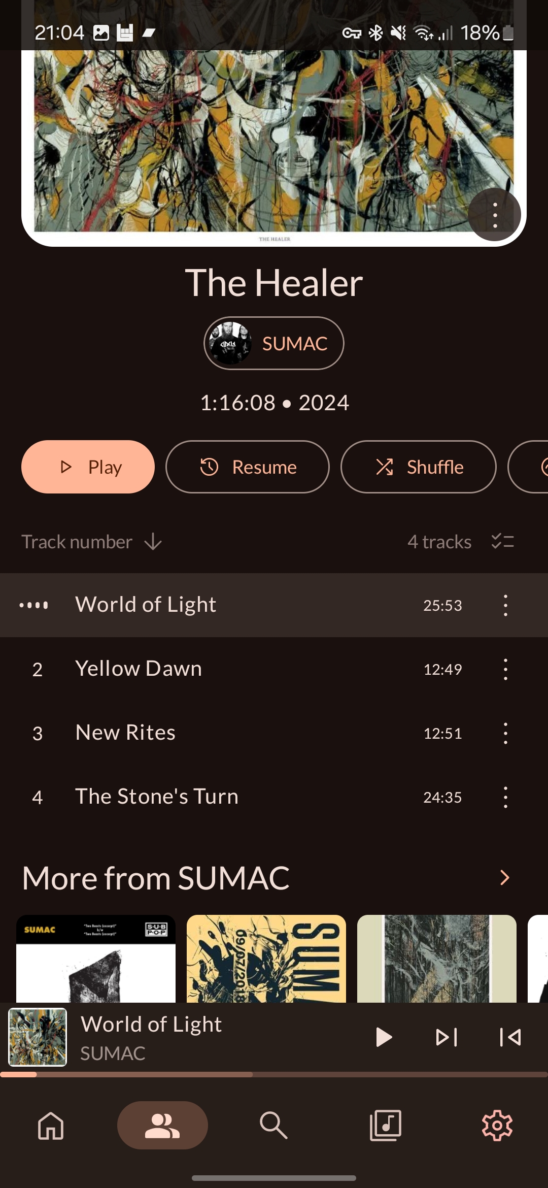

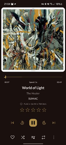

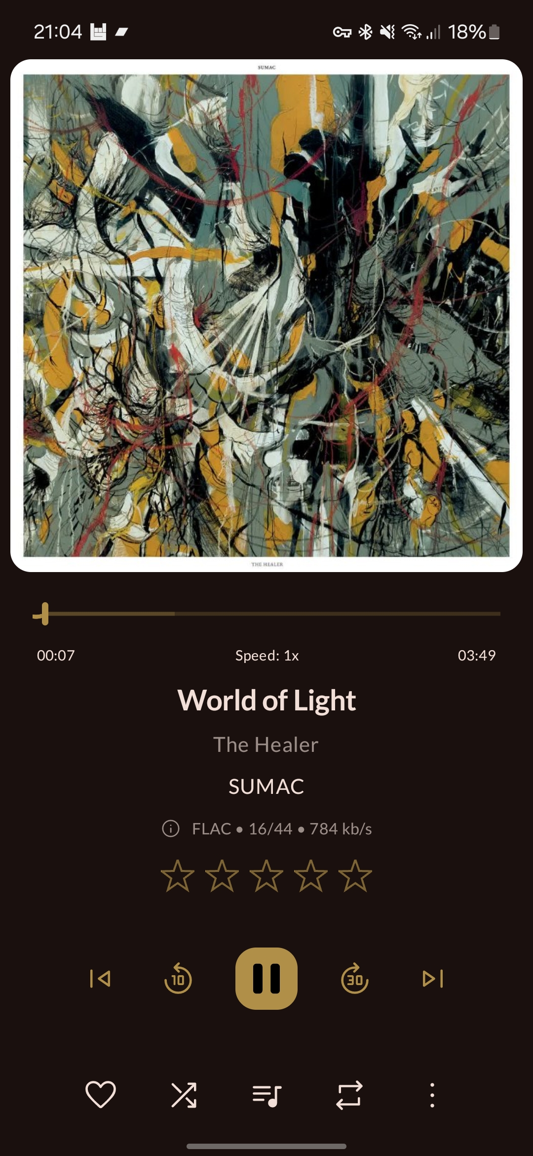

I’m having trouble with longer audio tracks. Some tracks often over 10 minutes Symfonium doesn’t play them all the way trough, instead the track restarts after playing a couple of minutes of the track. On one occasion Symfonium presented a track that is 25 minutes and some seconds long as a 3 minute and some seconds long track.
