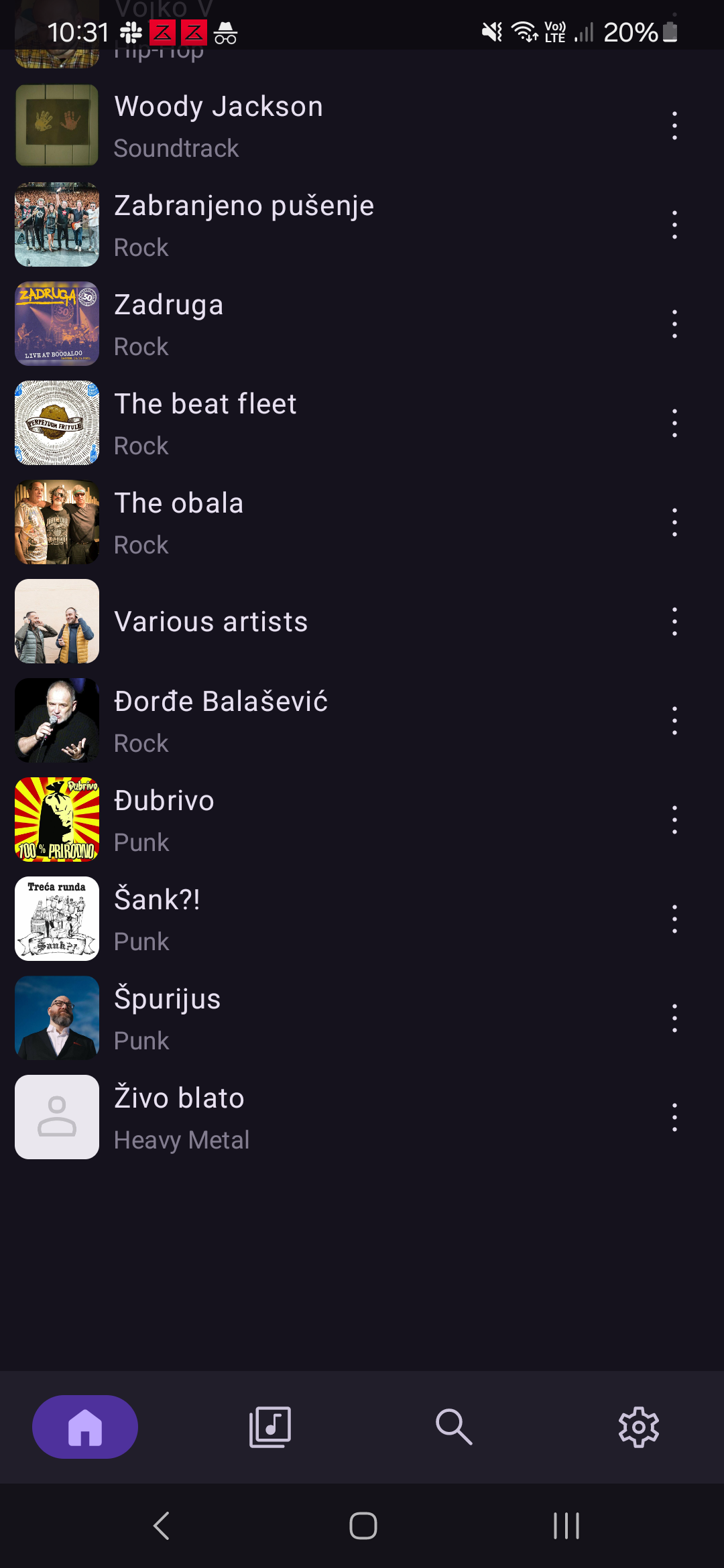

Hi,
I have been using Symfonium for a while and it’s been great. However, one issue I’m having is that the sorting by name of album artists, tracks and so on, does not respect letters with diacritics. Those are placed at the end of the list. “Use ASCII sort” option in settings is disabled, but enabling it does not change a thing. I’m providing a screenshot to demonstrate the issue.

On the homepage, I click on “Album artists” or “Tracks” at the top.
I can see the sort is set to “Sort name”, “Ascending”, yet the relevant names are at the bottom of the list.
Same goes if I go into library and then browse the remote files directly.

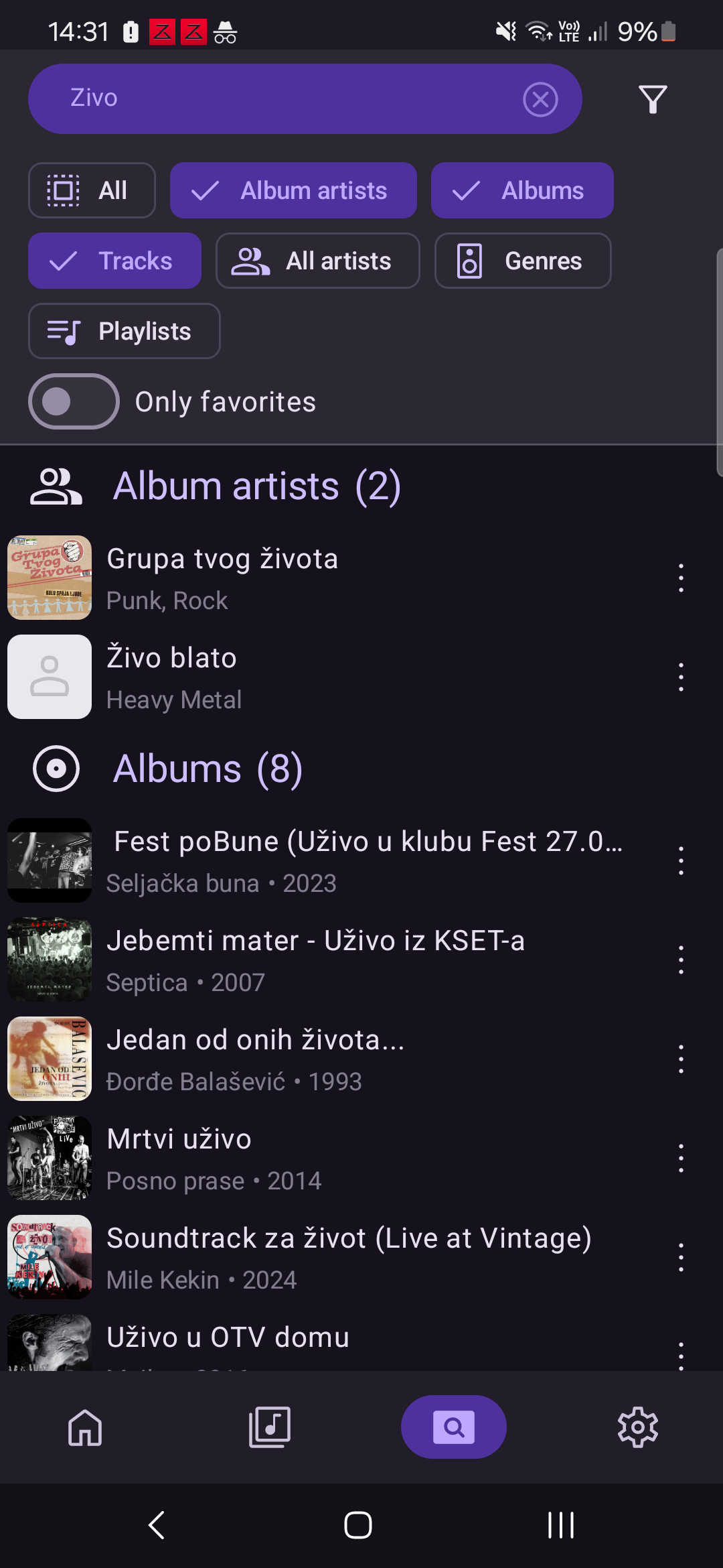

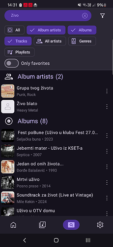

Does search for Zivo find Živo blato ?
Yep
