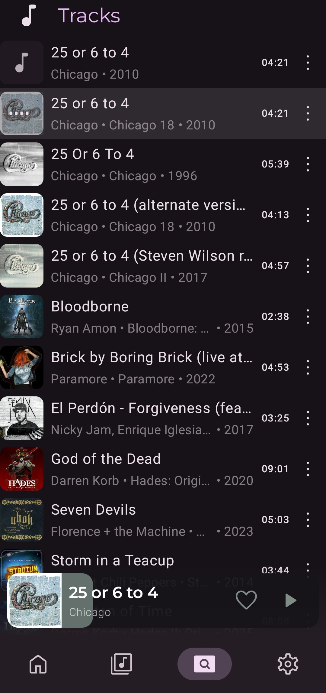

When searching for a particular song, occasionally two versions of the song will appear in the search results. This blank result will have the title, artist, and release year of the song, but will not have the name of the album or an album picture.
Selecting this blank entry in the results will play the next song in the results — which is usually the correct song — however, the presence of this blank entry throws off the order of the other results. To play to correct song, you have to click on the blank result. If you click on the fully populated result, it will play the song that appears below it; and so on and so forth until you click on one song in the results and it plays a song six entries below it.
In the attached images, the image depicting the search results also shows what happens when I clicked on the first result. It played the entry below it.

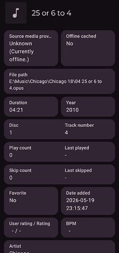

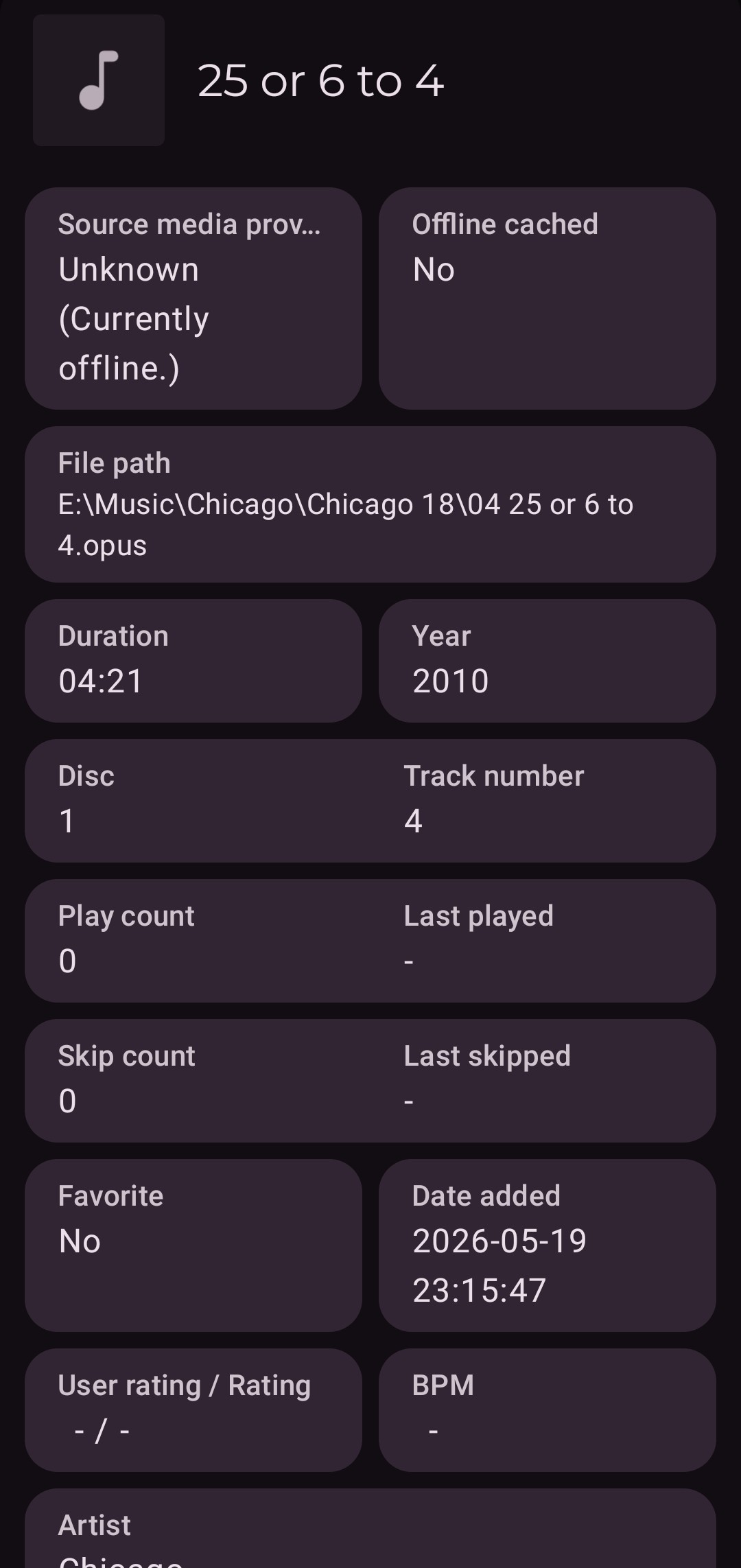

When inspecting this unpopulated entry, it claims that the, “[Unknown] media provider is currently offline”.
