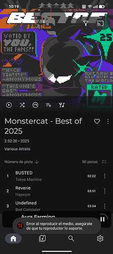

Song plays through web server, but not on Android Symfonium
I recently bought an Album on Bandcamp and i’m having problems reproducing it from the Navidrome server to Symfonium on Android. The server is running on Ubuntu laptop.
Using Navidrome on the web works without problems, audio reproduces.
Sending the files locally to the phone and adding the local storage as media works and can reproduce the files.
Reproducing the files using Symfonium through the server does not work, the tracks, metadata, cover loads… The files can’t be reproduced or downloaded.
Tried to go through the log files but can’t really see the error. With my tests i assume that the FLAC files are OK and the format is not the problem.
Any idea of what can be blocking the reproduction of the file from the server to Symfonium?
Thanks!
Upload description: Songs related to “Monstercat” doesn’t reproduce directly from the server but they will load metadata. File can be open locally from device and through web interface on the server. All other songs on server work properly.

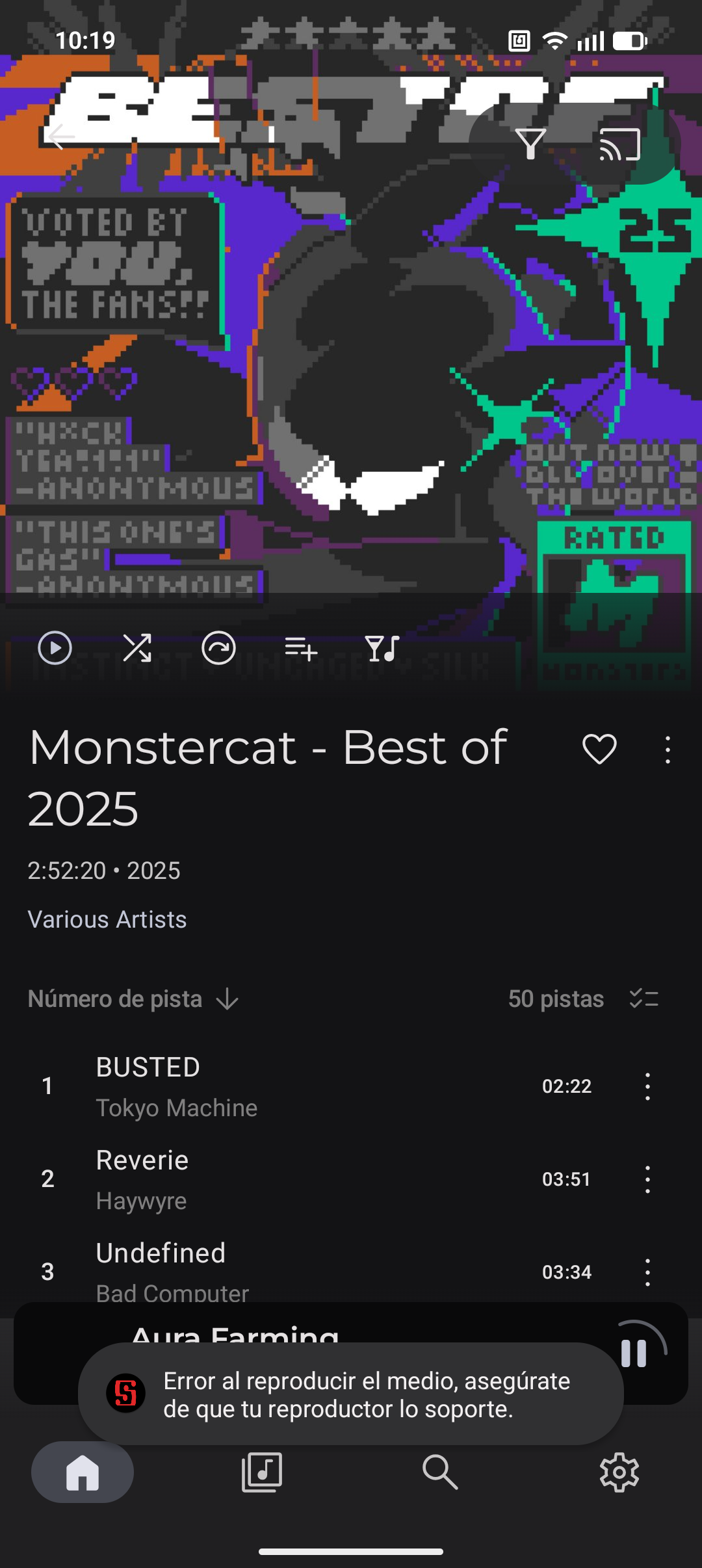

On the image, the Symfonium error says: “Error reproducing the medium, make sure that your player supports it.”

On the Symfonium app i see lots of “Error no valid format to extract amplitudes“, “ERROR_CODE_PARSING_CONTAINER_UNSUPPORTED“, “Error/AudioEngine/1: onPlayerError: 3003 - Source error”.
But the format should be fine because the same file works locally and the server is also able to reproduce the file via web browser interface.
