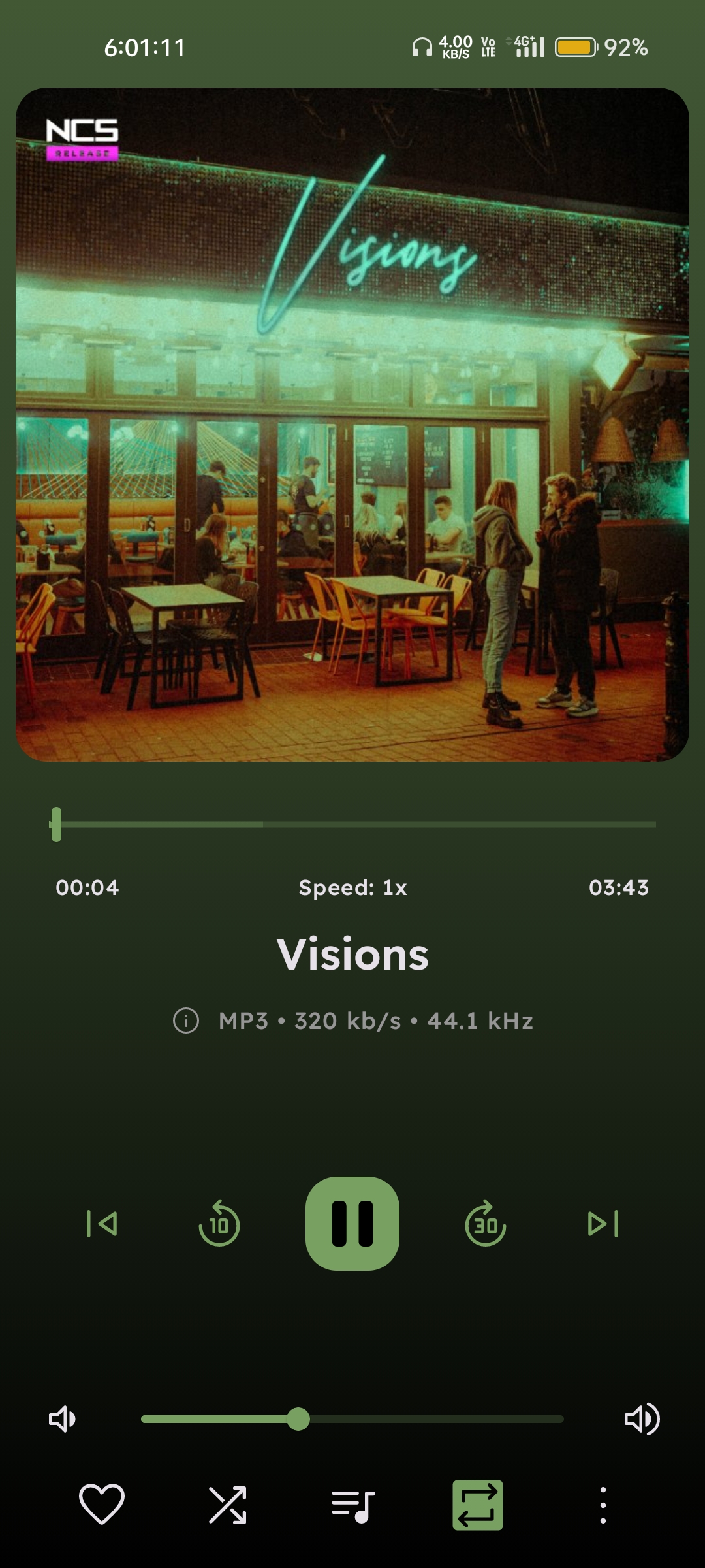

When I start playing a song from a playlist that I created from a queue, the artist name is missing from it. The file does have a artist name like other files. Sometimes, it’s consistent like multiple times but sometimes it does show the artist name. Just wanna know if this is a device bugging or with the app.

2.) Song starts playing but artist name is not displayed.
Box
Here you can see that the artist name is missing from the song. Do let me know if you need more debug logs if this one didn’t catch it. I’ll be happy to help.

Hum the song are properly mapped that’s strange.
Can you try to rotate the device to see if it’s a display issue?
Then try to make a video with a full repro from starting the first queue, creating the playlist and then starting it with the correspondng logs.
Uploaded logs again, check and let me know if it works.
I tried rotating the device but still doesn’t show artist name.
Also this only happens when I play from the playlist not when I manually select and add them to queue.
