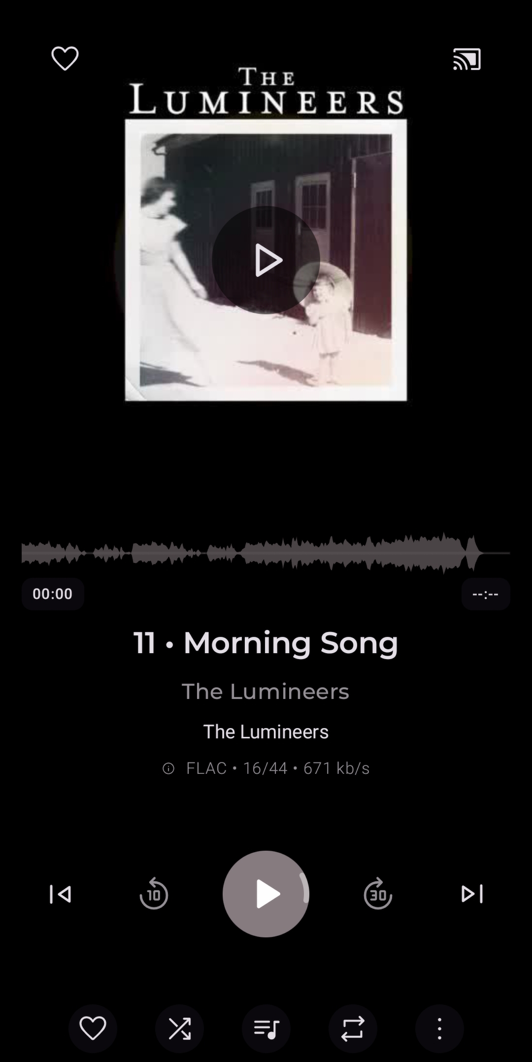

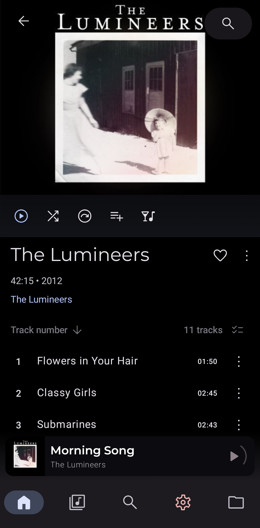

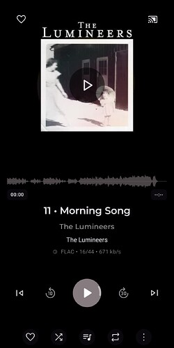

suddenly my symfonium has this issue: the last song in a album or in a search get stuck and does not play.
this happens only when casting directly to my denon x3800h HEOS, but not when play on local device or cast to wiim device.
It happens in all the following situtaions i’ve tested:
  • playing the full album when it reaches the last song
  • or just clicking directly last song in any album
  • if I search a song in the search and play the last found of the results
  • if I play a playlist last song
  • if i play any other song it works, until it reaches the last song then it stuck as before mentioned

Issue solved: disabling the UPnP gapless support solved the issue
  1. click on the cast icon
  2. on the list of devices click on the gear icon near Denon AVC-X3800H
  3. disable “UPnP gapless support”
