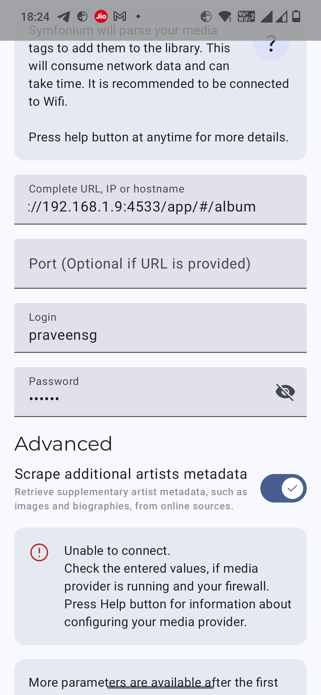

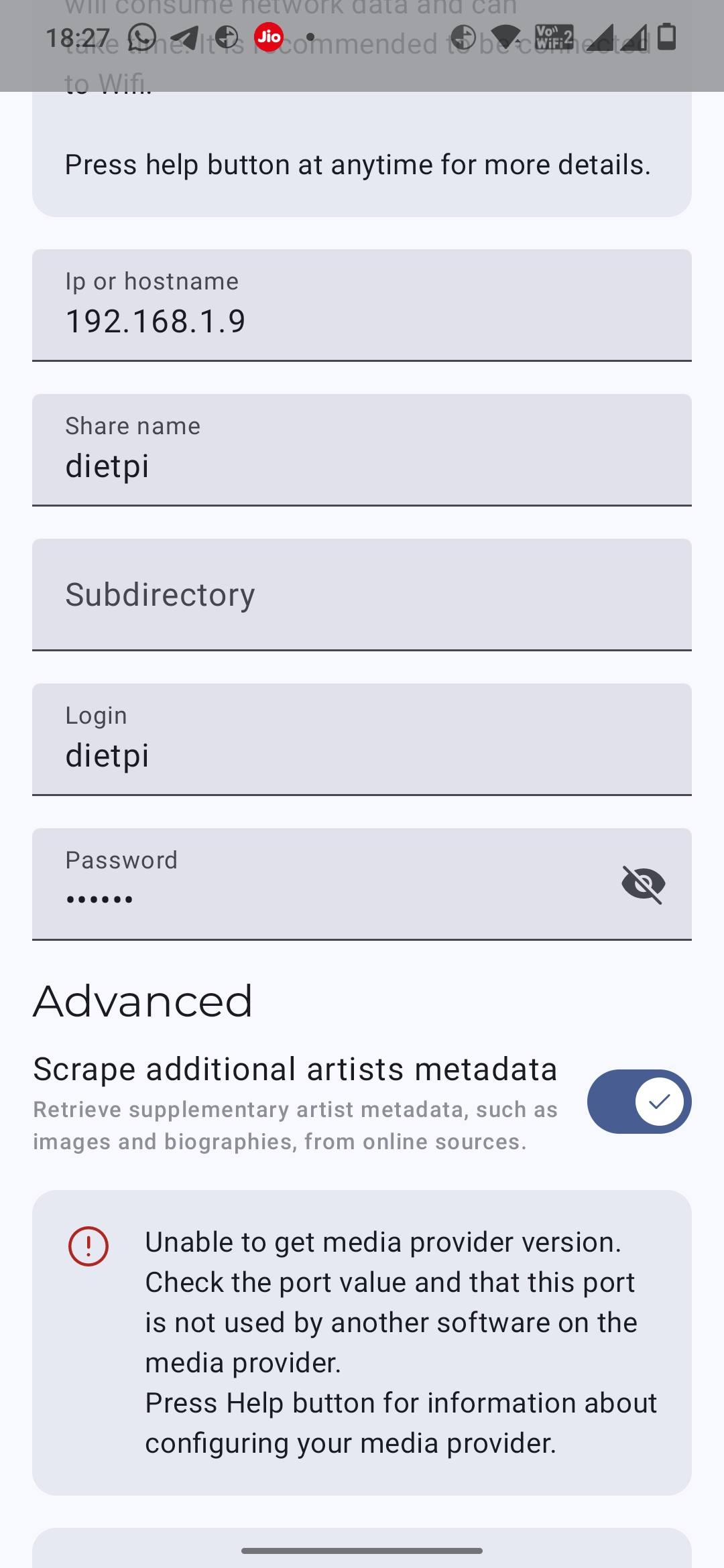

See iam attaching the screen shot for the error shwon on Navidrome as well as while adding smbshare folder on dietpi, which work fine in windows.
Please advise what could be the mistake iam doing
Don’t mix everything and there’s a dozen logs with your name and not the description you put here and none related to Navidrome …
For SMB since it’s in the logs :slight_smile:
It seems your account is a guest account and fails for signing request.
Cannot require message signing when authenticating with a guest account
Check your SMB server configuration.

But native navidrome direct access is just http://IP:4533

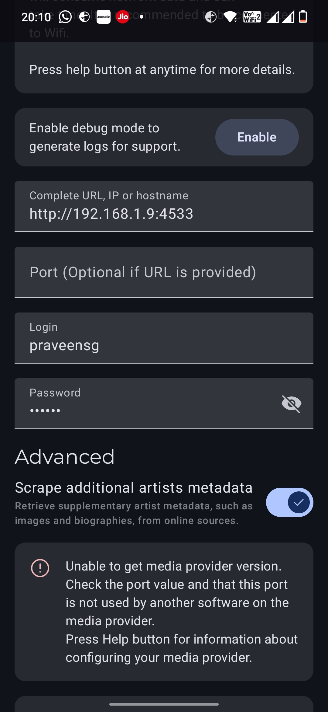

Still same error on navidrome.
Kindly help me.
… Provide logs for that test too ???
But as said I can’t know your network configuration, so I can’t help more without you providing the logs and the details about your network and setup …

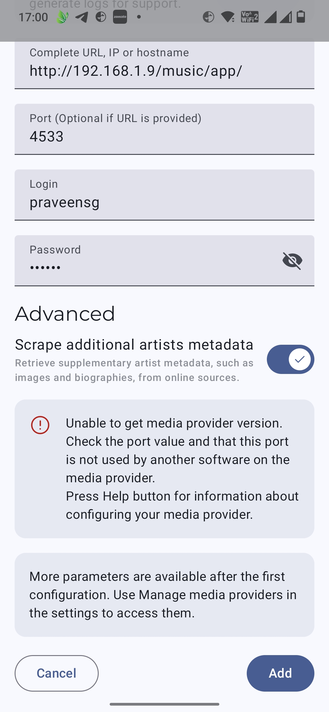

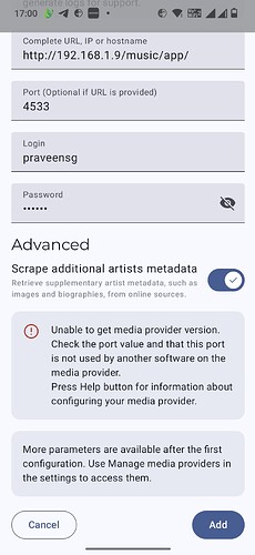

Please check again i have uplaoded log to support.from mobile. Cannot go to advanced settings . same user name have given praveensg

2024-06-27 06:54:07.138 Verbose/TestURL: → [848] GET https://192.68.1.9:4533/rest/ping.view?u=REDACTED&p=REDACTED&v=1.13.1&c=Symfonium
2024-06-27 06:54:07.145 Verbose/TestURL: → [848] connection: close
2024-06-27 06:54:07.148 Verbose/TestURL: → [848] Authorization: BasicREDACTED
2024-06-27 06:54:12.152 Verbose/TestURL: ← [848] HTTP FAILED: java.net.SocketTimeoutException: failed to connect to /192.68.1.9 (port 4533) from /192.168.1.16 (port 43630) after 5000ms
2024-06-27 06:54:12.154 Error/SubsonicAdd: IOException

And spamming the forum of course :slight_smile:
Nothing answers on that ip and port… When you will be able to open Navidrome on your phone browser enter the same data in Symfonium…
