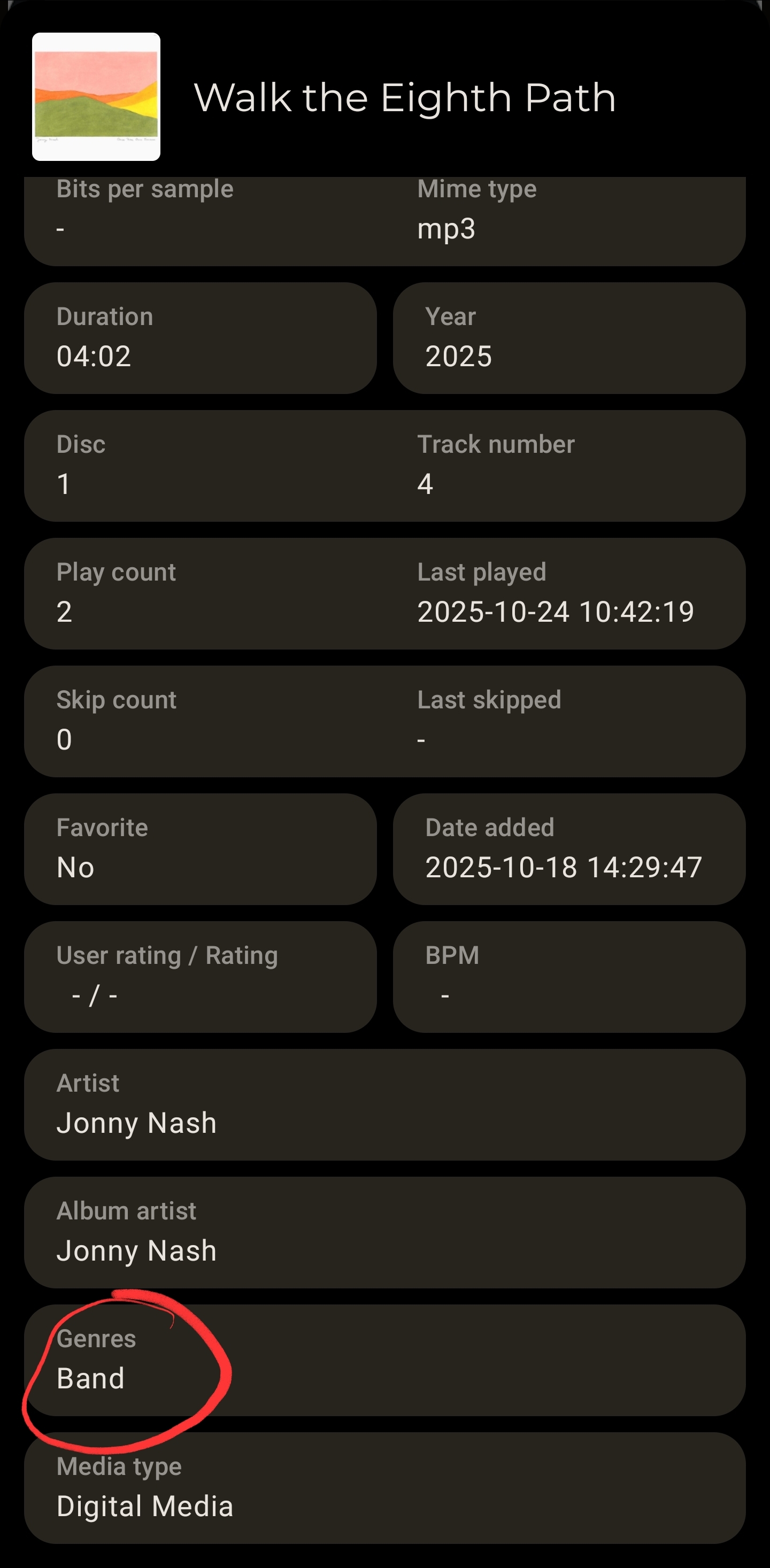

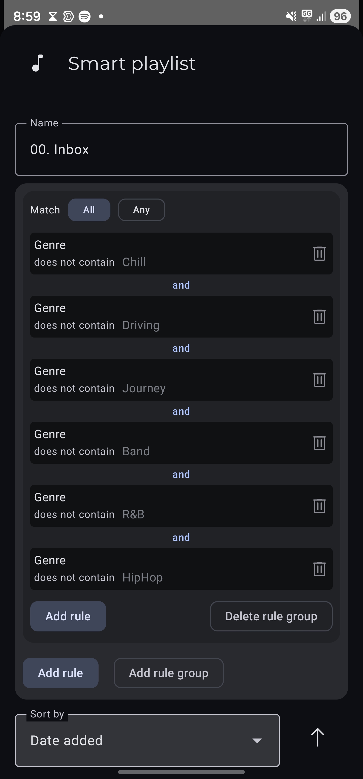

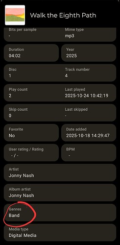

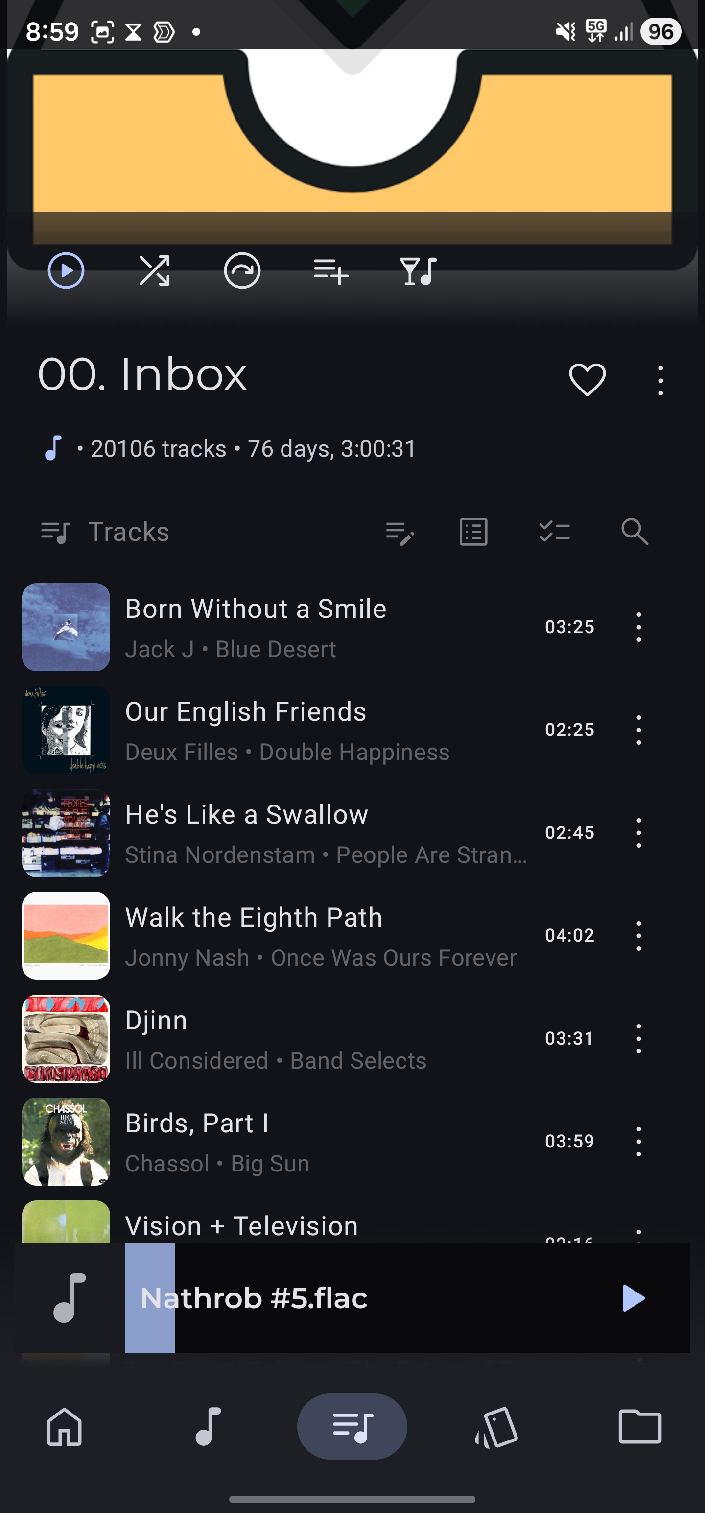

Seems like Smart playlists ignoring my “does not contain” rules for genres as per attached, tracks with these genres are still showing up. Library has been rescanned.

Thanks, some missing (), will be fixed in next release. You can probably workaround by putting each genre check in a different rule group.
