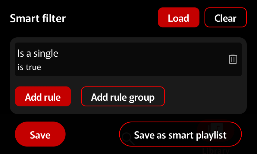

When selecting the Smart Filter “is a single - true”, the app returns no results.
I have many tracks tagged with Release Type “single”.
How does this Smart Filter check if a track is a single? Thanks for the info!
  • have tracks tagged as “single” release type
  • go to Tracks screen
  • Smart Filter, add rule: “is a single”, set to “true”
Yes, I know I can use the album Type filter. The track filter seems like it should do the same thing, yet I get no results.
Celorien_Single_Short only includes applying the filter; Celorien_Single_withSync includes a full scan prior to setting the filter
“Is a single” means a track without an associated album—normally one with no Album tag for local files. It doesn’t check the Release Type tag.
A track tagged with release type “single” can still belong to an album, so it won’t match this filter. Your logs confirm that the filter finds no tracks without an album. “Album Type” is the appropriate filter for the release-type metadata you’re using.
