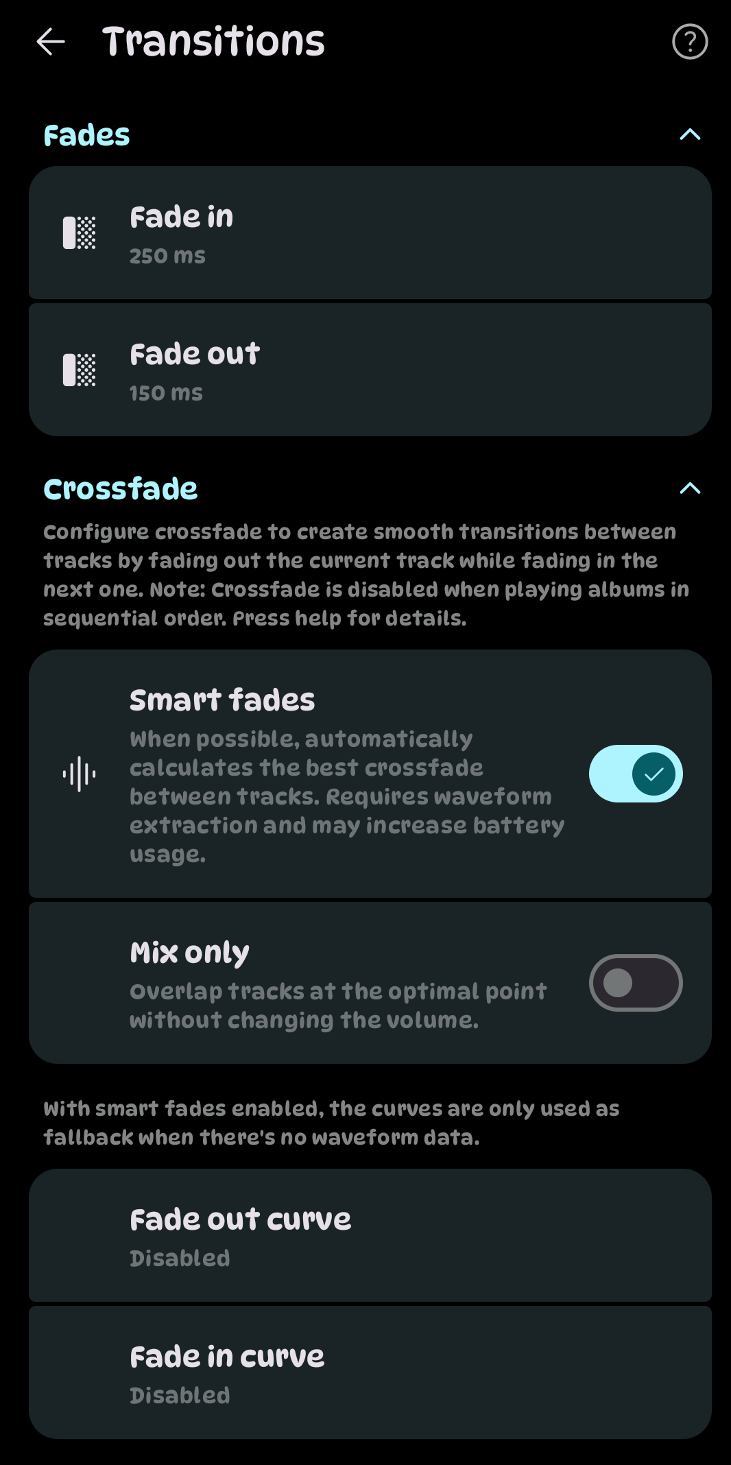

Currently on Beta 6 of 15.0.0. The smart fade feature doesn’t work. Rather than smart fading, it does a hard cut between the previous song playing and the next in queue. Smart fade is on, mix only is off and the curves are disabled as well. These settings were the same when I used the stable version on the app store and the fades worked fine. I replayed the exact same sequence of songs as well on plexamp mobile and the ‘sweet fades’ worked fine there.

Smart fade did run in that log. Give more details about what you hear and your settings as there’s not the playback start in those.
Not sure which settings to included so here are these ones. Basically what I hear is that the current playing song cuts off where I assume it would have started to fade and the next song on just jumps in from there. I have video recording comparing the Symfonium playing to my plexamp playing and it shows it but I can’t upload videos here. I can put it on Reddit maybe if that works for you.

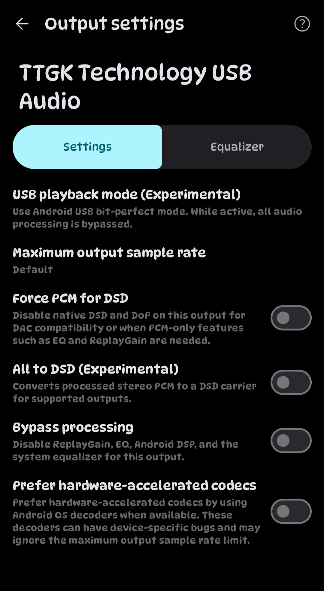

In this case you set bit perfect mode, fades are audio processing so it’s expected not to work.
The issue is still present when I set it to Android Default or USB exclusive.
Provide logs with default mode.
