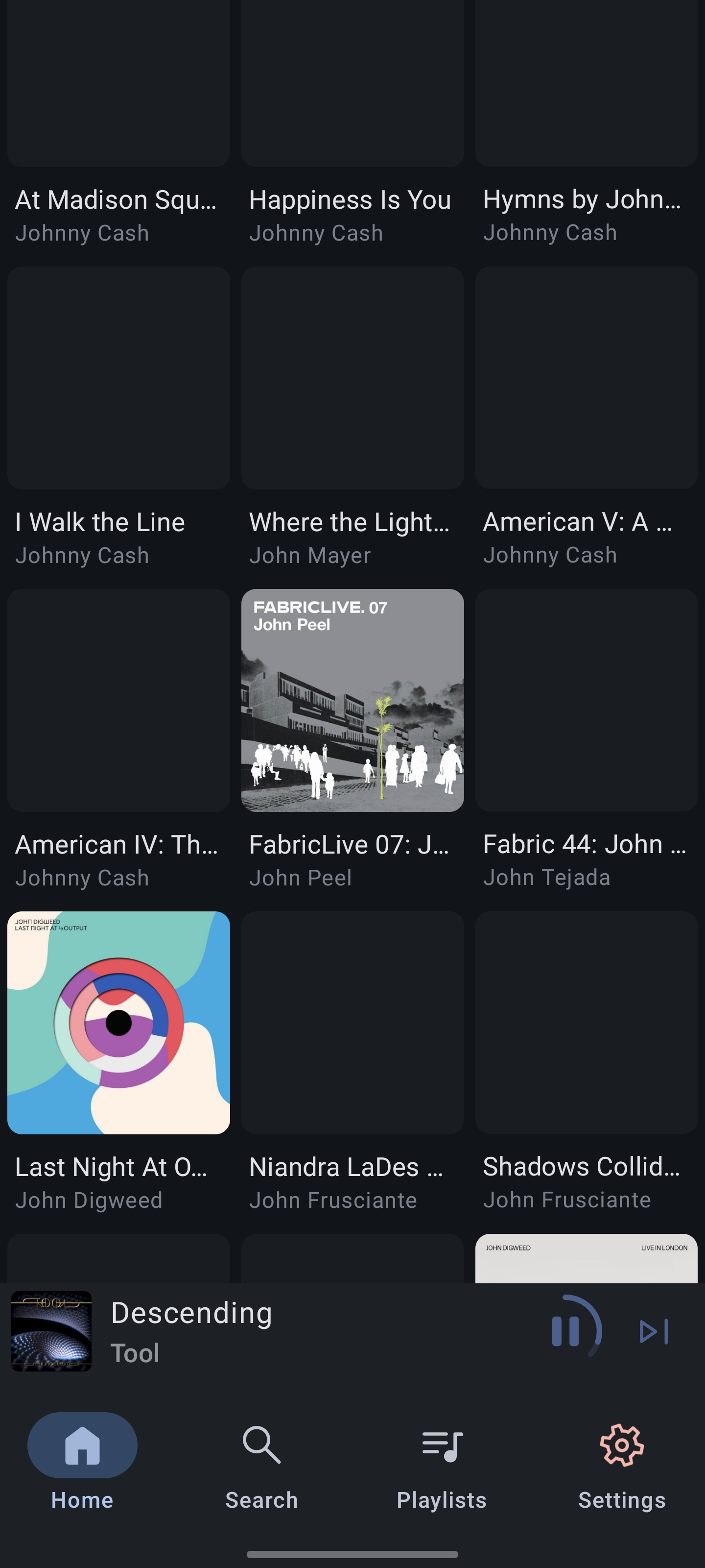

After switching to navidrome I have noticed a serious delay in artwork being shown. Eventually, it gets loaded, but, it can take several seconds sometimes, upwards of 10 to 20 I am guessing.
Previosuly, I used emby and the delay was barely noticeable Nothing else has change with my setup. I do connec to my server via my own vpn.
Maybe you can spot something in the logs.
Thank you and apologies for 2 issue reports in 2 days. :folded_hands:
Upload description: Maxe1210
I can upload screenshot after I post this.
Load a page with lots of artwork, album, artist etc. Some artwork takes really long to load.
