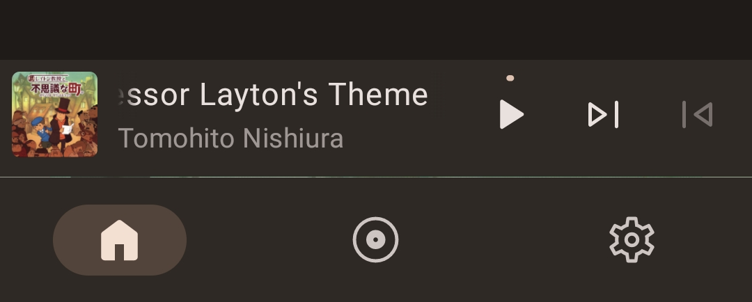

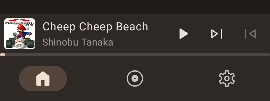

Running Symfonium on Android; whenever I play a song, a sliver of the artwork is displayed below the control bar. I’ve attached screenshots of this below, and tested it with multiple settings, including toggling the progress bar.

I wasn’t 100% sure how to “replicate” this, since it is just there, but I opened and closed the “Now Playing” drawer a couple of times. I also toggled off/on the “Round progress indicator”.

Additionally, here is a screenshot of the “Round progress indicator” enabled, with the sliver still visible.
