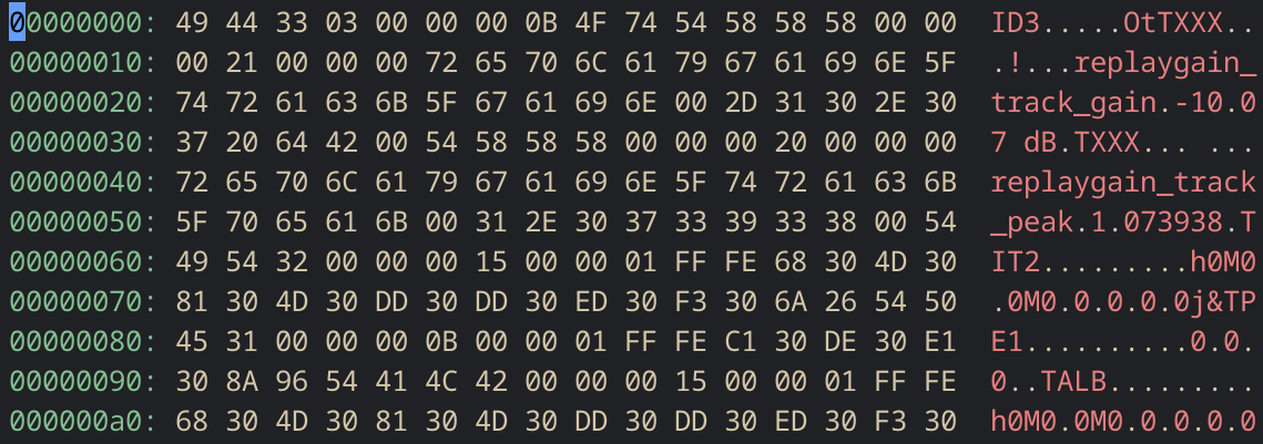

I found out that when I turned on track replay gain, only some of my songs got replay gain, and some didn’t. But on the server side (navidrome) all those files show replay gain info, and from id3tag all the source files include replaygain_track_gain and replaygain_track_peak.
Digging further it seems that some of my files have the replaygain_track_gain tag encoded in ASCII which replaygain works (frame type $00 in id3 spec), and some of my files have it encoded in UTF-16 with BOM which replaygain doesn’t work (frame type $01 in id3 spec)

Screenshot 1 is the file header for one song that replaygain failed (and has UTF16 with BOM “01FFFE” frame type)
Screenshot 2 is the file header for one song that replaygain works (and has ASCII frame type)

2024-01-06 04:41:31.726 Verbose/ExoPlayer:     TXXX: description=replaygain_track_gain: values=[ⴀ㤀⸀㐀㘀 搀䈀]
2024-01-06 04:41:31.727 Verbose/ExoPlayer:     TXXX: description=replaygain_track_peak: values=[㄀⸀㄀㄀㄀㐀 㐀]
Uploaded the two mp3 (good.mp3 bad.mp3) via https://upload.symfonium.app/
The uploaded description contains https://support.symfonium.app/t/replaygain-id3-tag-encoded-in-utf-16-bom-is-not-recognized/4061.
So the tags are invalid don’t know how you filled them.
VLC and FFmpeg also fails to read them:
Incorrect BOM value
Error reading frame replaygain_track_gain, skipped
Incorrect BOM value
Error reading frame replaygain_track_peak, skipped
I can add a workaround but you definitively need to fix them.

I tried to find where the broken tags originate from, but I cannot reproduce how those tags are written now. I assumed it’s some old ruby library that I used but rerunning them doesn’t seem to produce the broken tag, so maybe some old music player that I no longer use now?
Looking through more files I had before I fix them, some of them are missing BOM in value part of TXXX:replaygain_track_gain, and some are using UTF16-BE for the value part but still using BOM FFFE… So it was really a mess and I still have no idea where that came from…
Interesting enough that mp3tag on Windows / id3info / foobar / navidrome all reads them correctly, so I guess they also have seen many non-spec-compliance tags in the wild and have heuristic for those :rofl:
