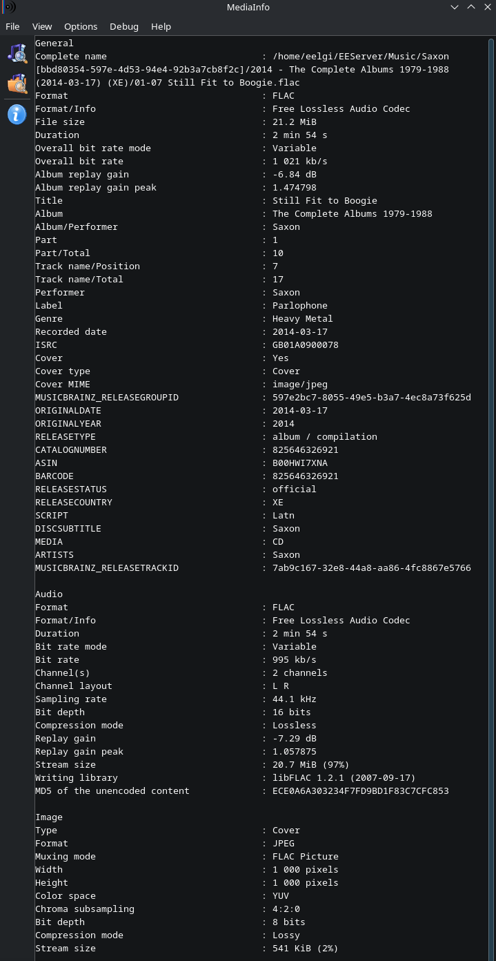

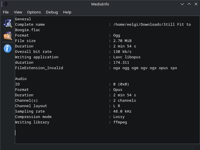

I believe this issue may be caused by how Plex transcodes the audio files. Using Symfonium’s offline download feature, I was able to download the transcoded file. The resulting file ended in .flac, although was still encoded in ogg as expected. However, the replaygain values that were in the original file were missing. I have attached screenshots of the mediainfo of both the original and the transcoded file respectively.

Yes plex transcoding removes the tags and so Symfonium no more have the data.
Thanks for the information. Guess I’ll switch to LMS as my media provider as I know it retains the tags while transcoding.
