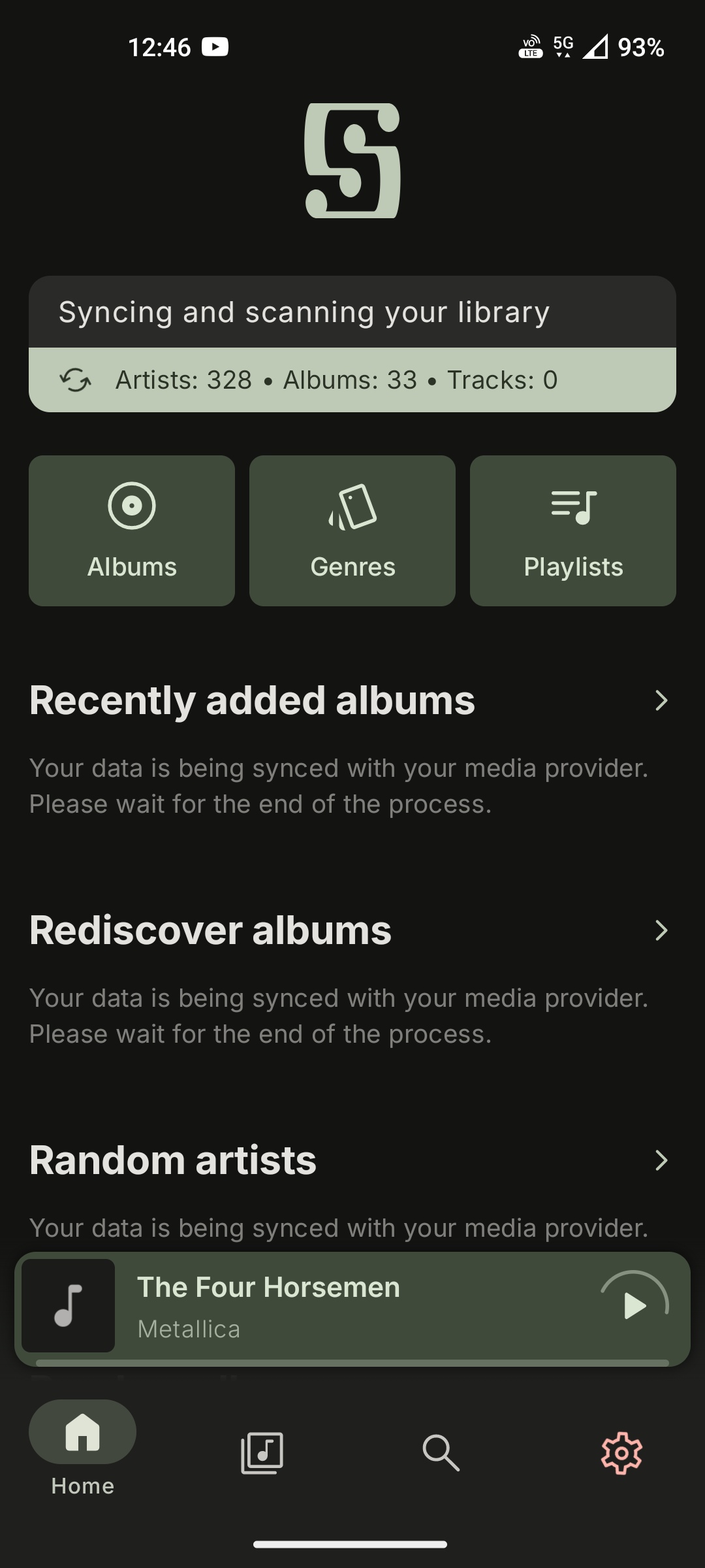

Hi, I’ve spent the last few days setting up remote access for my Jellyfin server.
I’ve been testing it using Fladder and the android JF client and is seems to run fine, I manage to have media play smoothly and all.

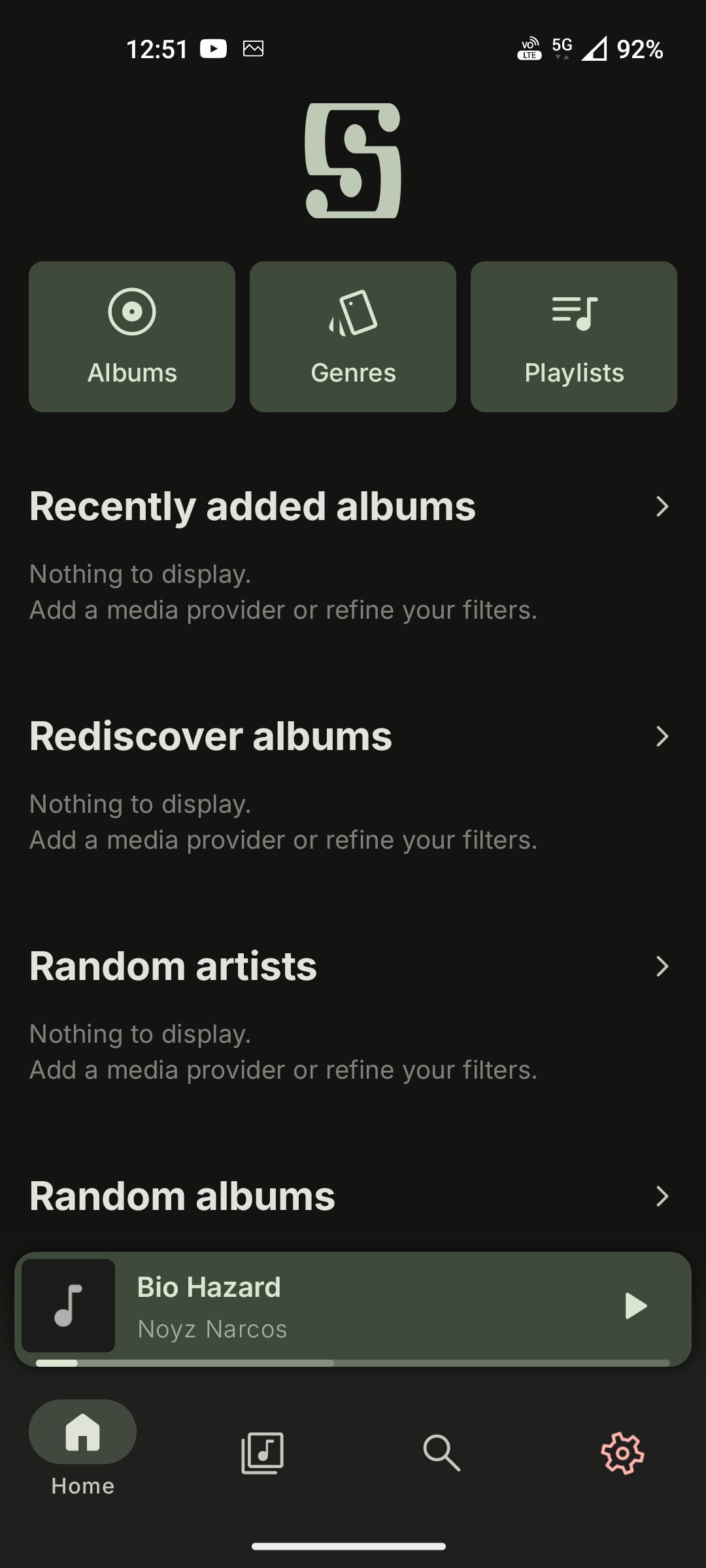

I’ve already tried reinstalling the app/ clearing cache and data but with no luck, every time I try to remotely sync my library it manages to complete the scan and then goes back empty.

Have you double checked that you are not hiding the media provider by accident?
You have a filter on available offline enabled :slight_smile:
But since you removed all the possible ways to see the filters you don’t see it (Well the message in the middle kinda help).
Please enable back the filters either in home or as top button in interface/Advanced then fix them.
Thank you so much for the quick reply, yeah I guess I must have set some filter I forgot about.
Everything works flawlessly now, also thanks for the project you created, after trying out so many I believe this is currently the best music player for android.
