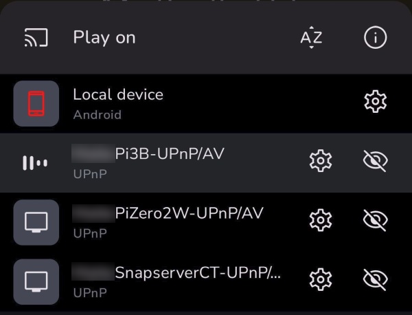

That’s 2 pis + the debian container as cast targets in Symfonium:

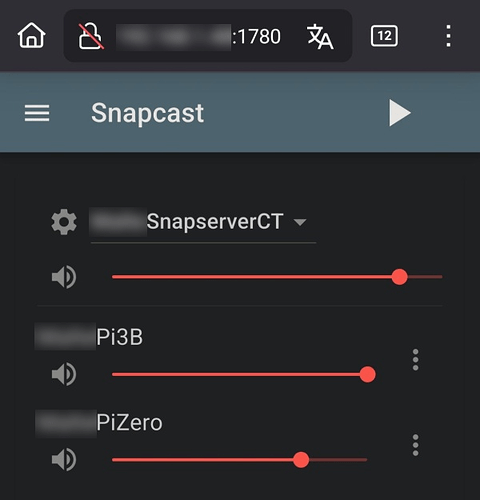

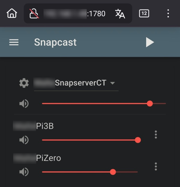

Volume can be controlled individually or per group via the shipped webserver on port 1780 of the server IP or via one of the supported apps (snapdroid etc).

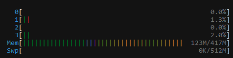

This is the system load when casting 44.1/16 to a Pi Zero 2W:

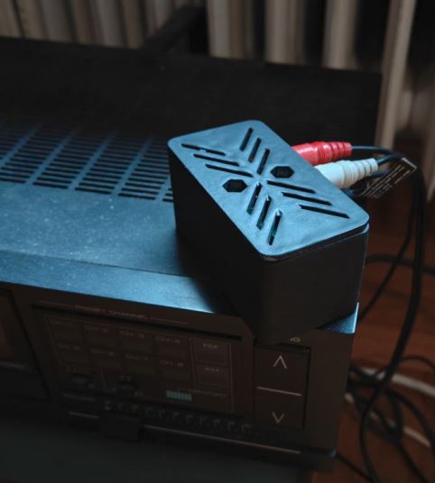

@655321 How are you connecting your multiple pi’s to the speakers if not with the 3.5mm jack?
Each pi is connected to an amplifier via cinch through a Hifiberry DAC, which in turn powers 2 speakers each.
Like this:
In this case that’s a 40 year old amplifier (Kenwood KR-A20).
