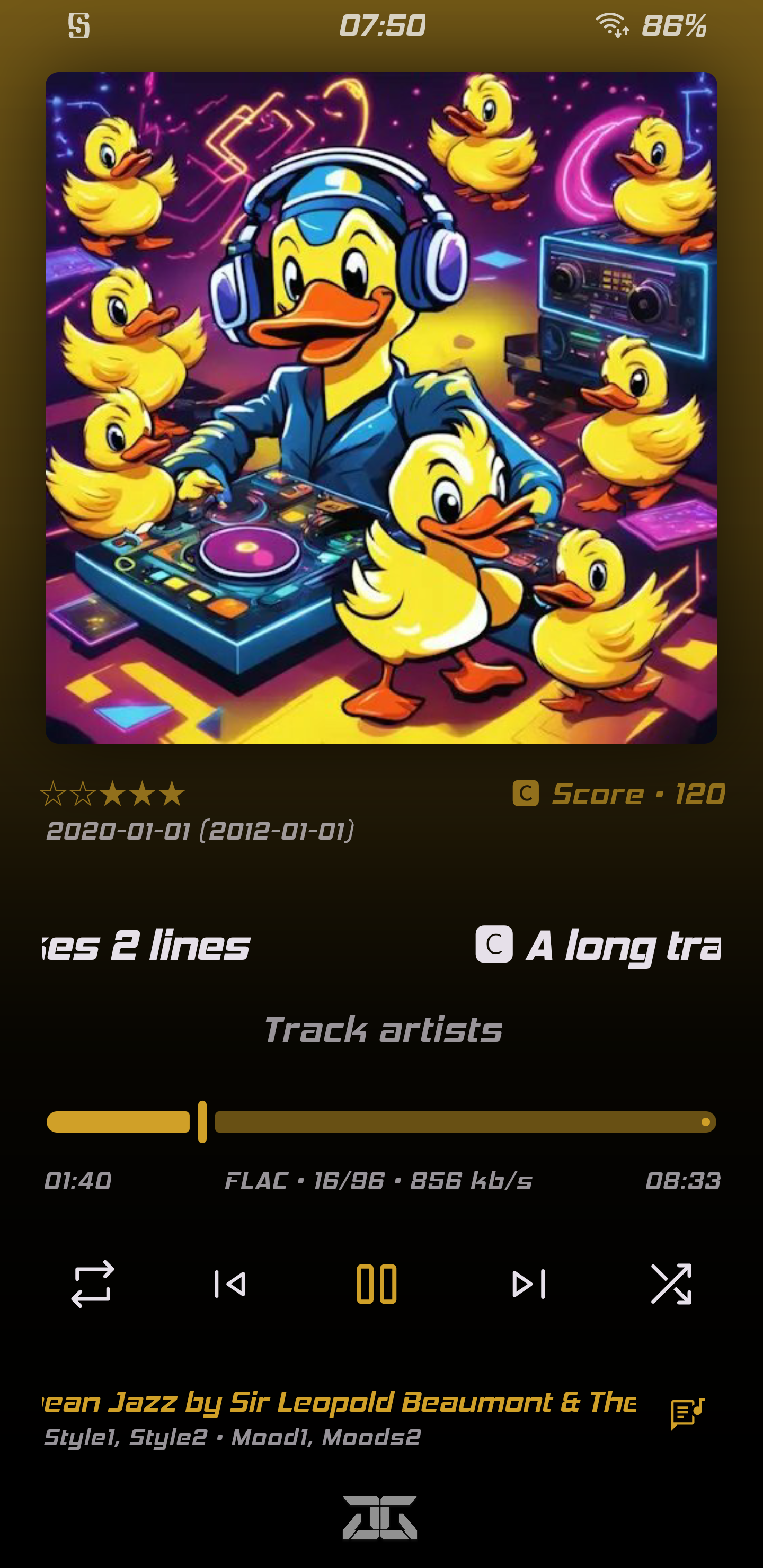

Here’s my Plexamp Improved Screen
https://imgur.com/a/leNEEoM
Ah, I see. Well technically what you want is possible, but not by using the rating bar element itself.
THIS is my NPS
I’m using some custom string templates to display special characters (stars) so that I could display my ratings in a different way. The CON here is you can’t directly interact with the rating tag from these characters. But this could give you the aesthetic you were looking for.
I don’t set my ratings in symfonium so the pros outweighed the cons in my case.

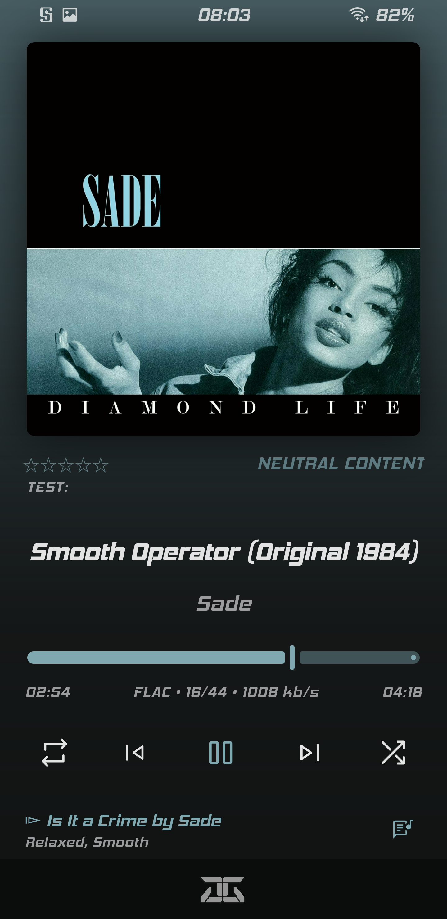

Circling back to this as I thought you had figured it out but please do me a favor & test a
few simple strings on your end & let me know your results P/F
TEST 1
{%releasedate%} {(%originaldate%)}
TEST 2
%originaldate%
TEST 3
%releasedate%
In my case My preview screen is showing me what I expect by my NPS never does.
In other words all 3 of these tests failed on my end.
This leads me to believe I have a tag issue but I’m not totally sure yet.

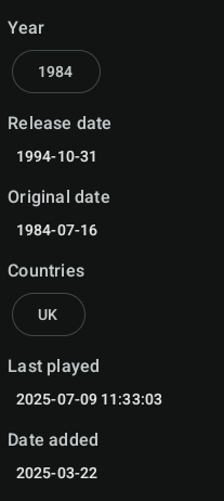

This is how my files are tagged in MP3TAG & how they appear in symfonium
