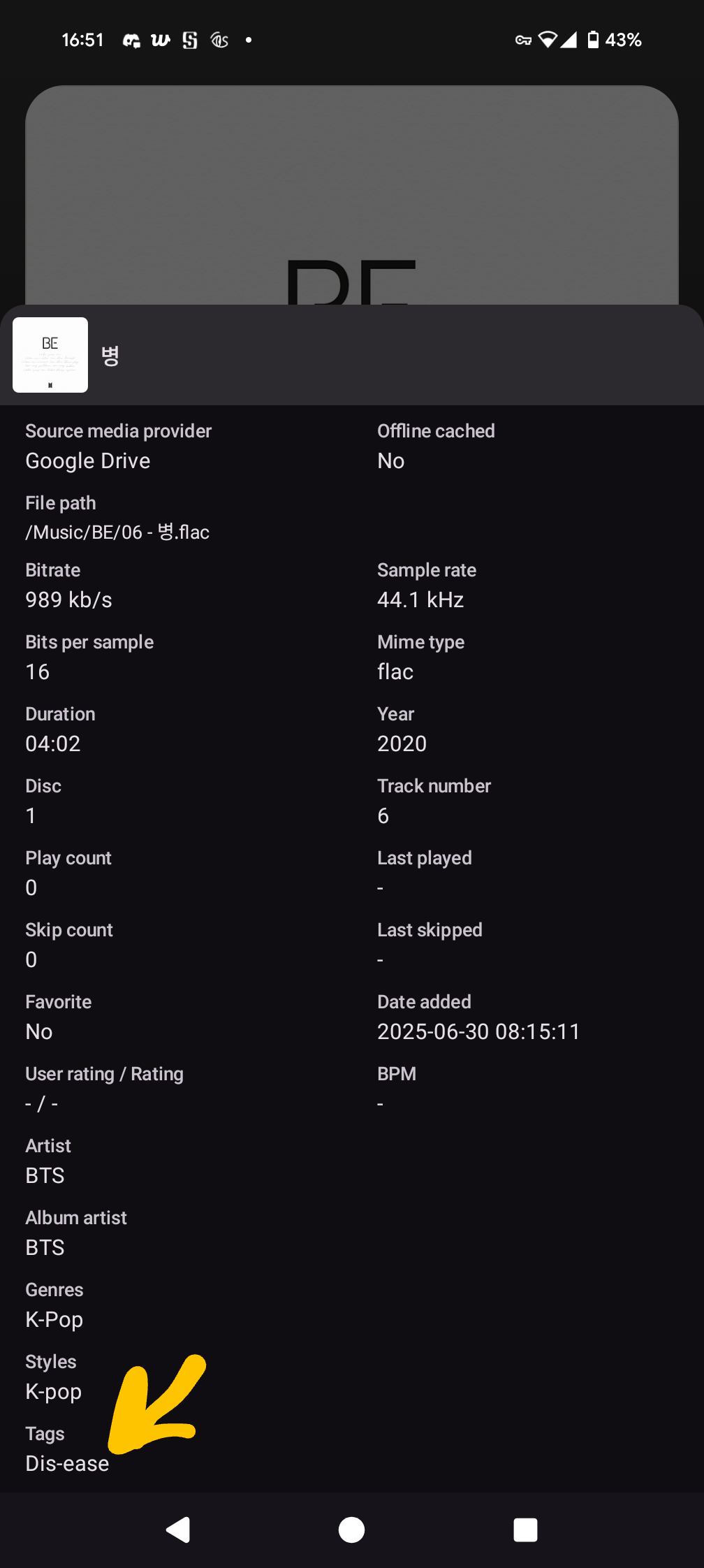

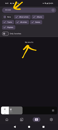

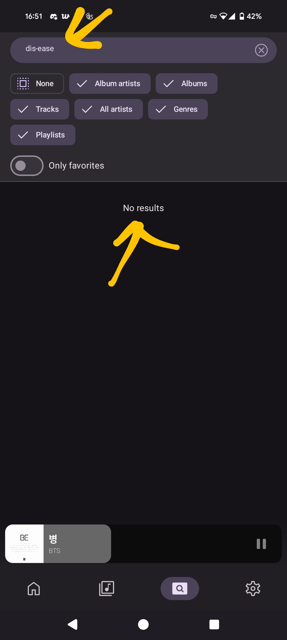

Upload description: windyknot14 2025-06-30
I attached a screenshot of an example track that has “Dis-ease” in the TRACK_TAGS field, and the interface when i try to search by that.

You can’t search them from the main search bar but there’s an entire view of the app dedicated to Track Tags specially.
With the filter bar enabled on that page you can quickly navigate to tracks with any given Track Tag.
You can add the track tags view to your library page or quick navigation (tabs / pages) whichever suits you best
