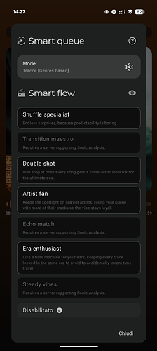

Hi, which kind of Smart Flow could you enable?
I have your same setup (Jellyfin + Audiomuse + plugin + Symfonium), but all the Sonic Analysis related options in Smart Flow are grayed out.
How do you use Audiomuse functionalities once everything is set up?
At first they were greyed out but then all of the options became available once my audiomuse analysis completed. Also make sure the Jellyfin plugin settings are pointing to your audiomuse container..
Did you analyse your library from the Audiomuse UI? Also did you configure the app in jellyfin with the IP or hostname and confirm that Jellyfin is connecting to audiomuse?
I confirm that I only had to wait for the analysis to finish, as esvee suggested above. It took many hours as the library is huge, but once it finished, the smart flow options were greyed out no more.
This is normal. My analysis took 3 days :smiley:

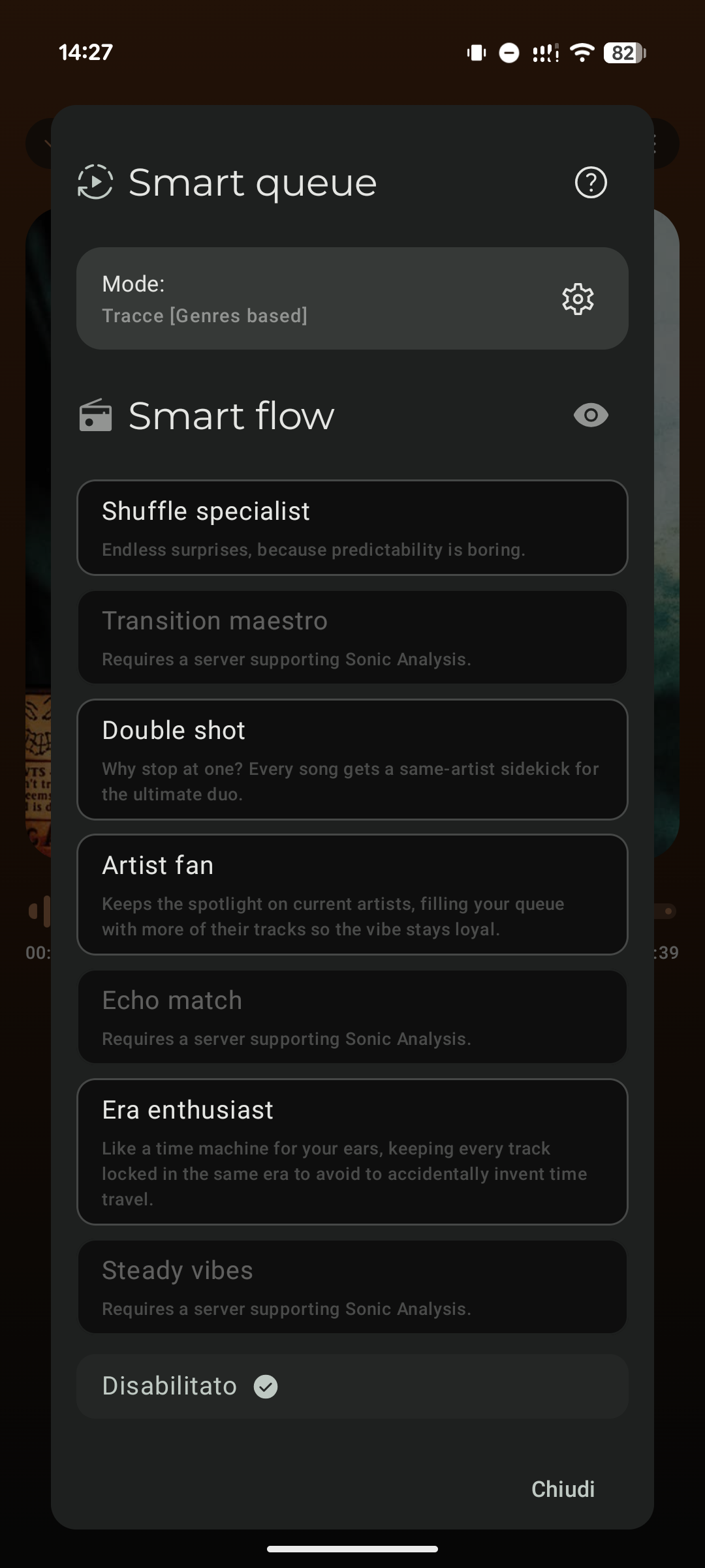

I’ve just opened the app and the smart flow buttons are greyed out again.
So I did a manual sonic analysis after adding two more tracks to my library, but the buttons stayed greyed out even after it was completed.
Nothing seems to be logged by audiomuse nor jellyfin, also when using the instant radio mix feature.
The only feature that still works and logs something on audiomuse is the sonic analysis based smart queue.
Any idea?
Force stopped Symfonium and cleared its cache. Now they are clickable again. Wonder why it happened though.
