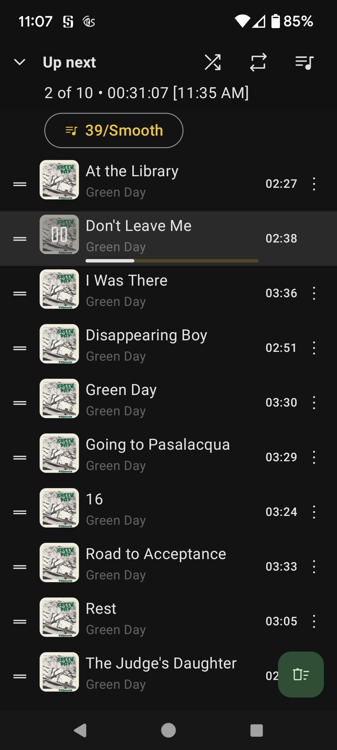

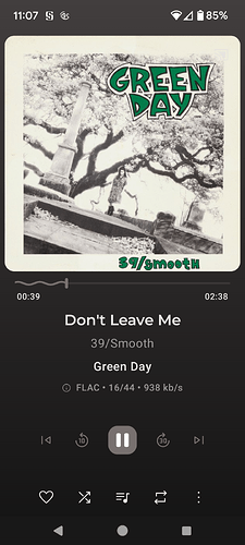

I did the reboot, went straight to the app, turned on debug, connected to UPnP speaker, went to an artist and selected play on one of their albums.
Upon playing the first song I scrolled to the end leaving a few seconds. Failed to skip to the next song but repeated.
